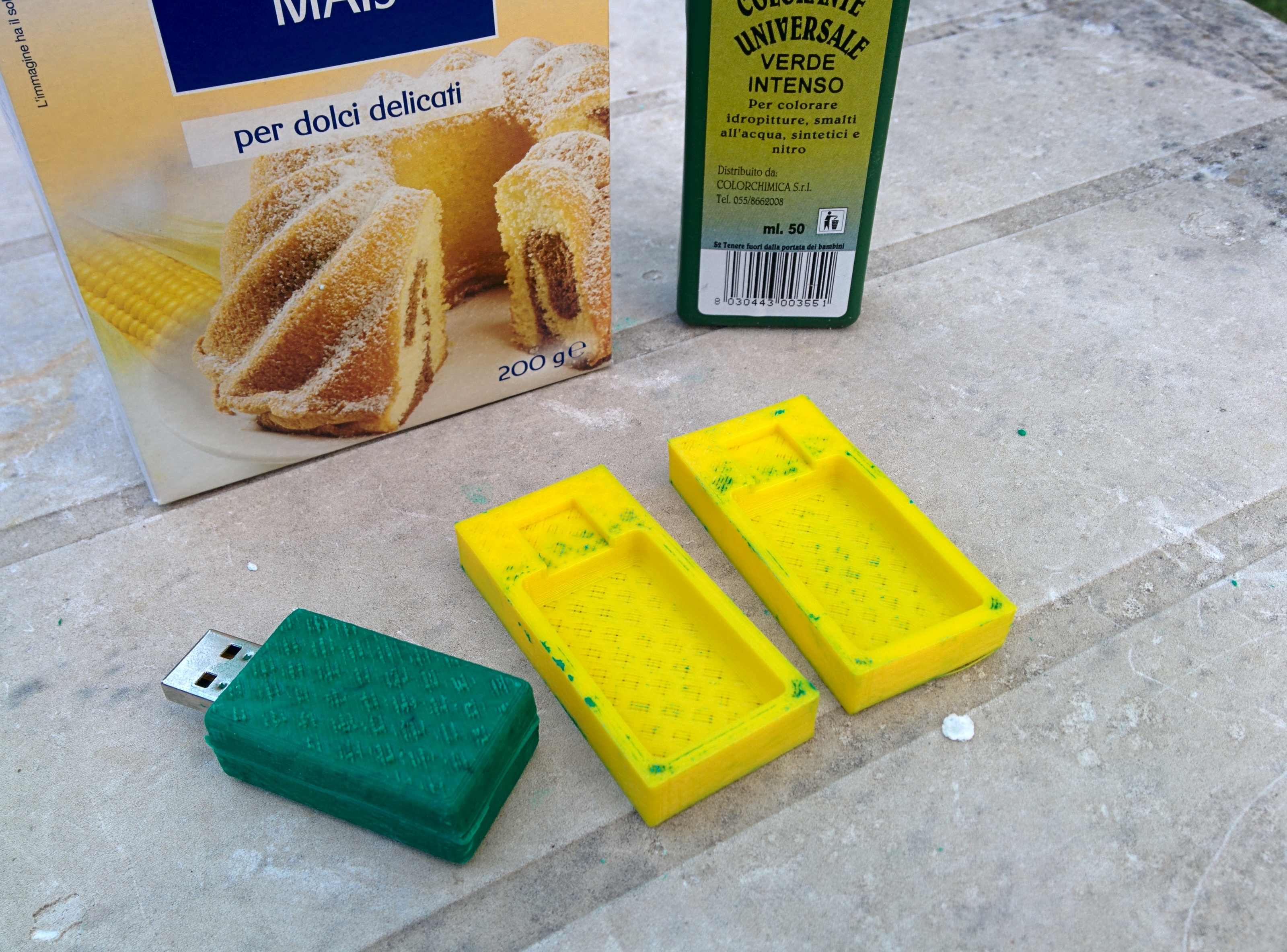

You can print a mold with your 3d printer and then use silicone rubber
You can print a mold with your 3d printer and then use silicone rubber to build your very custom USB flash drive case…

It is corn starch, used to prepare rubber mixing it with silicone. Search for “oogoo”.

@enhydra it’s not a secret: just search “oogoo”. It’s a mix of corn starch and silicone that I pressed with fingers inside the mold you see in photo :slight_smile:

@yaron_atia I used oogoo recipe: 50% silicone and 50% corn starch. What’s your recipe?
I use molds silicone , two components are mixed together and after two hours its Harden
