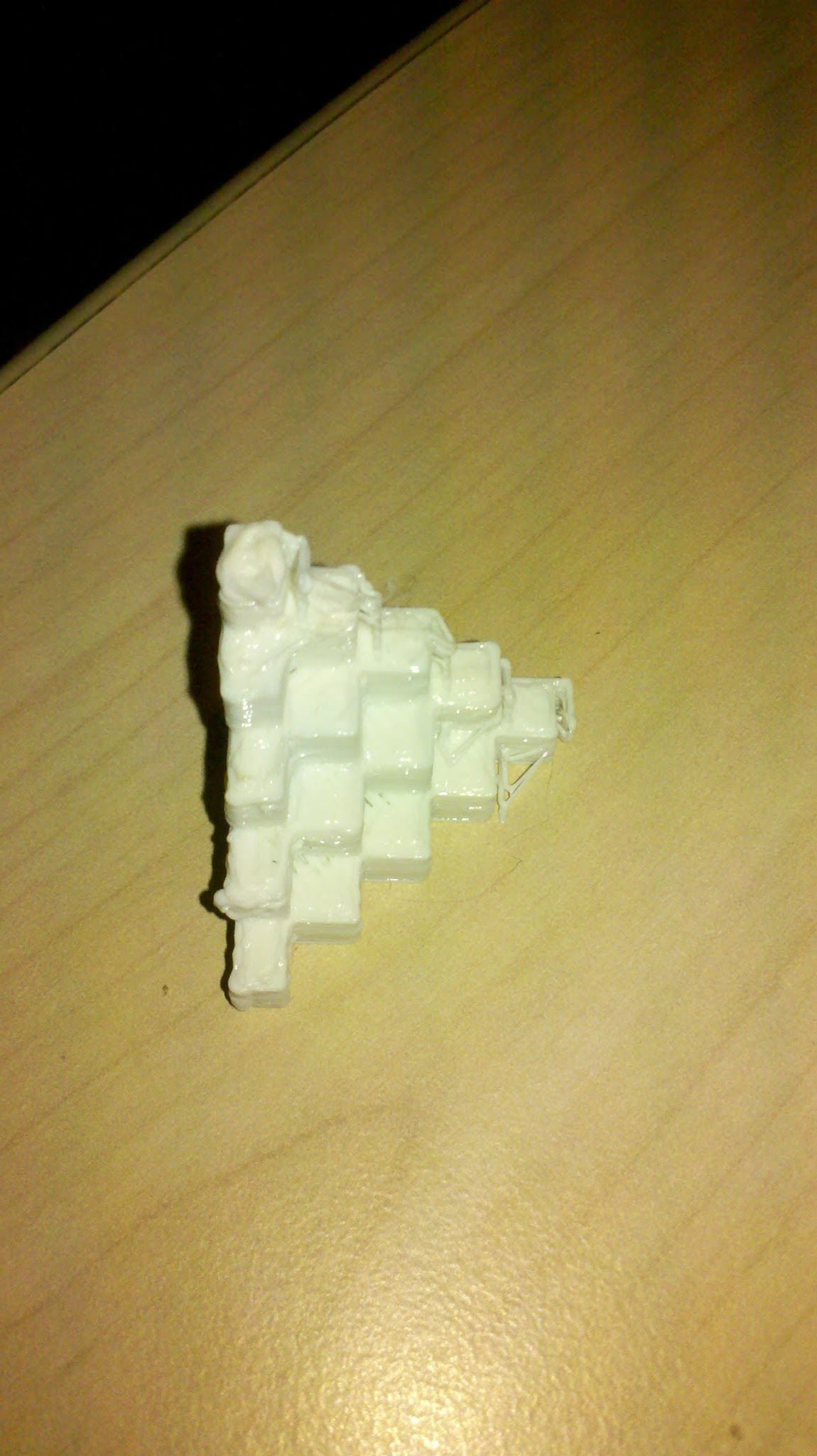

You can see on the rightest square a edge not wanted. Print with skeinforge.
Any idea to remove it?
I checked stepper voltage and all is right. X stepper was 0.41V but now it’s .401V.
Z axis and Y axis are respectively 0.398 and 0.402v.
I checked also Y and X belts. Don’ t know where to look in settings to make thing better.

Print is better but it still lefts some artefacts on the right of each square
Looks a little warm. Have you tried point a fan at it while it prints?
Axon2 instead of SF?
Abs?
Wow looks like u printed w/ butter
@John_Cooper_choffee , I setup 195°C for the print. I was printing the bracket for a fan in the same plate.
@Anthony_Truss , axon2 ?? It’s PLA.
Did the fan make a difference. I just tried hold the fan near mine yesterday and for small objects it makes a huge difference. You might want to try slightly lower temperatures. I think I am at 190 at the moment but have got good results with 185 as well just could not get it to stick to the bed.
