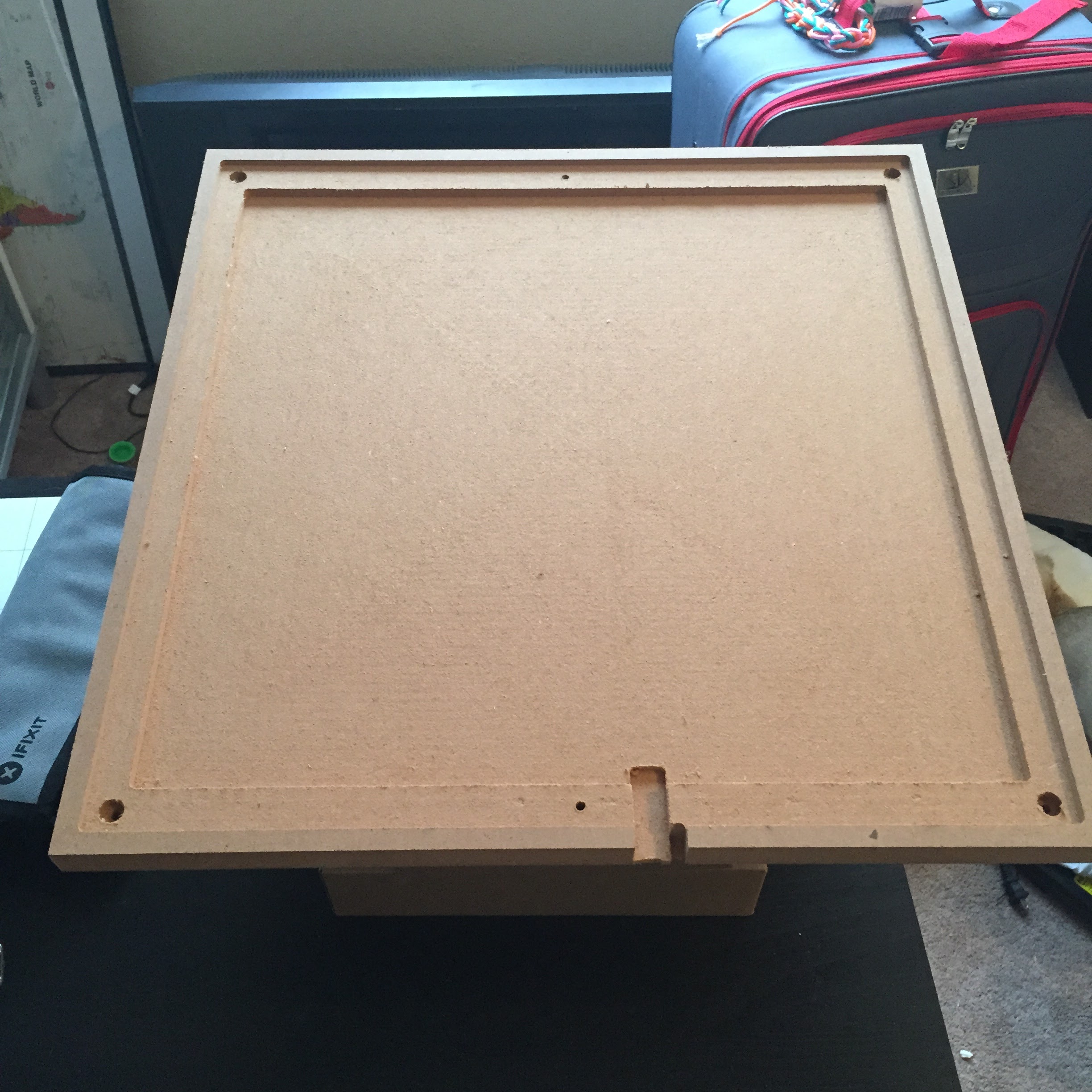

You don’t realize how big the herculien build surface is until you hold it…
Looks like you got someone to CNC it for you? Looks great. I did mine by hand with a bunch of router passes and straight edges. What a mess that was.
FYI if you paint it like I did make sure to prime it first with a sealer primer. I took a shortcut and didn’t prime it. That stuff sucks up paint like a sponge if you don’t seal it.

Something tells me an Ox could do this in it’s sleep.
Looks really good ! And what a big area
Ya I had it CNCed by a local shop along with my acrylic cut. I just sprayed a black ename on it but didn’t seal it =/
Please note the offset pigtail. I don’t know if I ever let people know to order this way from alirubber. That way the pigtail avoids the screw at the back holding the aluminum to the MDF.
you have to request that?
Yes. Otherwise it comes straight out the back.
Well I hope I can edit my alirunber order
Sorry. I asked them If I could make a PN for reference. But they never got back to me so I forgot.
Otherwise you will likely be able to sneak the pigtail over there without issue. Might just need a tiny bit of material removal at the corner of the low pocket.

@Eclsnowman do the thermistors go through the pad or are they just adhered to the underside of the pad?
@Derek_Schuetz can you get your contact to CNC more of those mdf boards? If so, I’d be interested in outsourcing it to him.
Sadly I don’t own a CNC machine nor a router so I’m looking at doing this by hand and I don’t want to do that.
@Daniel_Salinas it was a royal mess when I did it by hand.
