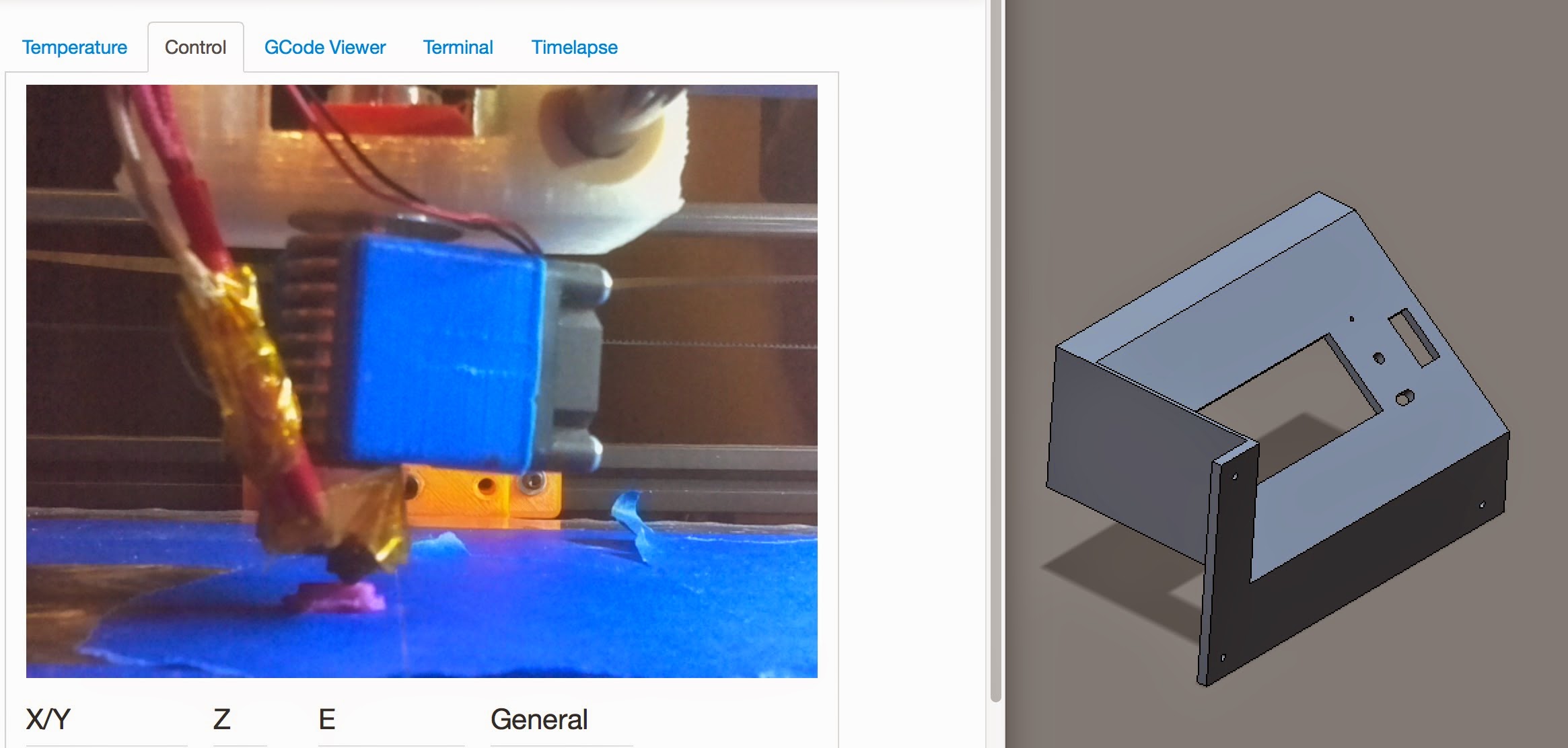

  1. The printer is in the office, running #Octoprint
  2. It’s printing ABS on a heated bed
  3. The office is small enough that IT is my heated build chamber. :slight_smile:
  4. While it’s printing the Stop Job button, I’m designing the Control panel for the printer, thanks to your help (Offset Plane + Axis from two planes + extrude from sketch got me past my gap in knowledge)
Thanks to you I’m now making bespoke parts at will, and ruminating on things like ‘From a user interface design, where do I want to place the reset button, so that the user doesn’t accidentally kill a print in progress.’
Thanks a lot, guys! Just more stuff for my ADHD mind to work on! :smiley:
Wow, that E3D is crazy tilted, you should fix that.
Naw man, at the important part, it can be handwaved away as a point source. :slight_smile:
(it’s the clip that holds it to the carriage that’s up for a redesign…one five things at a time, man!)

A tilted extruder will certainly cause issues with bigger prints and small supports. I’d be surprised if you could run pillar supports at all for example.
I think you guys are blowing the extruder tilt thing waaaay out of proportion.
Well, consider this. Your goal should be to reflect your machine to your gcode rendering as close as possible, otherwise you get more variables the farther you get into it. A lot of software assumes you are extruding straight down unless you start going crazy with 5+ axis control.
I have printed with accidentally tilted heads before. They tend to scrape up or break prints, then eventually knock the print head out of alignment in one axis mid-print. We’re just trying to save you from some major frustration in the future to know this now. Even with an overly rigid machine (which is not always a good thing anyway), it’s just not the ideal.
