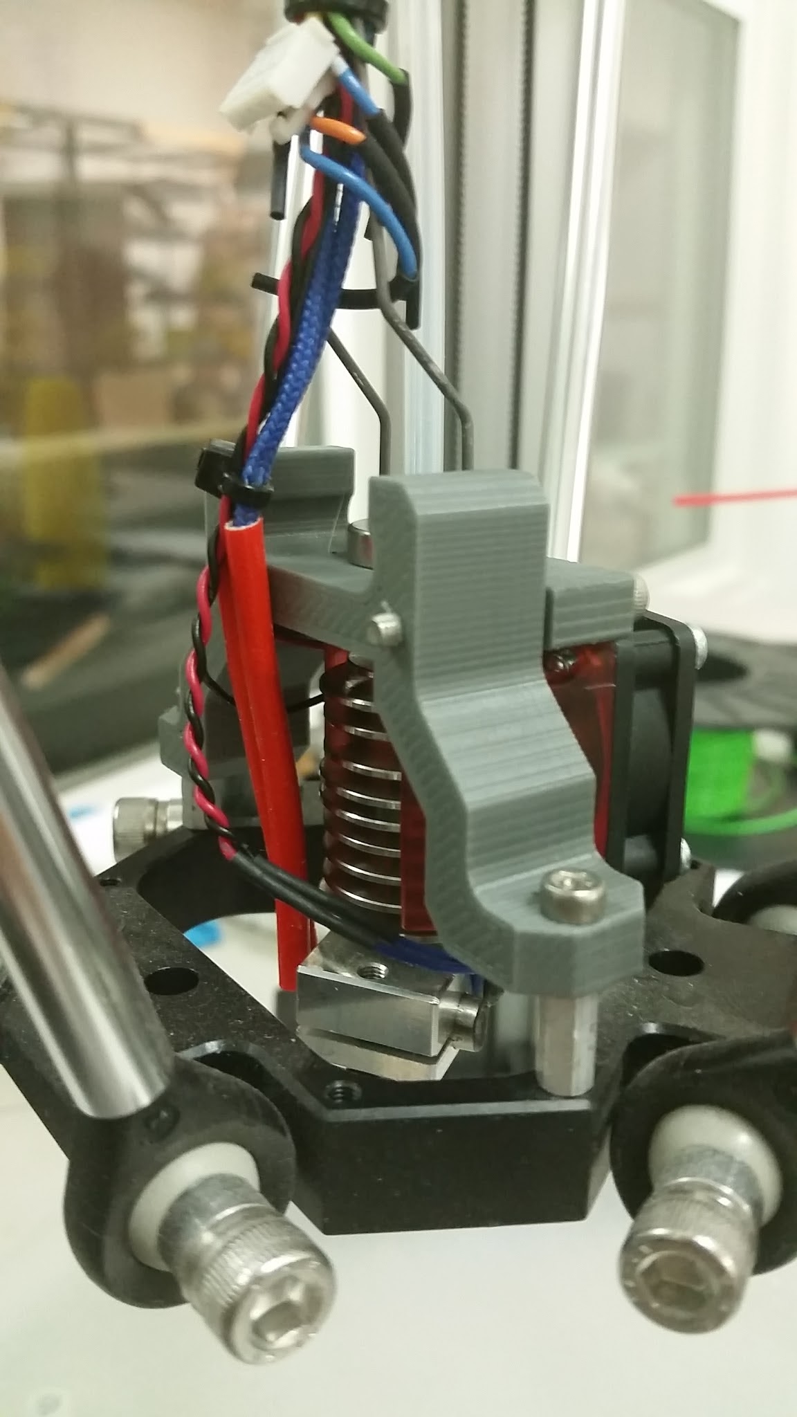

You know, we’ve had the E3D Lite6 in our hands since like a week before their release. We’re only just now getting around to mounting them on the DeltaMaker. I initially thought we couldn’t do it because our firmware would just stop if it didn’t detect a touch probe, but realized later that we could just auto bed map with a regular hot end, and swap out with the E3D after and maintain the bed map…oversight on my part.
But we’ve got at least one machine printing with a Lite6 now. :slight_smile:
whatcha think? Hows it doing?
Brilliantly so far. Better top infill quality than the nozzles we are using currently. Trying to integrate some auto bed mapping stuff into a mount, so that we can move forward on hot ends.
