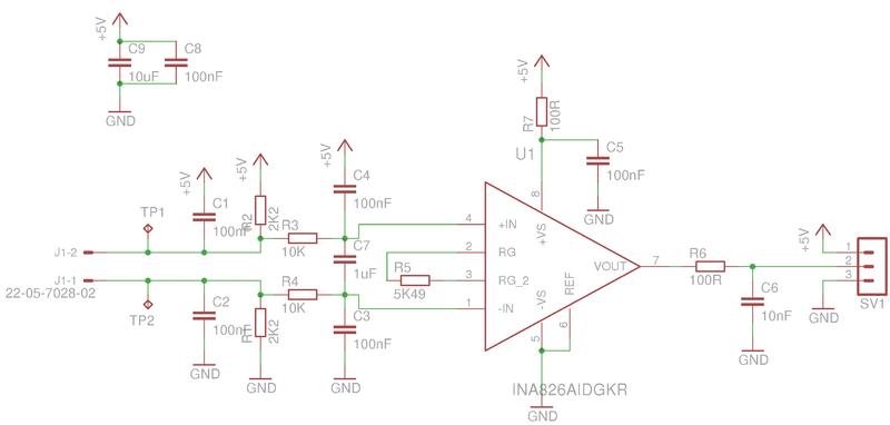

On the topic of noise: The @E3D_Support PT100 board has pretty brutal hardware low-pass filters in the input circuit, so I’d think noise of any reasonable level would not be an issue.
(Image from https://wiki.e3d-online.com/wiki/E3D_PT100_Amplifier_Documentation )
