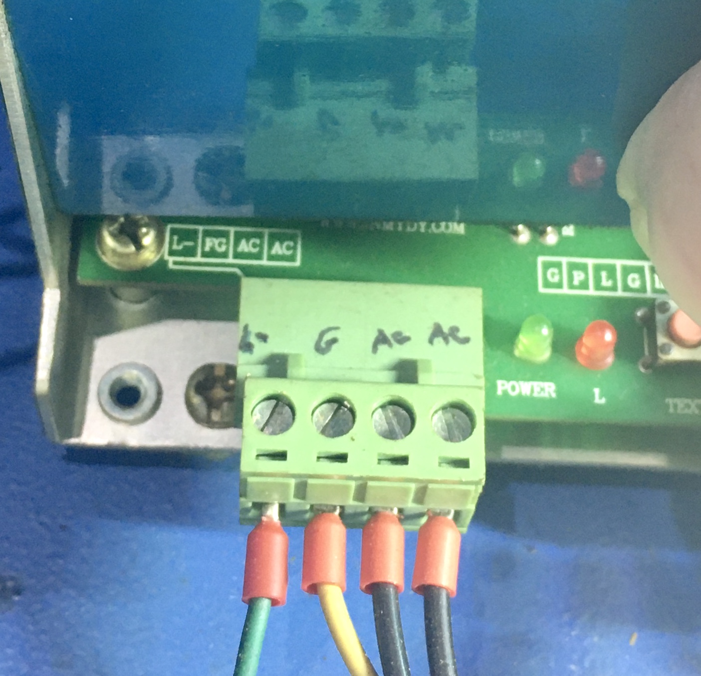

I will borrow a multimeter and write down the amps in every 10%. Where should I measure? With laser firing?
The cathode side of the tube goes to the L- pin on the laser power supply (LPS). Measure the current by hooking the meter in series between the cathode wire and the L- pin. That is, remove the L- wire from LPS and hook one lead of the meter to the wire and the other lead to the L- pin.
Set the % power and hold down the test fire button with the laser on. Record the current.

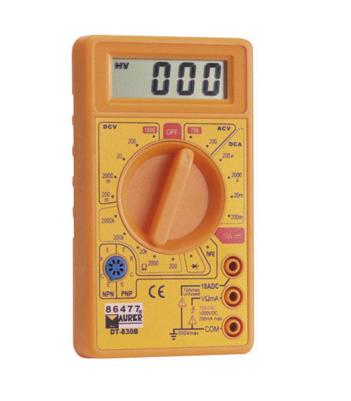

I just bought a MultiMeter, ready to measure :smiley:
As english is not my mother language (and I am bit slow), can you point me exactly where to measure? My multimeter has a black wire and a red wire :face_with_hand_over_mouth:
when someone says “in series” instead of “across” it means the meter has to be connected like a link.
Think of a link of 3 people each holding one hand of the other person creating a series of connections.
To measure in series you have to unlink the chain and make your meter one of the links which makes a chain again.
BUT, for current measurements, the meters often have a different place for the red wire on the meter. It’ll be marked 2A or 10a or something like that and then you need to also put the meter in mA or A setting. And you don’t want to put your fingers on any of the metal connections or even near them so it would not be a good idea to hold with your fingers the connections. The high voltage of the laser tube output can hurt you very much…
You should find a couple of instructions on how to install a mA meter onto a K40 and read them a couple of times. Apply the same safety precautions as you’ll find in those instructions.
Im sorry, I am not to install a metter. Just bought a multimeter to write down values on a paper.
Like 10% is 1 mah, 20% is 2 mah and so on.
In fact, I bought this one exactly

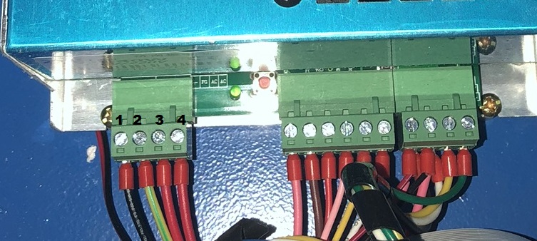

I will give it a try using your meter photo.
First, verify that the other end of the black wire on pin 1 of your picture is connected to the laser cathode.
If not STOP and let us know before proceeding.
  • Disconnect the black wire from Pin 1 on your picture
  • Connect the V(ohm)ma terminal on the meter to the black wire you pulled off Pin 1
  • Connect the COM terminal on the meter to Pin 1 on the LPS
  • Set the meter switch to 200m scale (it’s hard to read but I think that is ma scale?)
Run your test.
