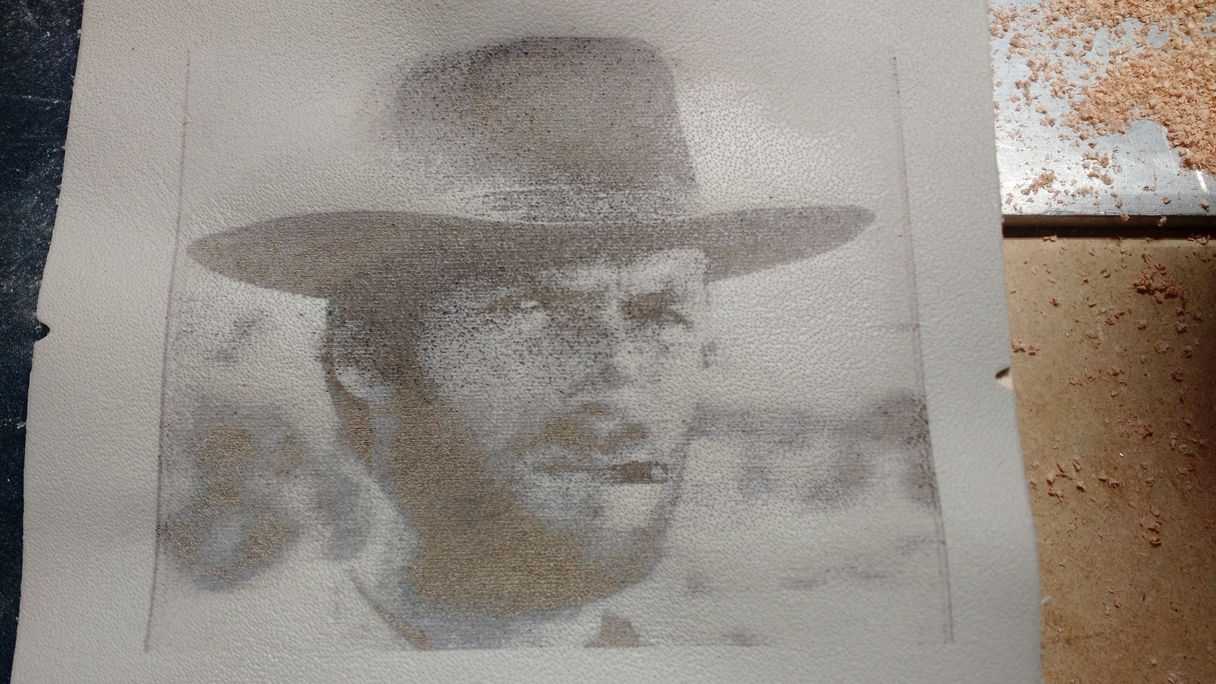

@Yuusuf_Sallahuddin_Y image raster on leather… this would have been so much better if I had some veg-tan to test
Yeah, Veg tan is usually the way to go. The result is quite nice though. It’s amazing how up close you can see all the little dots but when viewed from a distance you get a really nice overall effect.
Quick question, how big is this image & how long did it take to process? My most recent test (on ply) was 280mm x 180mm & took 2.5 hours (spot size 0.1mm, white 500, black 400). I have a feeling I must have some settings wrong somewhere for it to take so long. Any chance I could compare against your smoothie config file?
Veg tan is also better if you plan to do any embossing on the leather afterwards…
