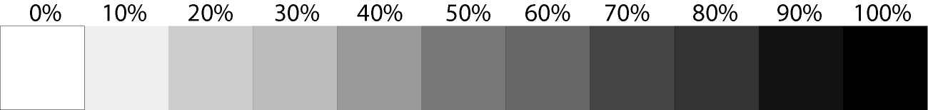

@Yuusuf_Sallahuddin_Y you need to come up with a test image that has 0-100% or 10-100% so you can dial in your feeds and power setting to get the contrast you are looking for try starting out with 150-200 black and 300-350 light… I also had to play around with my acceleration settings in the smoothie config to go along with it till I was satisfied with the results
P.S. yes I am doing some photoshop pre-processing before hand… it’s not really a science but more of a feel for it I will try and send you a photo I pre-processed so you can get a feel for what they need to be

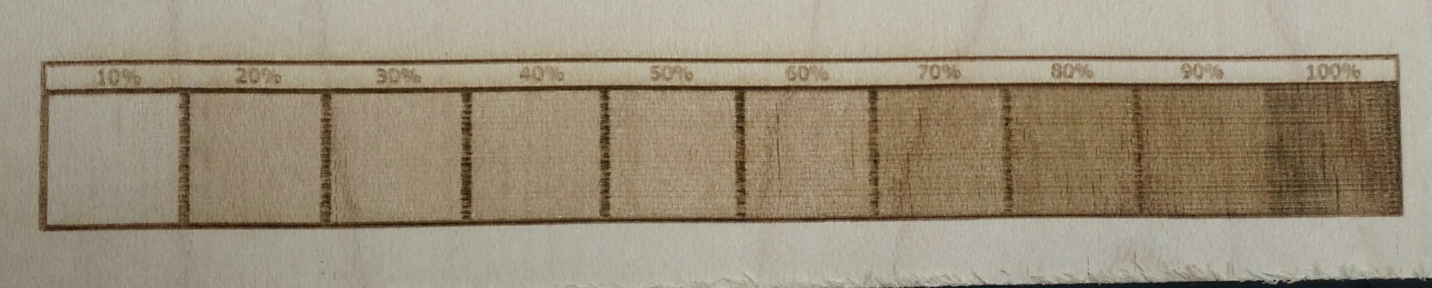

@Alex_Krause Cheers, thanks for that. I’m just playing around today to see if I can figure it out. So far not a lot of luck with getting the shades of colour to be noticeable, however that could also be related to the material. I am just using some cheap crappy 3mm ply.
@Alex_Krause is that one fresh or from the other day
That’s the same image I sent you the other day @Ariel_Yahni_UniKpty
@Wolfmanjm here is one I made the other day
is there a calibration image floating around?
I would like to make samples of each material I use that way it’s an “at a glance” setup deal?
Thanks. I got a similar image from Dave the other day. I somehow lost it.
