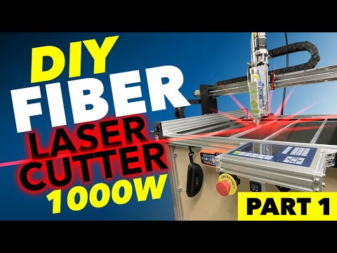

1000W fiber laser project
Not enclosed as far as I can tell, and $15K, but he’s identified parts that can run on typical US residential power.
I’m not building one.
Equal parts terrifying and cool. I wonder what their power bills look like during a busy week of cutting.
Probably a lot less than their bottled gas bills per unit of cutting…
