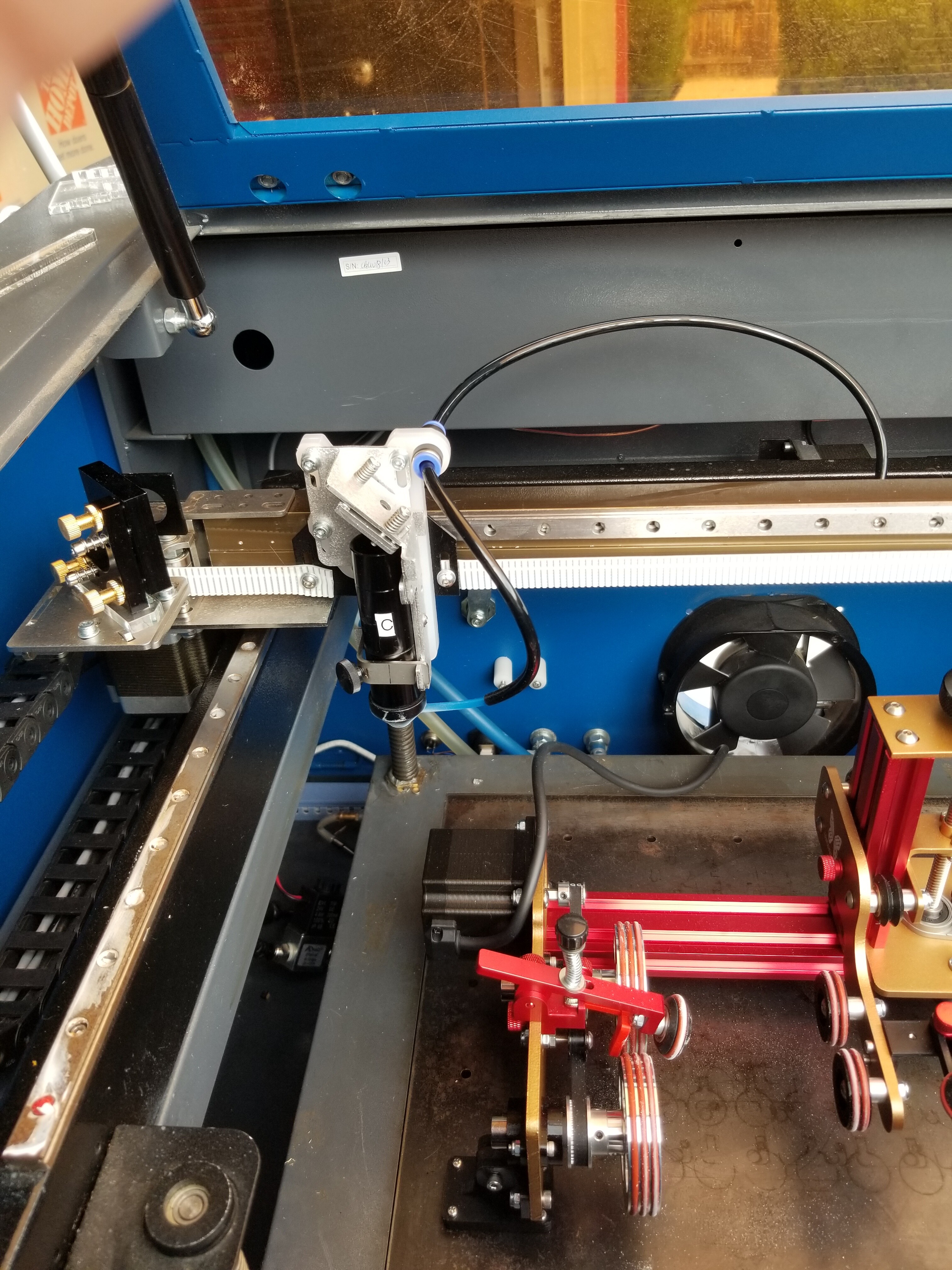

Wouldn’t it be cool to be able to use a combiner lens or other mechanism to get a diode laser beam onto the beam path of a C02 machine to have the ability to reuse the motion control and select between or combine CO2 and diode. I have no idea if the optic system of a CO2 will safely direct and focus a blue diode laser.
While an interesting idea, I’m pretty sure the optics (mirror, lens) needed for a 450nm wavelength diode laser vs a 10600nm wavelength CO2 laser are going to require very different characteristics. Just saying. :wink:

looks to me they are mounting the laser diode next to the CO2 laser head and that is not at all what I was contemplating. It would add way too much mass to the X axis it would greatly effect the speed and accuracy of the CO2 portion.

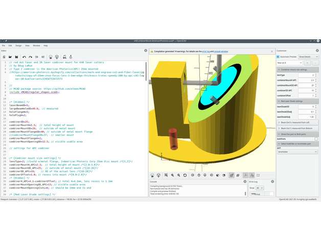

I’m talking about some form of beam combiner lens like I’m currently using with a red laser with this but the mechanics of getting the diode into CO2 optic path was not spelled out, just wondering if it is possible.

My mirrors looked to be reflecting the blue laser pretty good but the lens in the laser head didn’t pass the beam. I don’t doubt other light weight heads could be mounted next to each other but CO2 laser heads are very light weight and for a reason. Putting a full blown diode laser, heatsink, driving circuit and fan on the same gantry next to a CO2 laser head will effect your high speed CO2 raster engraving.
Now doubling up the mirrors(stacking slightly offset) or something for the 2nd beam and putting a 2nd lightweight laser head which has a 10,600nm might work. But beam divergence is probably the killer here. I think the diodes do not have divergence numbers near as good as CO2.
