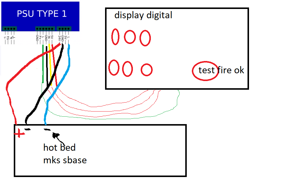

hello forum, I connected mks-sbase to k40, firmware cpprice grbl-lpc, motors ok, 1 pin L to the right connected pin negative hot bed, the 1 problem is the laser always on, or always off, how do I adjust? i connected G-IN-5v power supply,should i also connect pin L near G-IN-5v?

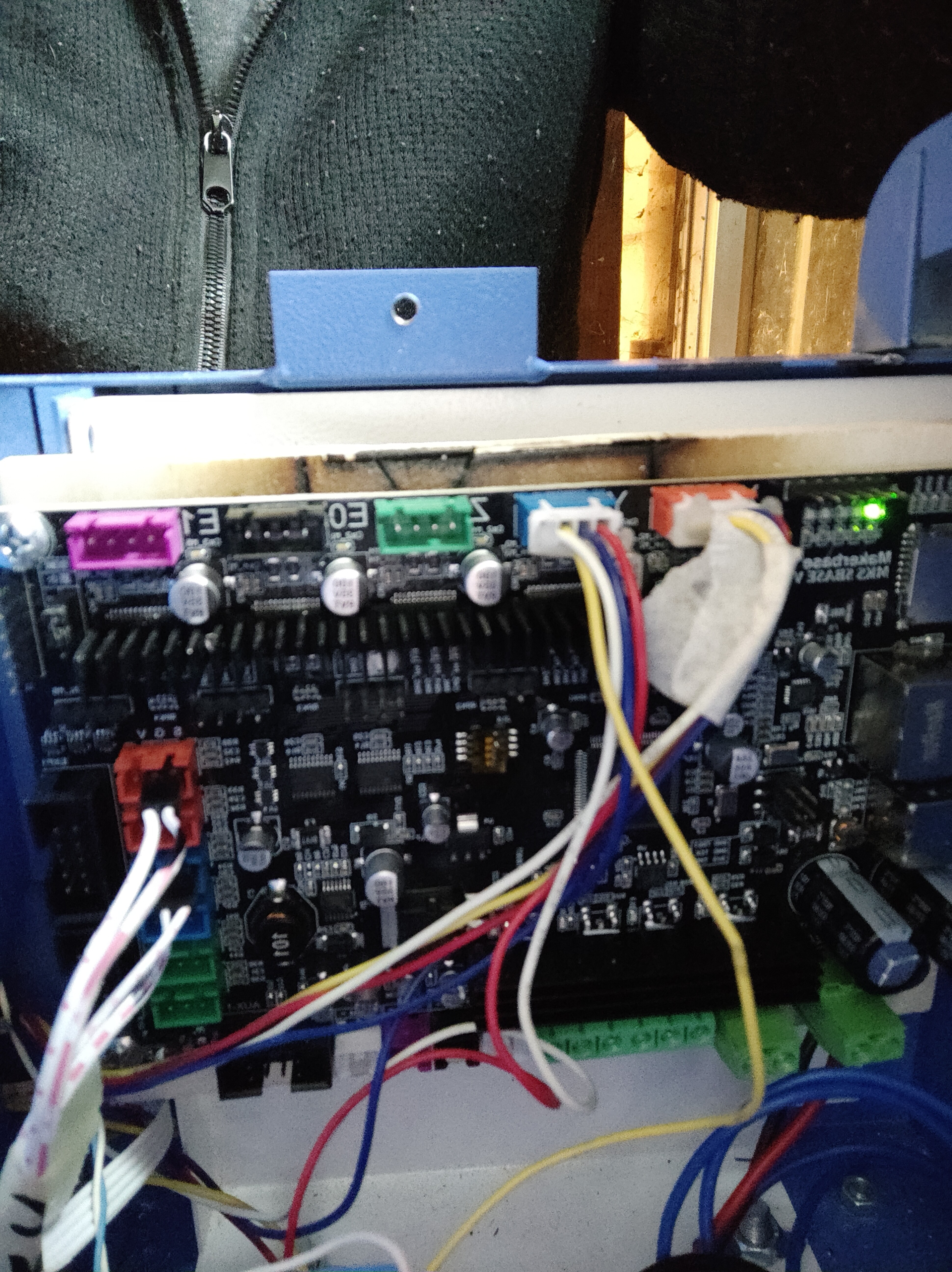

the second problem i connected a 2 wire mechanical limit switch you have pin SG mks limit switch x- and y-, if I click nothing happens, is it right to connect x- and y- or x + and y +?

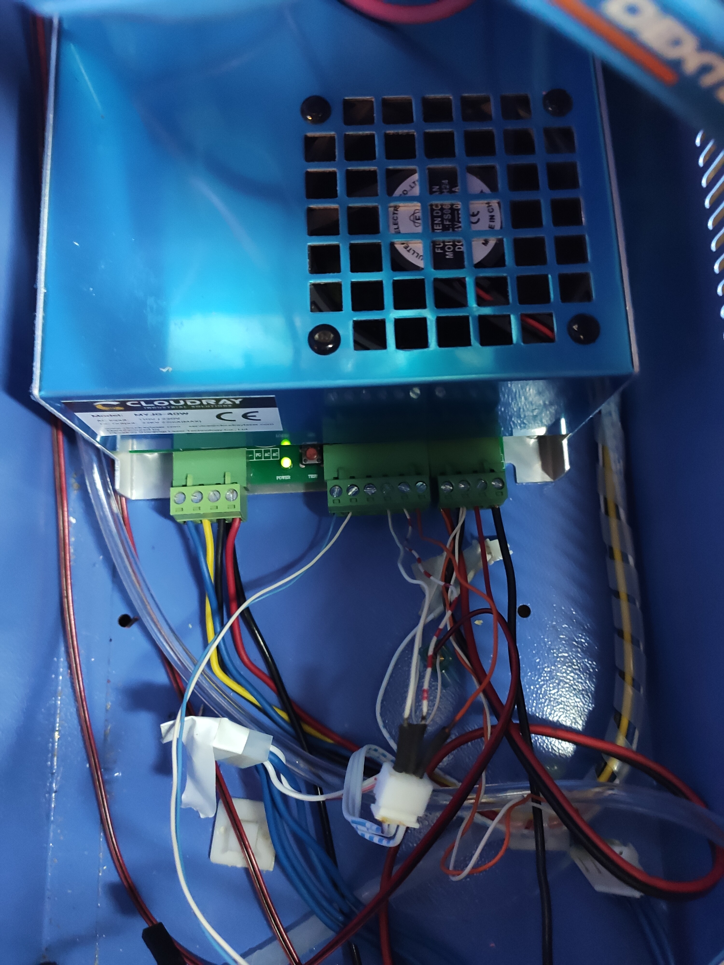

Let’s first deal with the LPS.
  • Looks like your supply is type E in the attached chart.
  • Let’s ensure that is correctly wired.
  1. Verify that your LPS is wired according to this chart.
  2. Post a picture of the actual wiring of the LPS when you are complete.
K40 LPS Type Conversion (2).pdf (68.1 KB)
sorry i don’t speak english, i understand little pdf, i drew my schematic,GND and p + connected water flow sensor, i connected pin G-IN-5v to the cable that goes to the digital display, connected pin L on the left that goes to the display, I turn on the machine and the test fire button works , I connect laser to UGS, the power on the digital display is at maximum, I do gcode M03 S1000 the laser does not fire, am I wrong connection?

Try this:
WARNING this will fire the laser so ensure you have eye protection!
  • With machine off
  • Disconnect the wire that goes from the hotbed [-] to the LPS-L [far right pin][blue wire on your drawing]
  • Add a jumper wire to LPS-L [far right pin] on the LPS
  • Turn the machine on
  • Turn the “Laser Switch” to ON.
  • Then temporarily connect the LPS-L [far right pin] to grnd.
Does the laser fire?
Universal Gcode Sender
Obviously I don’t use it lol
1 problem solved, the blue cable connected to L broke.
I have to solve the 2nd problem, endstop don’t work
the swicths are NC, when I turn on UGS or lasergrbl it goes into alarm, I unlock the program with soft reset + unlock, but then the endstop don’t work
Instead of reset + unlock you should send $H which starts the homing sequence. After successful homing, grbl clears the alarm state and the machine is ready for a job.
