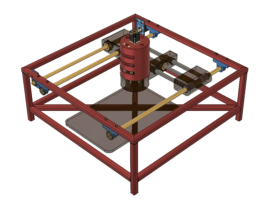

I have a simple problem that I don’t know how to address. I need 2 stepper motors to always turn in unison - ie at the same time - and I am wondering if this is a simple problem or a complex one.
I have designed my own CNC mill and it is absolutely imperative that 2 of the motors always turn in unison. The design is hard to explain but basically it solves an engineering problem I had.
Can anyone tell me if the new Smoothie v2 does this? Or is that more of a GCODE or post processing thing?

Wow sounds like good advice. I will show you a screenshot of the design - it’s super beefy - maybe a little too much so but i’m too dumb to design it any better.
I figured out later that if I have twin ballscrews on the X axis that my cuts will be stronger and more rigid - if I can get both motors to spin exactly the same - less math too

However, usually, you want to go out of your way to use a single motor on an axis if possible, and that’s even more true with ballscrews. If you had a failure that caused one of two steppers to fail (and there are lots of opportunities for that) is there any chance that the racking would cause damage to one or both screws?
I would use a single stronger stepper and a timing belt rather than multiple steppers. With the mechanical advantage of the ballscrew, timing belt would behave well WRT cutting forces. You could use a pair of 60T or 80T timing pulleys between the ballscrews and the forces on the belt would be essentially insubstantial, and you would know that the screws would run in sync. You could use two pulleys, one on each end of the screws, and have redundancy in case of a belt failure.
I can’t tell what you are making the frame out of, but it looks thin relative to your screws and rod. I’d expect compliance in your frame to be more of an issue than any timing belt stretch if you did that.
Have you considered bolting rail for open pillow block bearings to a frame element for your dual-ballscrew axis?
