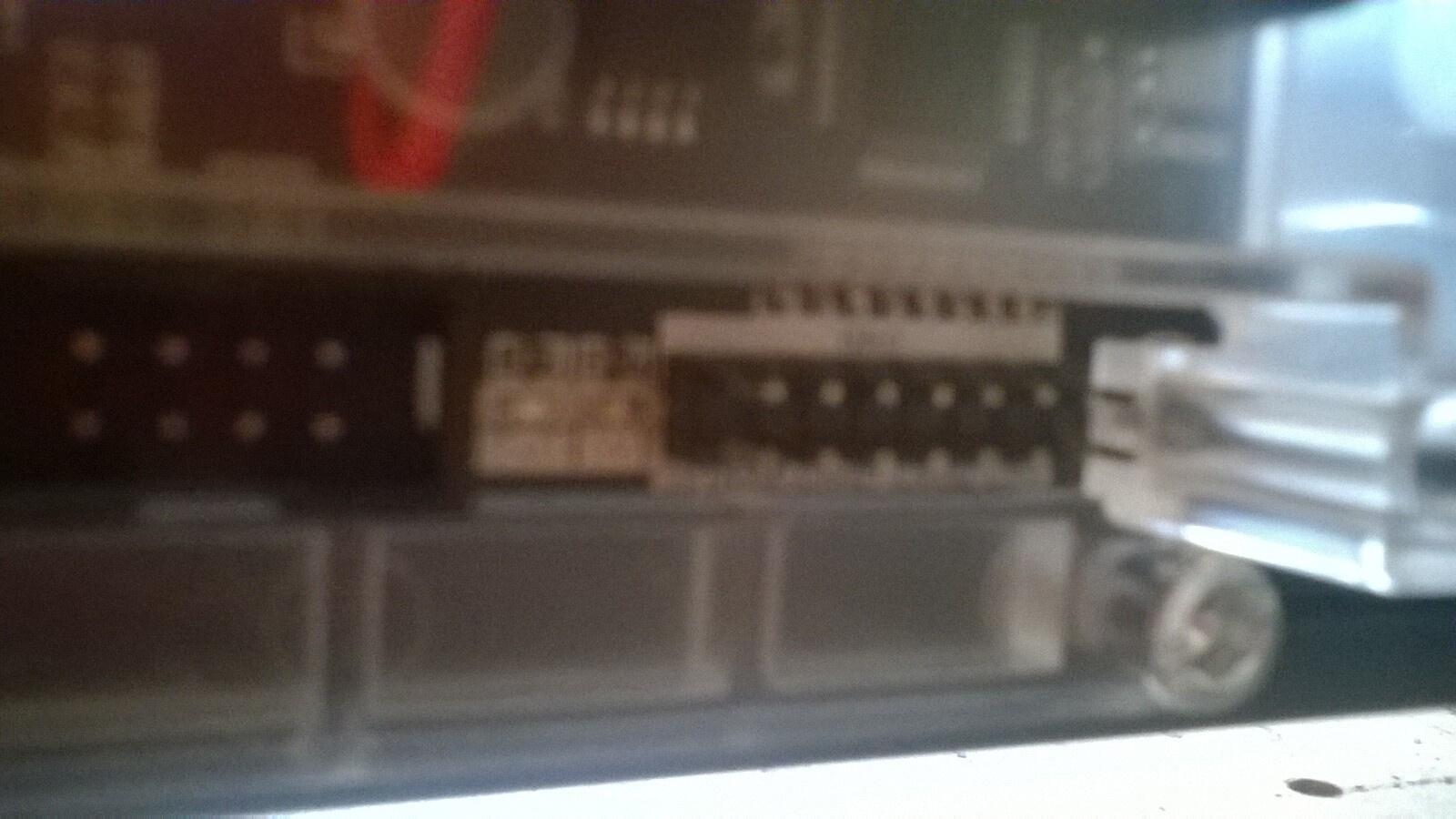

Here’s some more pics taken with my crappy camera, if they are at all helpful:
After playing around with some unwired connectors I think I might be able to get the DuPont ends to work after all. I think I just need to push the inserts further into the socket. I thought I got them to click into place the first time, but obviously I didn’t push them far enough.

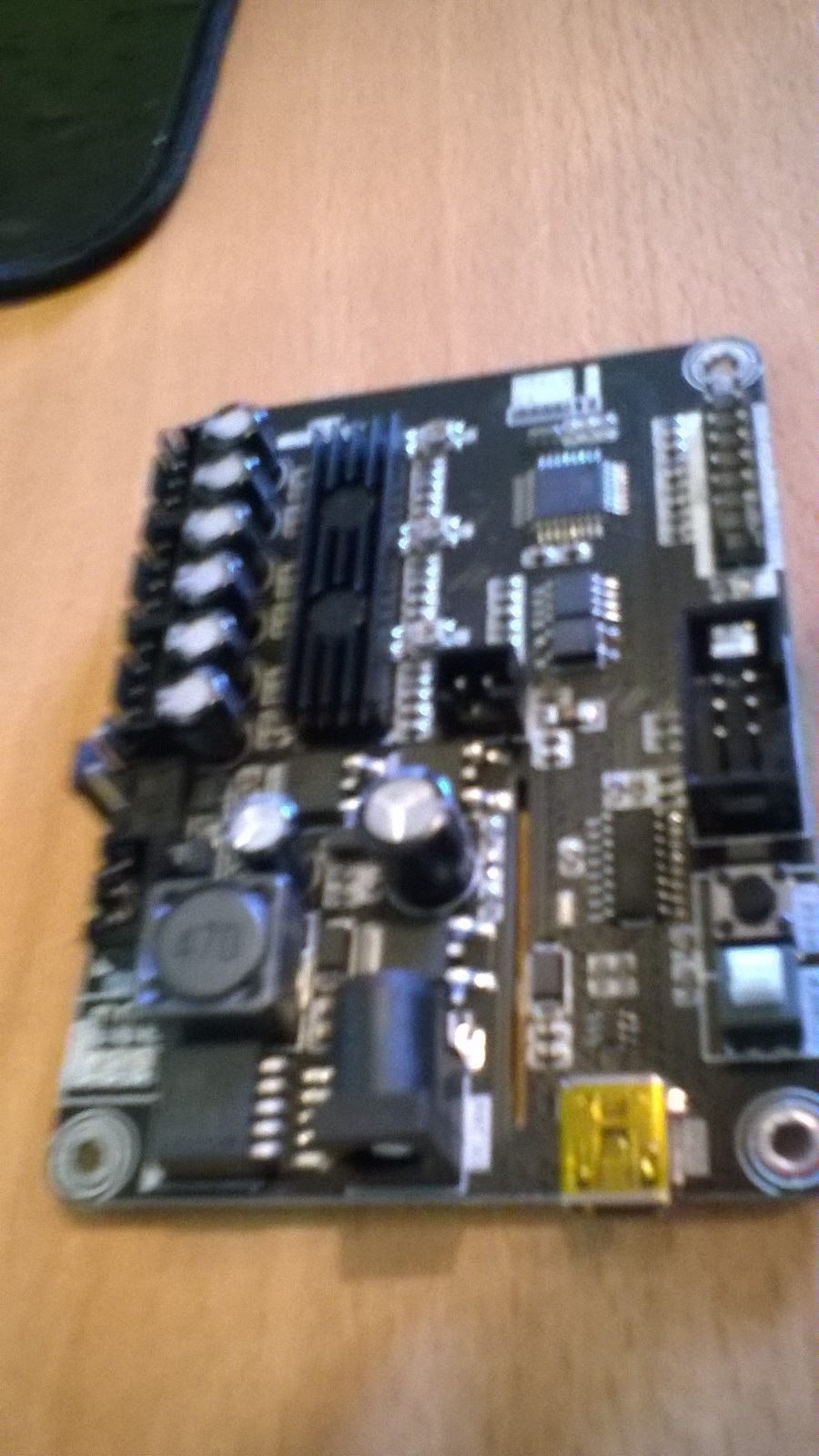

OK, found the board, I think:
Those look like normal .1" / 2.54mm pin headers, so female dupont connectors would be right. Yes, if you aren’t used to making them, it’s easy to think that the crimp connectors are fully seated when they aren’t actually. If the connectors come out of the plastic blocks, then they definitely weren’t seated right. If the connectors get bent, or you have wire with insulation that is too thick, it can be difficult or impossible to get the connectors to seat properly.

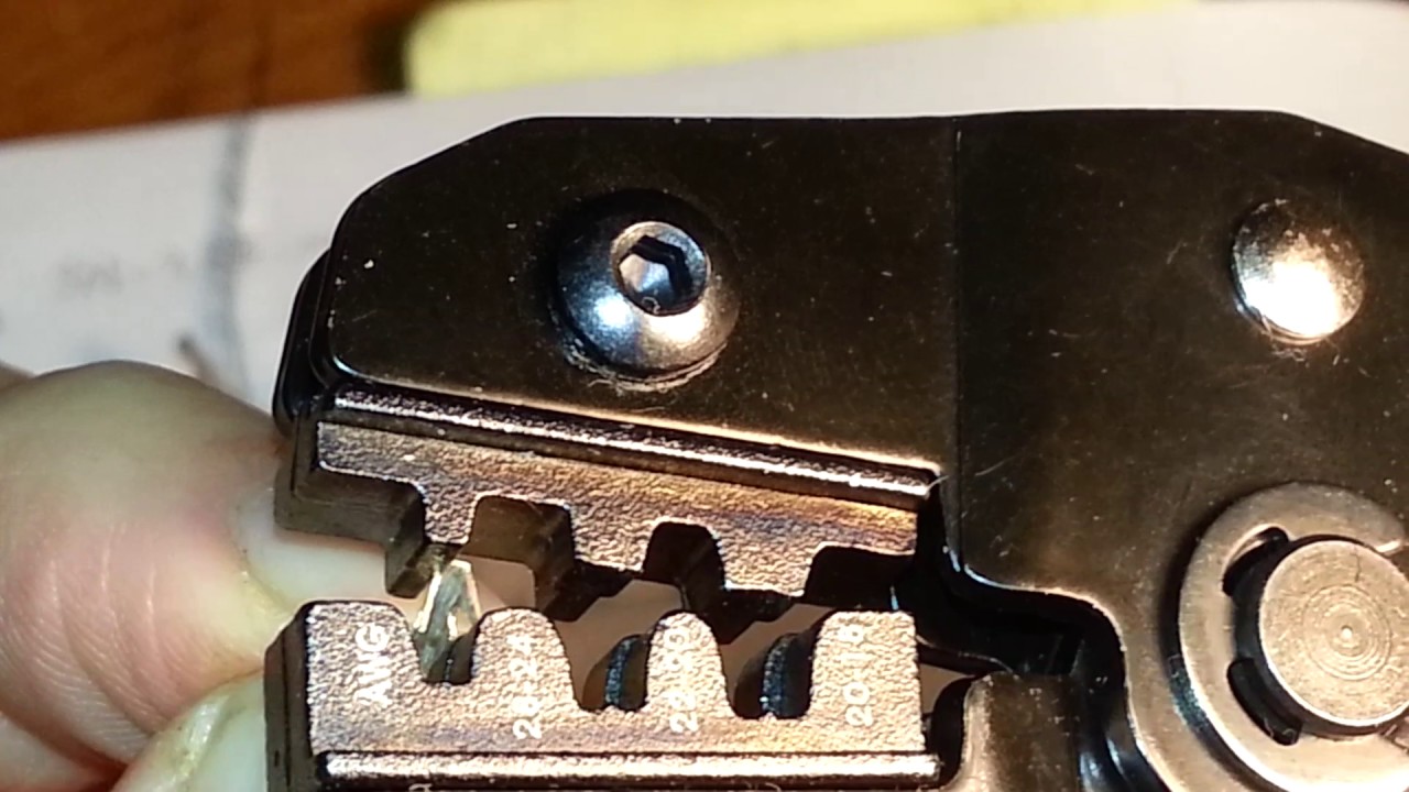

Thanks for the suggestions. The problem I was having was not being able to fit the wire (with pin attached) into the housing as the opening was too small. I solved this by simply soldering some thinner wire to the ends and then adding the pins plus housing. I’ve just about got the hang of the crimping tool, I found that the outer crimps wouldn’t quite sit in the grooves of the tool so I’d squish them slightly in the very end of the jaws then sit them in the groove and apply the wire. The video you linked certainly goes into a lot more detail then the ones I watched and confirms to me that I’ve used slightly too much exposed copper in my crimps- explaining why it’s a bit difficult to slide the connector onto the PCB. Not perfect but it works!
