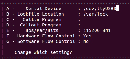

I installed minicom per the instructions here:
https://help.ubuntu.com/community/Minicom
I then set the following port settings using minicom, Bps/Par/Bits = 115200 8N1:
And voila! I was able to send Gcode to the printer and receive status messages back.
Its worth noting that I needed to configure the ‘screen and keyboard’ in Minicom to enable line feed, carriage return, and line wrap options, as they were disabled by default. The messages I was receiving back were in a single line and running off the screen until I enabled these options. that stumped me for a while.
