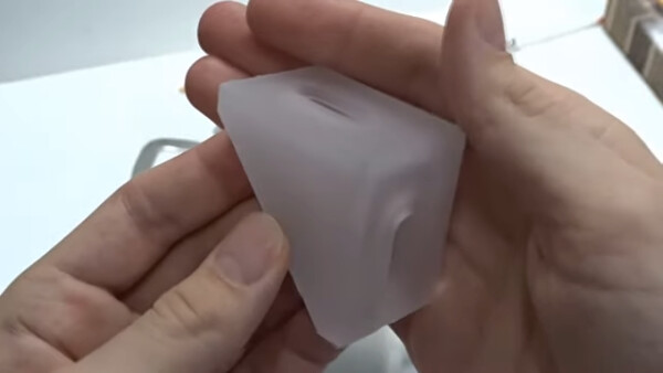

It’s possible to use PLA for things that need to get hot, but you have to crystallize it. I’ve heard of remelted PLA slow-cooled being used for handles on tea kettles. I had been hoping to experiment with packed fine salt (like popcorn salt) but someone beat me to it and reported success. Hackaday featured that recently:
The point is that you have to hold its shape while melting it and then letting it cool very slowly, causing it to crystallize. “Annealing” is usually used metallurgically for processes that toughen by reducing crystalline features as well as remove internal stresses, but this heat treatment for PLA makes it more brittle, not more tough.
