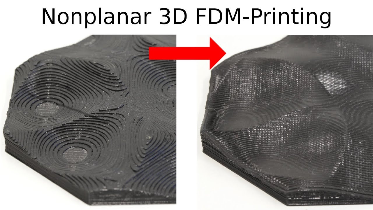

3D printing of nonplanar layers for smooth surface generation

I’m curious about the impact of the width of the shoulder around the nozzle on surface finish. My first instinct was to turn it down to get it out of the way of the path, but then I realized that would make a smaller radius and might be a worse surface finish. :thinking:
Thanks for sharing! Maybe limited in application in plastics but rather useful in ceramics for geometric tiles. The nozzles in clay printing are also much longer and narrower increasing your useful height. I’ve been doing non planar printing with Grasshopper for ceramic and indeed the nozzle is an issue when traveling downwards at an angle. Keeping the nozzle rim thin improves the finish. Upwards is no problem.
