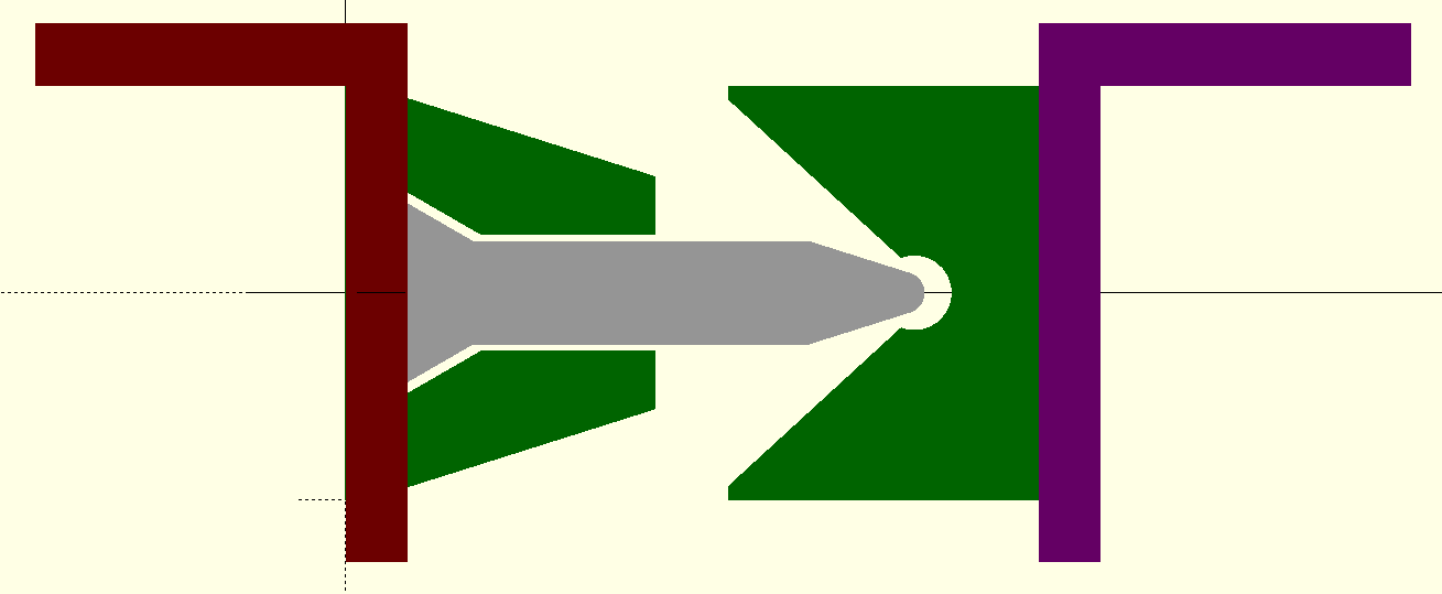

I’ve been playing with an openscad model for a vice brake today. I think that it would be possible to provide a bunch of different angles in the anvil block to facilitate different angle bends, but I’m still thinking what that would look like. In the meantime, here’s a mock-up of the assembly as I have it so far. It would sit in a vice.
There are several different sizes of fingers that you would slide into the block. If anyone wants to print and try it out, let me know and I can send you my work-in-progress to play with.

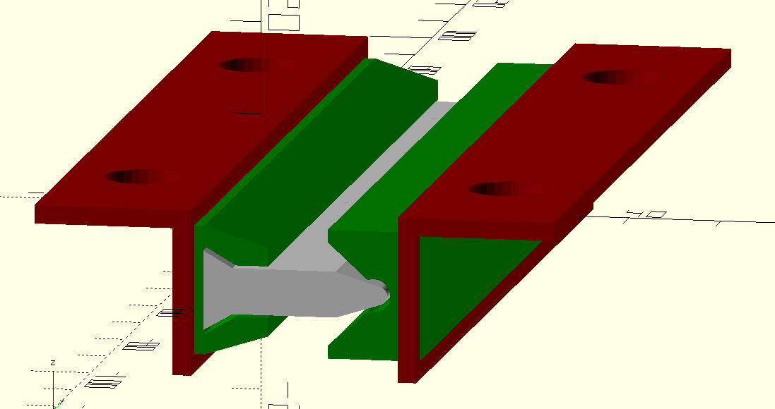

I haven’t printed this yet, and won’t have a chance at least until the weekend, but… I have now accounted for the angle of the stock in the shape of the base block holding the vice fingers, and have parameterized the included angle and allowed for stock thickness in the anvil.
If you try it out, feedback appreciated. Feel free to ask questions about how to modify the parameters to get a desired result.

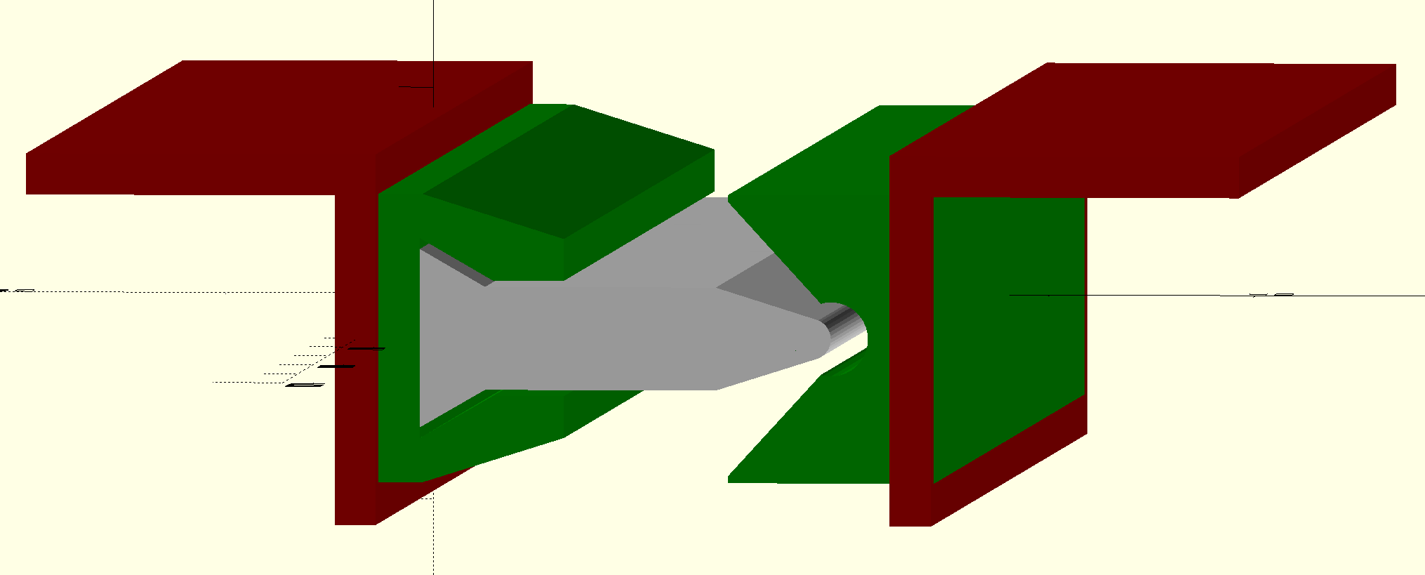

The company quoted in the article says that 12 gauge is the highest gauge of steel they bend with PLA on a commercial basis. I think that 3mm aluminum might be a bit more than this design would work well with. But here’s a profile of a heavy-duty version with 10mm thick fingers and 25mm tall blocks:

Thanks @Eclsnowman — this looks easy enough:
Looks good. Don’t forget that unless you use architectural steel, you will have an inside radius on the angle iron. That will hold the top plate up slightly from the vice jaws. Perhaps just magnets on the underside of the angle would hold it up enough to mitigate the Inside corner radius.

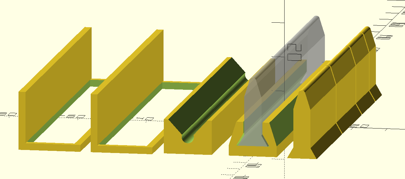

I wasn’t thinking angle iron. I was thinking that this whole thing is 3d-printed. The angle is printed separately from the finger and anvil blocks so that it prints without supports. I was expecting to glue (or maybe tape) the blocks (green, above) into the frames (red, above) and similarly drop magnets into the holes in the frames, which are meant to have just one layer of plastic under the magnet to keep it from just dropping through.
Here it is as oriented to be printed:

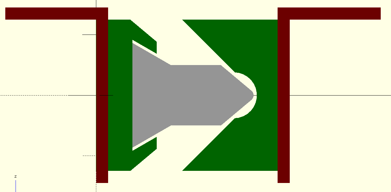

New cross section:
The frames are now different from each other, so using different colors to help keep them separate. They are also thicker.
The anvil has more plastic at the base, and the blocks are wider.
I’m suggesting 100% or so rectilinear infill at 90⁰ for the anvil only for greater strength in the direction the first version broke, and 100% perimeters for the other parts. Haven’t printed this version yet. But I do have some 3mm aluminum set aside to test.
Also thinking about holes for bolts and retaining plates top and bottom for the anvil, but I’d rather find a design that doesn’t require that.
