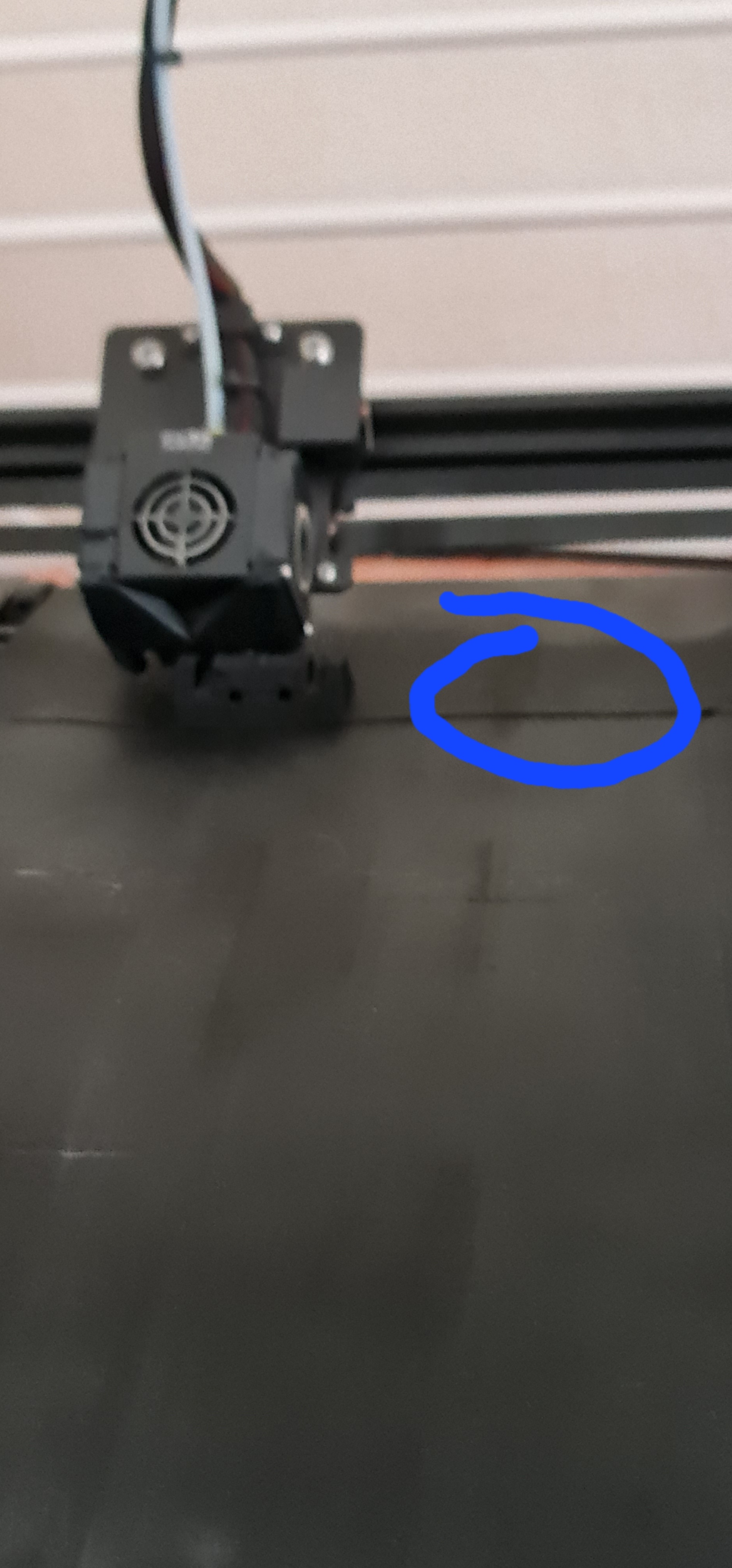

After having two prints fail (one of which was 3 and a half days wasted!), I discovered the reason why.
The slicer creates a primer line :
This line, once it gets to the end of the belt, can get trapped here :
This results in enough tension between the trapped piece still connected to the end of the print to pull it off the belt.
Could save you some time and plastic knowing that :wink:
