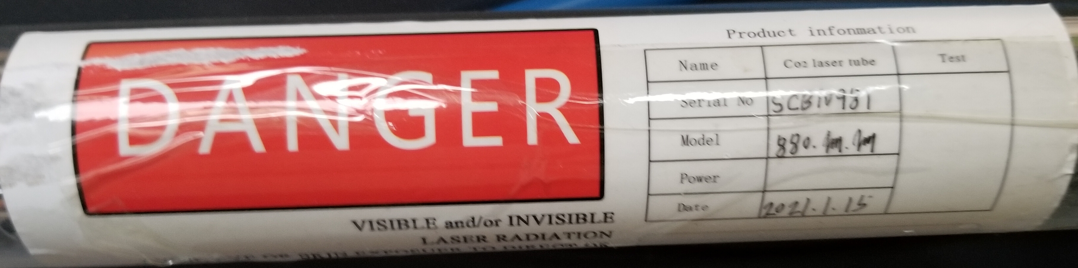

It usually says on the tube, but it’s usually about the same as for a K40 (16-18mA) . I limit mine at 16mA.
What control software are you using? If it’s Light Burn then min and max power need to be the same at low speeds or it just defaults to the lower number. That threw me for a bit on mine when I got started.
I think he probably means mirrors.
My ‘test’ page from my machines manufacturer had 21mA max for the tube. I’ve used that as max and keep it down around 18mA for most things. Tube is 880mm and measures 44W with a Mahoney.
Set the lps to 10.5mA at 50% pwm…
Tubes placard, guess they left that out… lol
:smiley_cat:

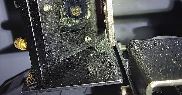

You are correct. I meant mirror (no.2).
I think it’s a residu of the tape I used for the mirror allignment.

yup, somehow it doesn’t get out there that you do NOT want to put tape in front of the mirrors when doing alignment UNLESS you put something behind it. Before I 3D printed target holders and slide paper targets in, I used tape too but put a dime attached to the back of the tape so it would not melt the glue onto the mirror.
It really should be in every K40/K50 FAQ to not use tape unless backed with something.
