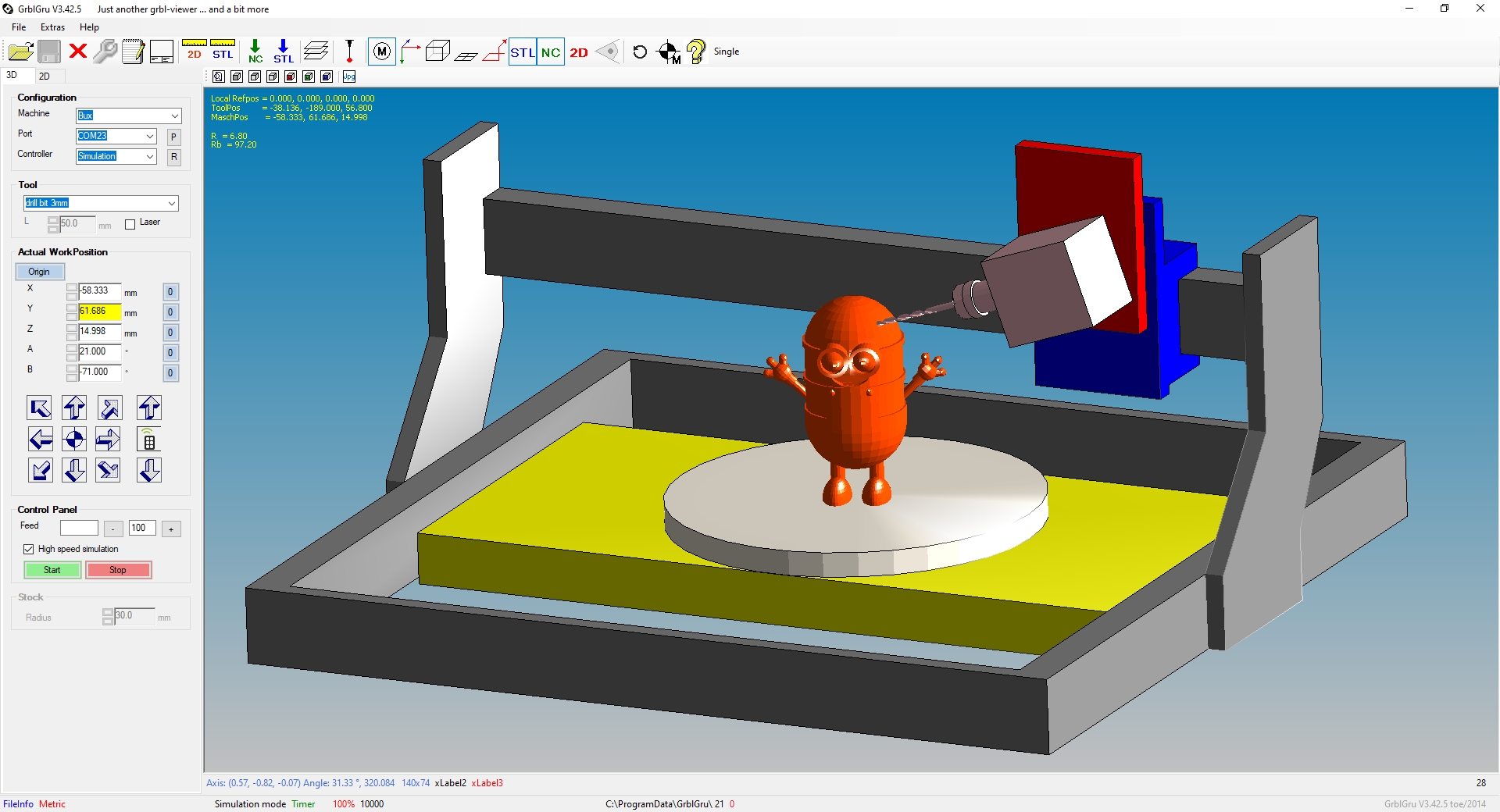

I have uploaded a new beta version V3.42.5 to my website.
It contains a new machine type “BUX” and also a machine with the same name.
I hope that will help you. :slight_smile:
