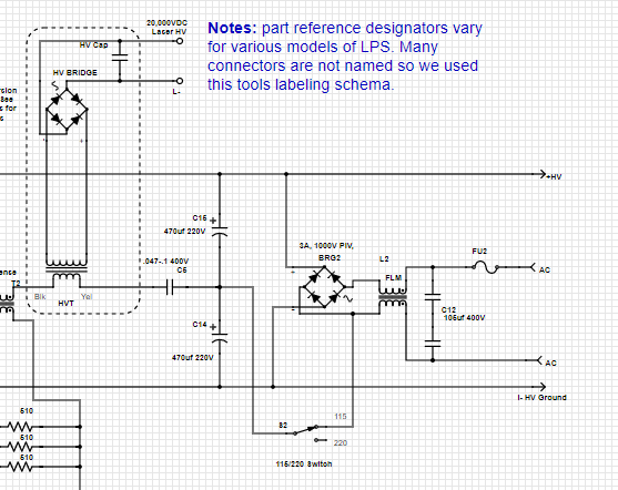

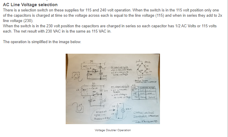

The input circuit looks like this:
And it works like this:

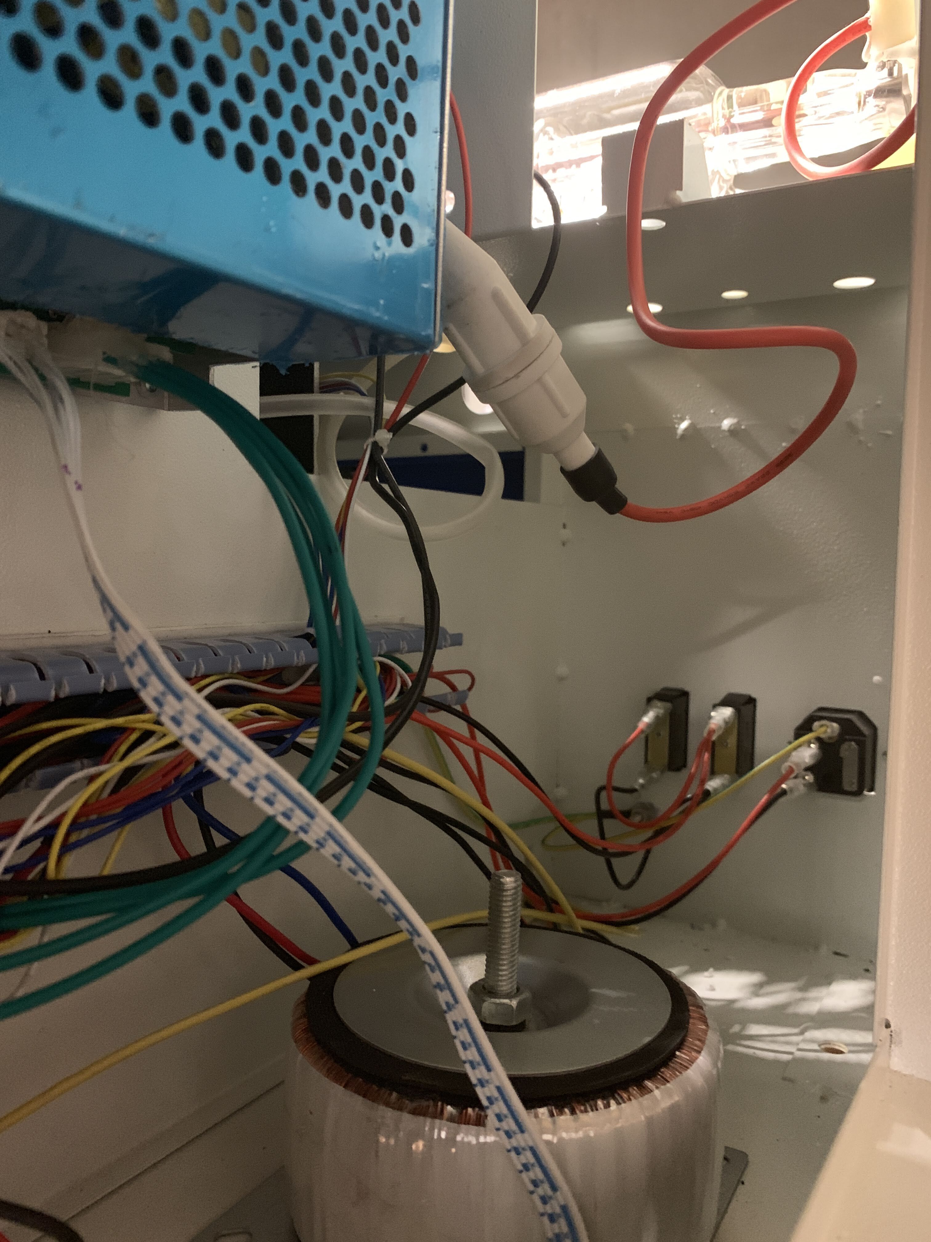

Is that big wire wound thing (img _1074.jpg) connected to the LPS?

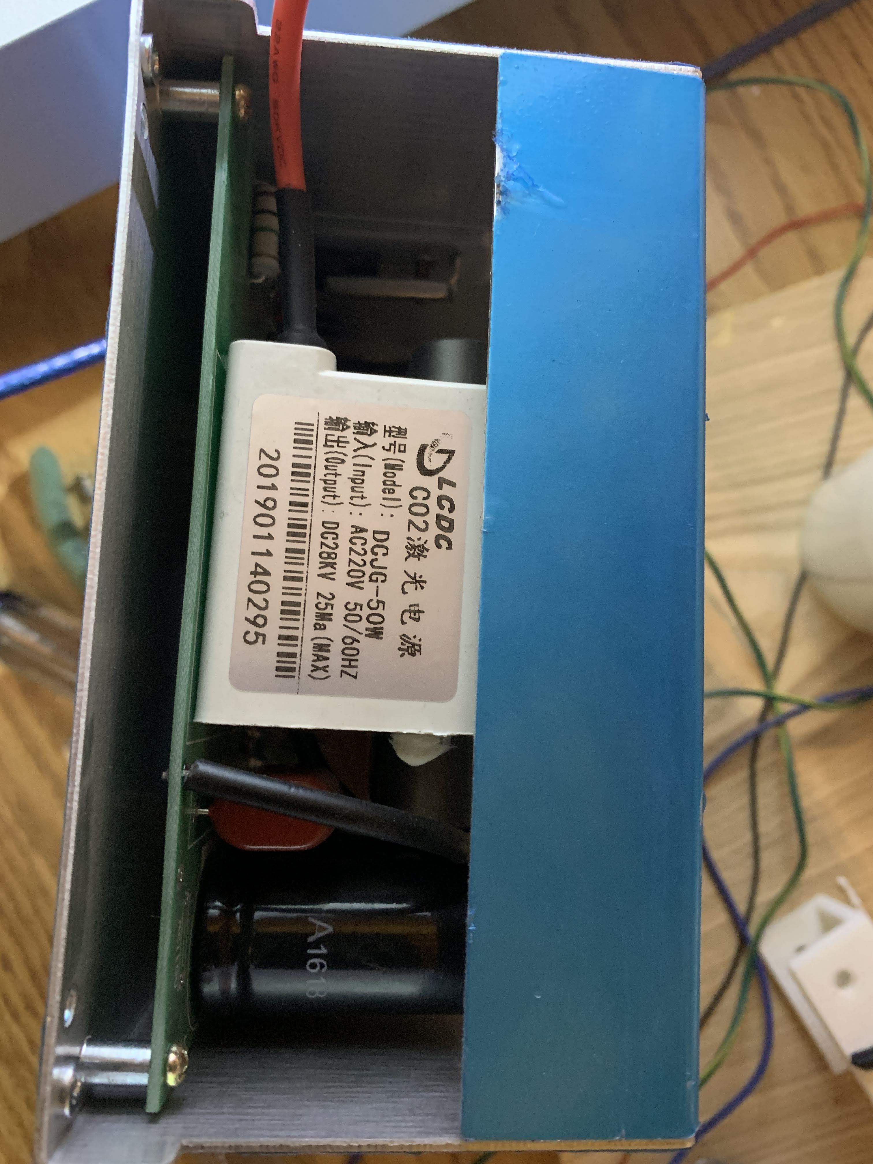

I may be able to tell if the supply is strapped to 115v if I can see pictures of the connectors and the LPS PCB with the cover off.

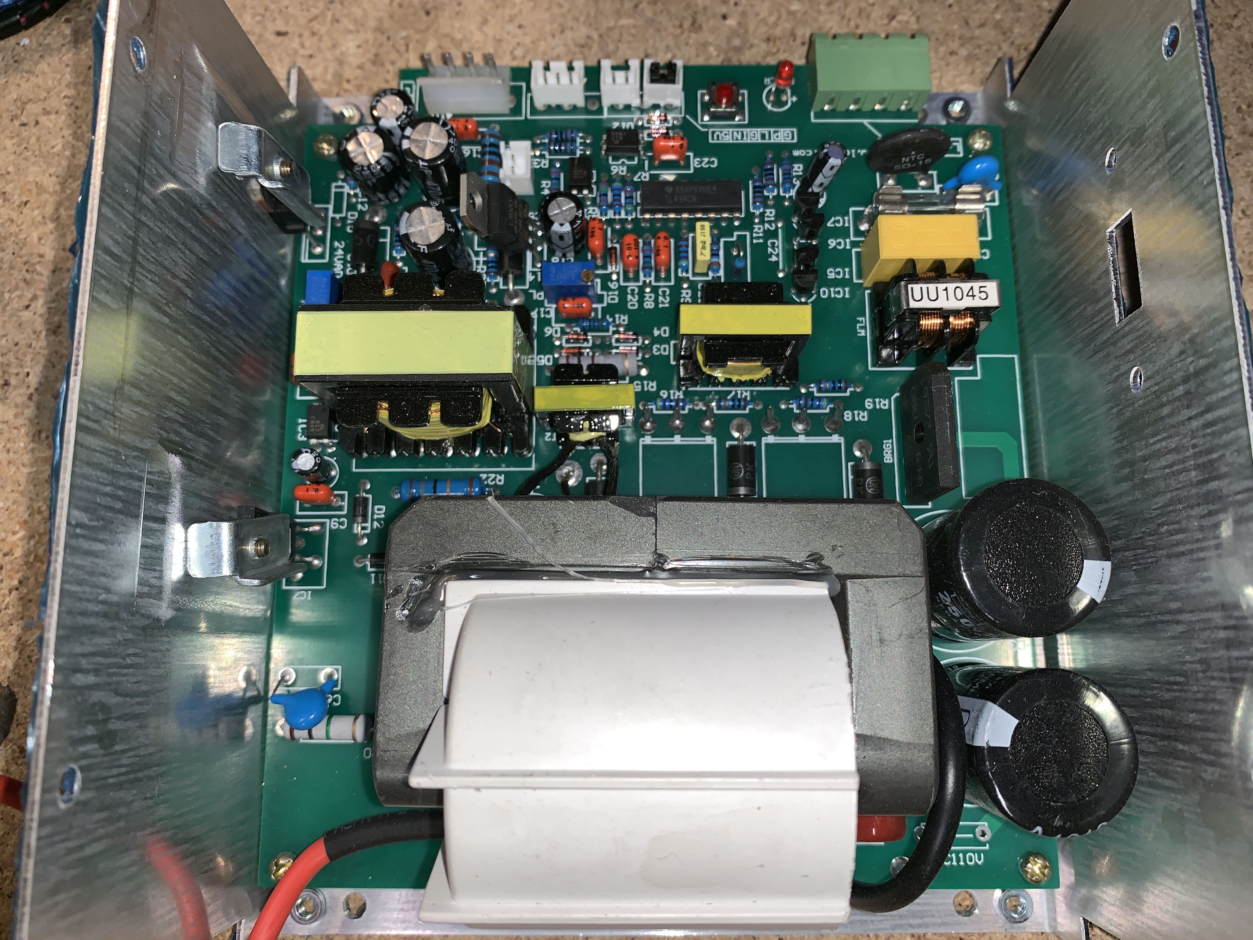

That supply is slightly different.
That “AC110V” jumper is not on any of my supplies.
Is that jumper shorted? That may be how they are selecting the power range …
I think I see a wire but no solder?
Short out the 115 jumper pads and give it a try.
