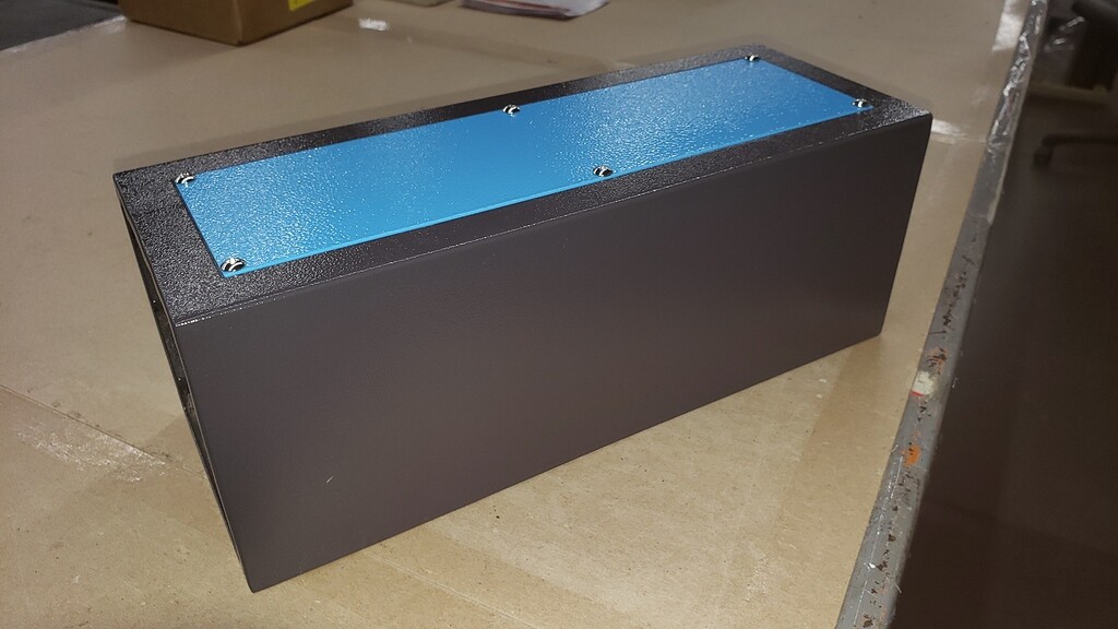

That tube won’t fit in a K40 case without an extension. A metal extension that is electrically connected to the case is important for safety.

Found one for you:
Yeah I read that, but he wrote:
SPT 850mm CO2 Sealed Laser Tube (40W) from light object
actual 40W tube vs the 35W tube the K40s actually come wit
The new tube is a true forty watt and needed the extra space provided by the extension tube. I was going to replace it with the OEM tube to avoid the extra hassle but it was not much more money. I’m glad I did, the extra power really is nice.
So it still counts as 40W, the 50W chinese still cheaper than a branded 40W.
