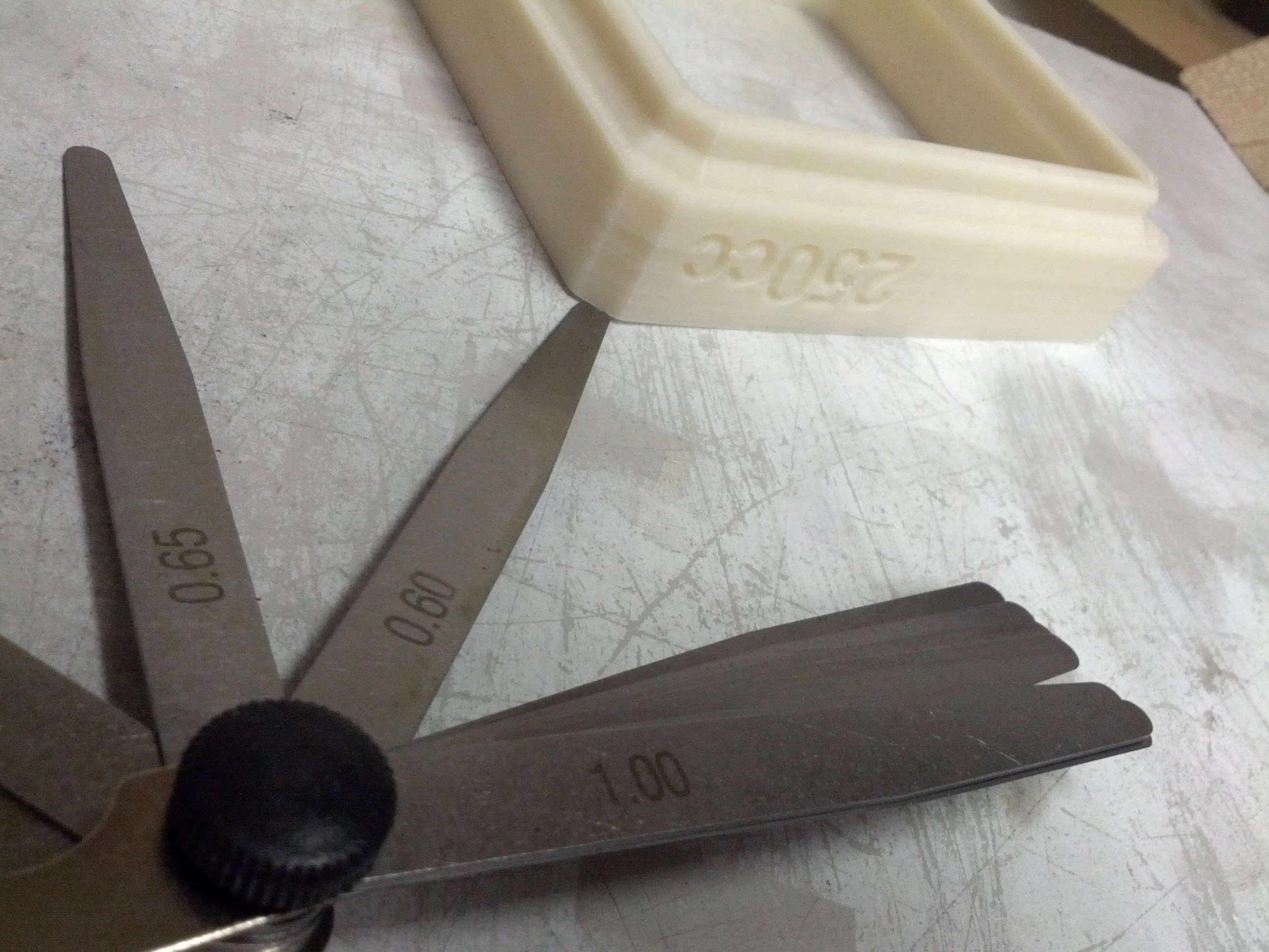

I’ve recently tried a couple different heated bed toppings, and i still have some experiences with others from earlier on. For each test, the bed was set as hot as possible without the print deforming from the heat - for me, that was 120C for the first and a gentle slope down to 105C for the remaining layers, with 105C reached about 5mm into the print. The bed is a standard Prusa PCB with a layer of 0.5mm aluminum and a 3mm glass sheet on top. My printer was deliberately left un-shrouded in the cold (~8C) basement to maximize warp. This is what i found:
