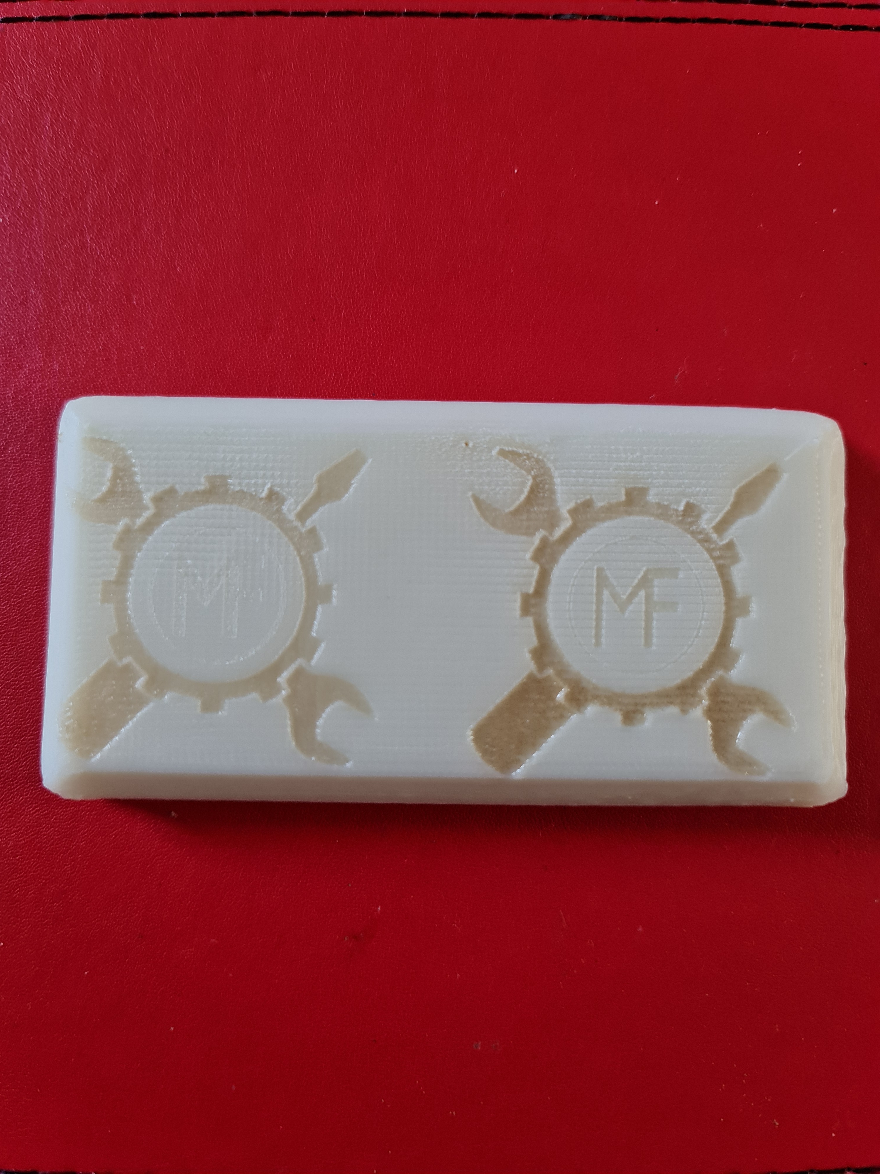

Would be interesting to see what a engraving by a CO2 laser on white ABS would look like if someone with a CO2 laser has some white ABS laying around.
I’ll do it, I have both.
I will post my results :+1:
And the results are :
Rastered at 160mm/s, the one of the left was 8ma, the one on the right 15ma -
Fill density on the block was 60%. It doesn’t look particularly good as a finish.
Thanks Jammy you rock! About what I was thinking would happen, but wanted to check. Seems dark marking will only work at lower wavelengths.
