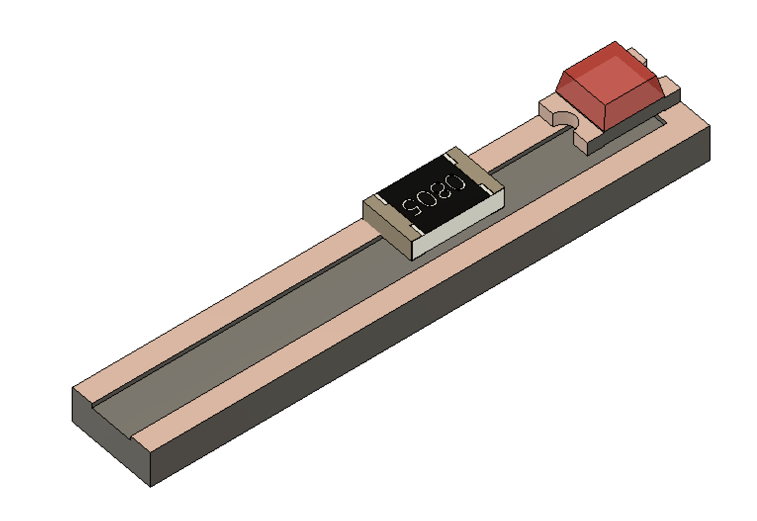

The bottom of the actuator has a new slot to receive the top slots. There’s room for two 0805 SMD LED’s. One generates light, while the other receives the light. The receiver LED should generate enough voltage to be detected by the ESP32 when the slot is pass-through, and a lower voltage when the solid plastic is blocking the light path.

Here’s the mini PCB with the LED. I may not need the resistor if I run this using the LEDC hardware on ESP32 where you get to control the brightness of the LED via freq/duty. For the input LED I’ll try to feed into the pulse counter hardware on ESP32 so I have barely any load on the CPU.
The PCB’s slide into the bottom of the bottom like in this shot.

Milling the LED PCB’s to fit inside the slots. One needs a resistor, the other one doesn’t.
How the LED PCB’s fit into the slots.

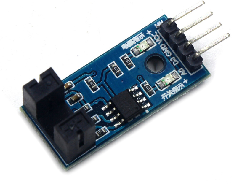

I had some photo interrupter boards lying around and they seem to only have the opamp on them without a schmitt and they’re not seemingly noisy with the actuator slots when i test run them based on how the LED blinks, so perhaps it’s not necessary. I was just holding it in my hand so it wasn’t a very good test. I did have to add black sharpie marker to inside/outside of slots to get the LED to blink on the detector though, so that was interesting.

I would put the output of the sensor on a scope with stepper running and look at the dc offset, pulse width and the edge transitions.
