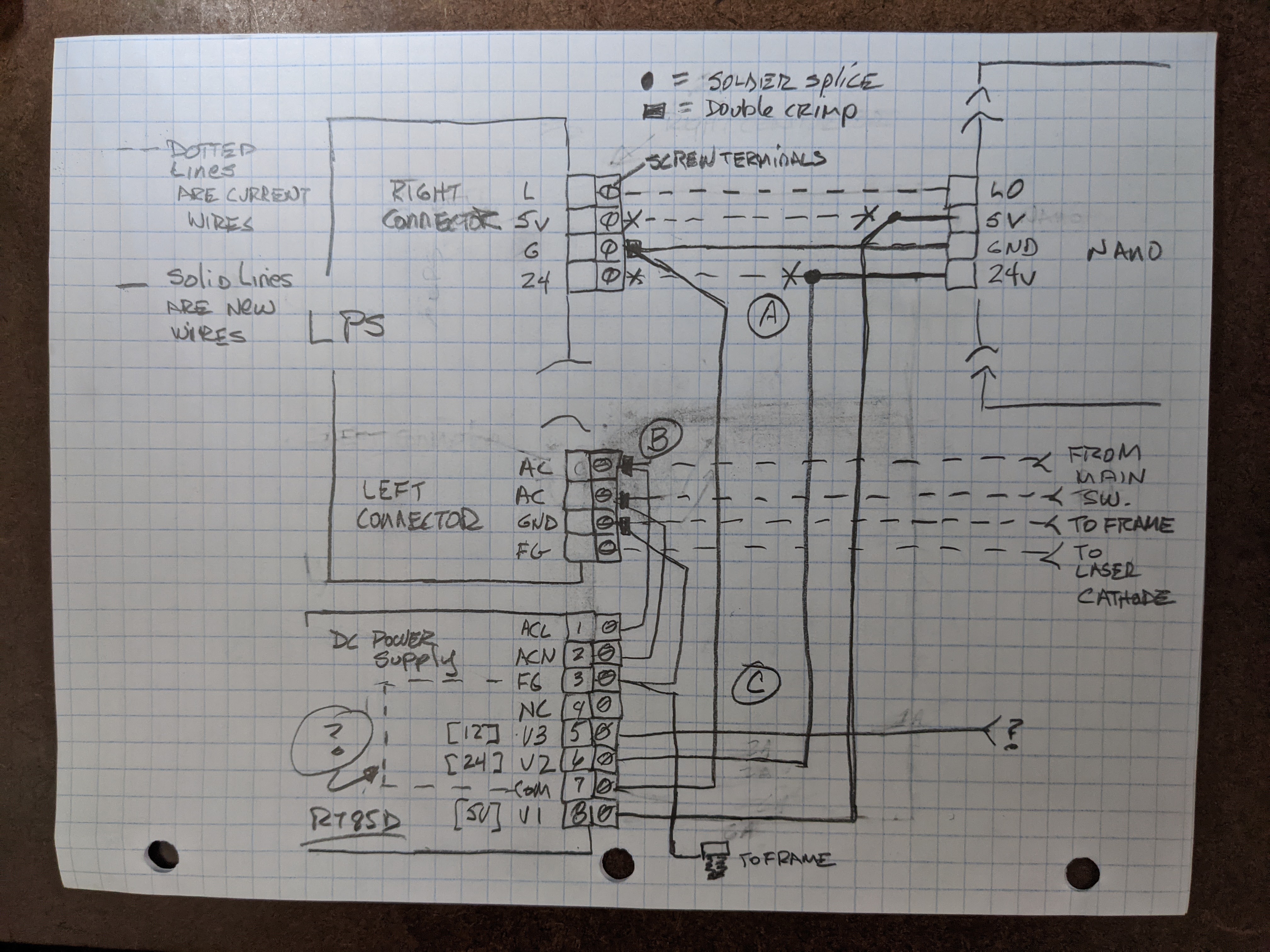

In any case here is a drawing to help you decide how to add the DC supply to power the nano.
I separated the wiring into Sections A, B, C.
The dotted lines represent what I think is current wiring
The solid lines represent wiring changes
The X on a wire represent were a wire is removed
I did this from what I could glean from the pictures of your machine and the PS specs.
Your machine may vary from this so adjust accordingly.
Please check everything carefully. Let me know if anything looks strange or wrong.
A
  • The LPS-L to Nano-LO wire is left alone
  • The LPS ends of the nano 5V & 24 wire is disconnected at the LPS and connected as shown to the new supply. If the wires are not long enough I would solder-splice/shrinkwrap longer wires onto them.
  • The Gnd that goes between the LPS and Nano is left alone. A wire is added from the LPS-G screw terminal to the DC supplies Com connection.
B
  • The AC, AC, & Gnd wires from the LPS ac connector [left connector] are daisy chained over to the DC supplies AC connections as shown.
  • Check to make sure that the GND on the LPS is connected to the frame.
C
  • Connect the DCPS-FG to a screw in the frame. I would put a stud in the floor between your DC supply and the LPS so you have easy access from both.
  • The 24v, 5V are already connected from previous wiring
  • I do not know where you want the 12V connected
  • Check with an ohm meter that the DC supplies FG and Com terminals are connected together internally
Wiring and testing:
  • I would wire up B first and before connecting anything to the DC supply verify the output voltages are on the terminals you expect and the correct value.
    EDIT: The DC supply specs refer to voltages as both V1-3 and also Channel 1-3. I assumed channels and V are the same so you should check on the actual supply.
  • Then wire A and C.
  • With the DC power plug to the nano unplugged from the nano verify the correct voltages on the correct pins.
  • At this point there should be nothing connected to:
    • LPS-24V
    • LPS-5V
  • Then plug in the nano and power up and test everything

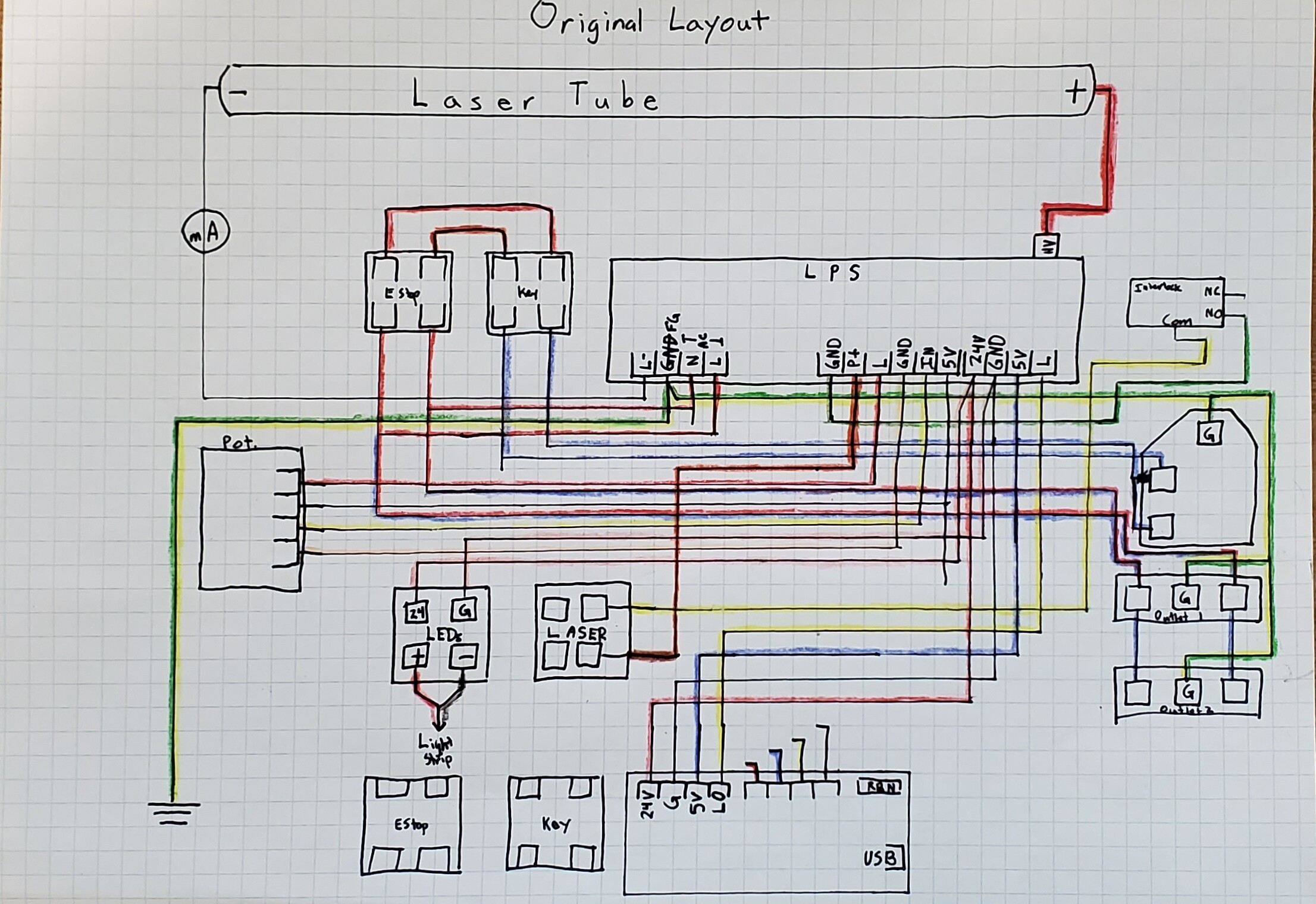

@donkjr Thank you for the incredible information and work that you provided for me. I truly appreciate it. I worked on my drawing of the unit as it arrived to me today. The only change that I have made is adding the mA meter.
As to what I am attempting to achieve: not a lot yet. I want to take some of the load off of the LPS and move it onto the new PSU. From my reading, this will help since LPS is at its limit with stock wiring. I want to be able to add lighting, gauges, whatever other electronics I need to, in the future.
I attempted to figure out Scheme-It but that is going to take me a bit to figure out. I drew (by hand) a schematic of the system. I apologize that the colors of the wires are so close. I have not changed wire colors at all since I received the machine. The wires from the bottom of the E-Stop are Red and run to AC N/L. But, they are also spliced into outlet 1 (right most outlet near Main) with Blue wires.
Looking good.
One way to make the drawing more legible is to make two drawings one that just shows AC and one that shows all non AC stuff.

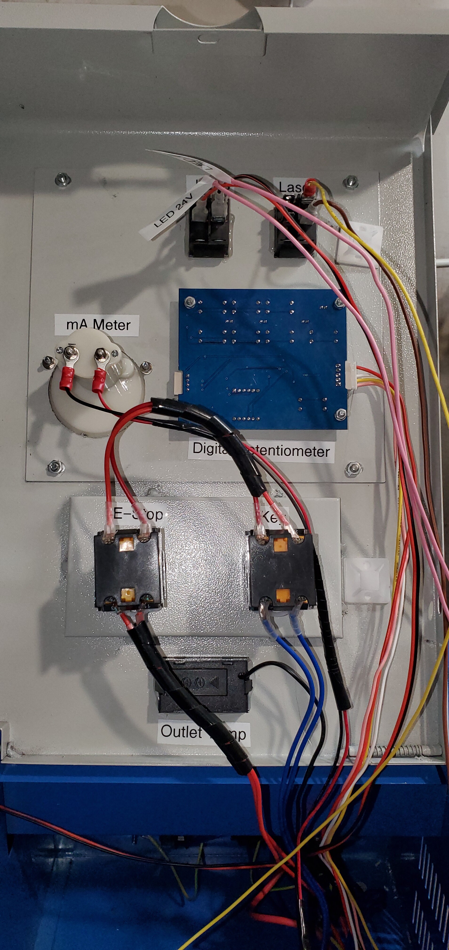

What is the box on the left labeled Pot.?
Good idea! That is the digital potentiometer (if that is what it is called). I am working in scheme-it now trying to get it figured out. I am not entirely sure how to make the main connector there (the C14/15).
Share the schem-it drawing and I will help if you want.
Not sure what you mean by “digital” potentiometer? Picture?
Do you have a digital control panel?
Sorry for the delay. Not feeling great today. I wasn’t sure what the control panel is called. It is a digital control panel (not a digital potentiometer). I added the mA meter. I think that scheme-it at least looks right even if my choice of symbols is not perfect.
