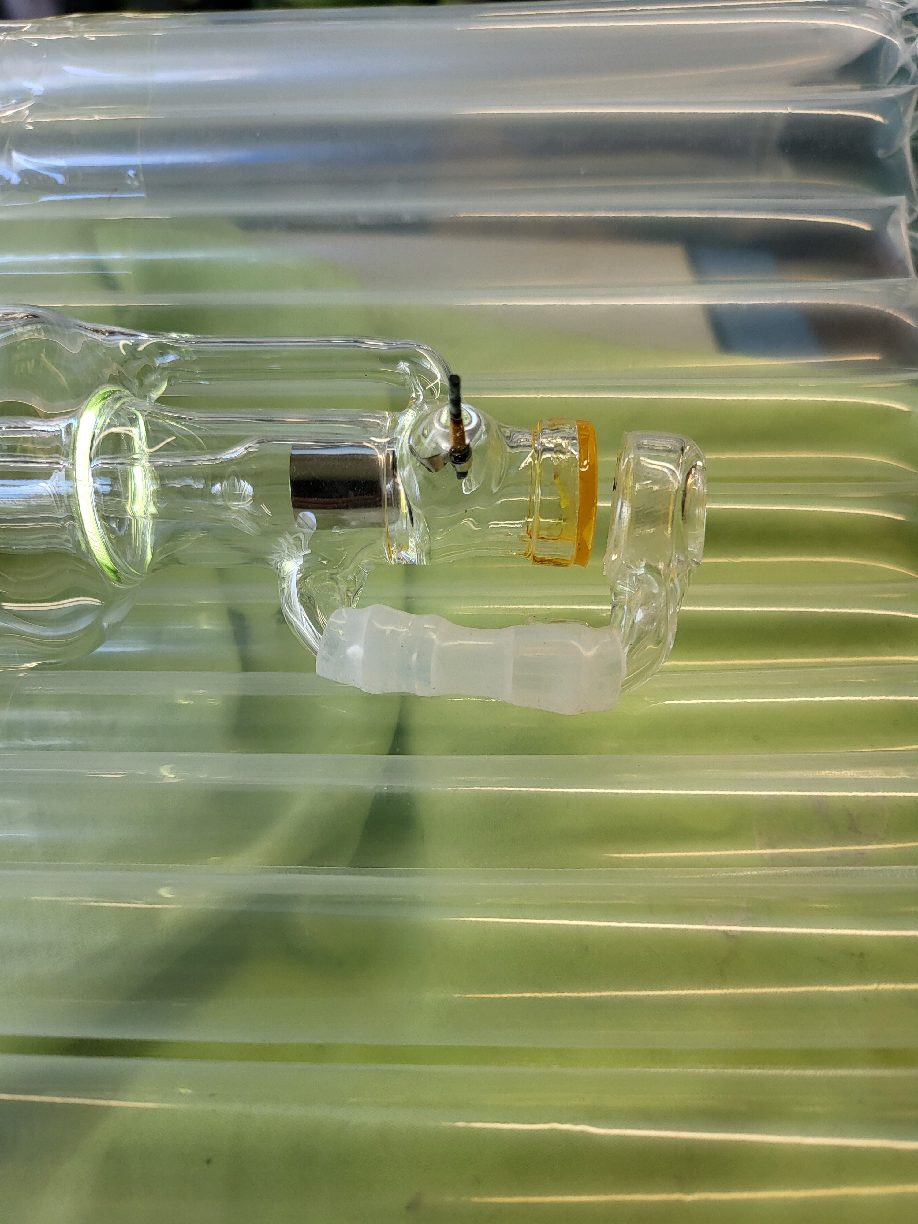

So today I removed the old tube and have started to install the new tube and encountered another roadblock (really not having much luck here), the tube is detached at the lens.
Is this something that can just be glued or is it best to get the tube replaced?
The part which came off is the cooling ring for the output mirror. The tube itself is most likely still perfectly fine.
That ring can be glued on (again), but you have to be careful to not get any glue anywhere else.
But there is of course a chance that this fails or that the tube is already dead for some other reason. I recommend to contact the seller first.
Yeah that’s what I figured, sent the supplier a message with a photo so hopefully they exchange it as gluing does not sound like the perfect solution.
I bought two tubes and the other was all good.

When you get any updates from the seller. Please let us know! This is the same issue I have. And it doesn’t seem like you can just put it back in place. The silicon tube is “too long” which is probably why it disconnected in the first place.

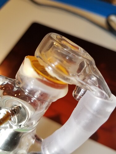

Thank you. I have the same situation posted by Trojan where the cooling ring is disconnected. And none of the videos show how to reconnect it. Any possible way? Or is it a bust and I need to purchase a whole new tub?
There was a long discussion on this on G+ but I cannot find that thread.
I know that some glued the jacket back on with high temp epoxy and some with high-quality CA.
I am not sure how well the repair worked but what do you have to lose in trying the repair?
I think a repair can work if the glue does not get on the output window. You can google this problem and there is evidence that others have successfully glued it back on. That is if the output mirror seal is not damaged and the gas has not leaked.
I have often thought that if I had to do this repair I would remove the tube and position it upright in some kind of holder so the cooling ring will sit flat and gravity is not helping the glue drip onto the output mirror while curing. I would apply a thin line of glue on the perimeter of the ring so there is no sqeeze out onto the mirror, then tape it flat on the top. The water jacket tube’s tension may make this difficult so I would dry assemble it first to verify that it can be held stationary with tape. I think I would use epoxy that is designed for glass.
This would be my choice:
Others have used a wedge to hold the glued ring in place while in the machine but I would be concerned that the glue would drip across the mirror from the top of the seam.
You could also apply CA, hold the ring in place and then spray the perimeter with CA accelerator. I am not sure if the accelerator would get on the mirror and contaminate it or how strong the joint would be.
