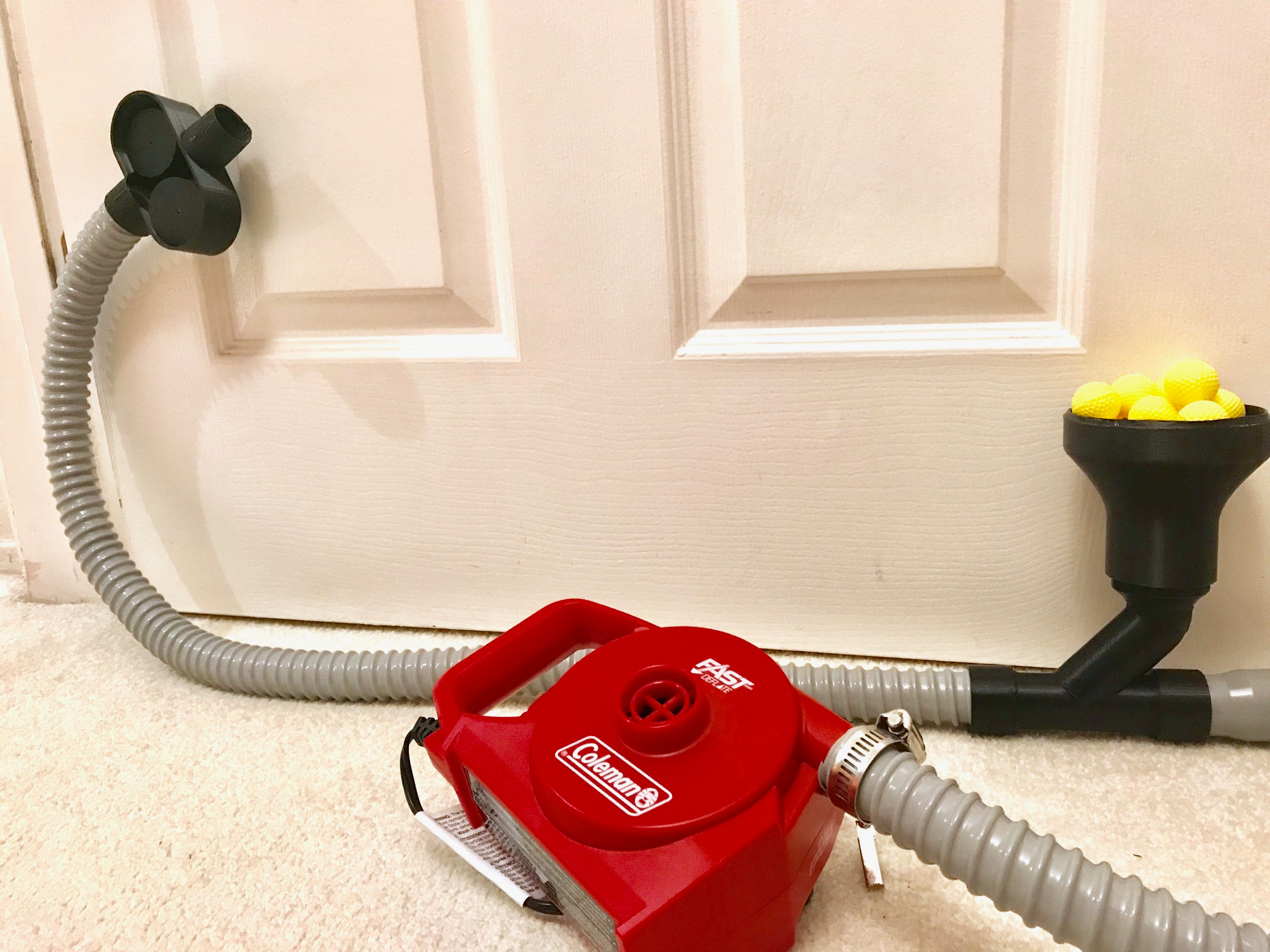

I am trying to find a way to create a system that continuously transports Nerf foam balls up a hose to some flywheels. In the photo below you can see the basic setup with the air pump on one end blowing into a Y connector which has a funnel connected to it, then a hose and finally the flywheels at the far end. (The funnel/hopper currently does not have an agitator but that’s going to be engineering problem #2 so I am ignoring it for now).
When I drop a single ball down the funnel and then turn on the pump everything works great. When I turn on the pump first and then try to drop a ball down the funnel, there is significant blowback pushing the ball back out. If I manually push the ball down the Y piece of course it shoots out just fine. If I disconnect the outgoing hose from the Y piece and run the test there is no blowback and again the balls come out as expected. Question: how can I fix this and get a continuous feed of balls down the funnel and up to the flywheels?

Maybe you could just close the top of the funnel. If it is air tight the ball will not have to fight a counterflow. If you could divert a bit of the flow to go trough the funnel cover, that will help to push the ball in.
This is an impedance problem in fluid dynamics, which is not my specialty, but… To make it work as an open system, you need to balance impedance so that the air path through the hopper is the same impedance or less than the hose that follows. Your design has multiple factors contributing to higher impedance through the nozzle of the gun than through the hopper.
Some factors increasing the impedance of the hose after your hopper:
  • The design of the hose itself; that hose has ridges that impede airflow; smooth internal wall flex hoses exist; they are stiffer and won’t have as tight a bend radius, but:
  • The bend in the hose; if most or all of the bending were before the hopper it’s more likely to work.
  • The length of the hose after the hopper; the resistance is roughly linear by distance within the hose, but also:
  • The shape of the nozzle. If you have laminar flow, you won’t have a turbulent interface, but otherwise you can think of your nozzle as pushing back pretty hard on the air column.
Induce laminar flow upstream of the hopper with a flow straightener and preserve it through the system by smooth walled hose with minimal bending and length after the flow straightener.
No guarantees but it’s more likely to work!
Closing just the funnel did not make a difference. I drilled an 8mm hole at the funnel’s downslope to see if this could vent some of the excess air but oddly enough that also had no impact.
Yesterday I looked at available tubing, but once you get to the 1" reinforced stuff it becomes very stiff (and non-reinforced, non-corrugated tubing kinks easily).

Quick update: I got some 1" pipe insulation foam instead of the corrugated hose and that made a huge difference. As @mcdanlj said the ridges impede airflow a lot. Now I just need to find some kind of hose that’s just as flexible without kinking.

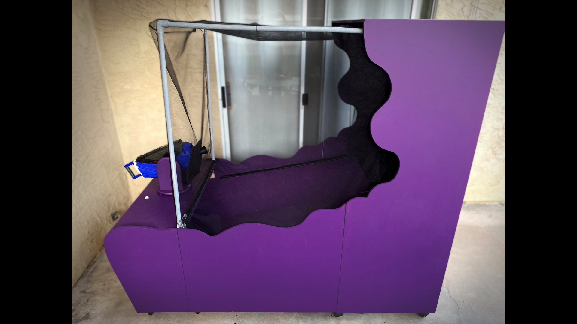

Hi Michael, in the end I had to abandon the vacuum approach. The hopper has a capacity of 100 balls and once those are used (takes about 1 minute) it needs to be manually refilled.
The rest of the project worked out okay though. Here is a video of the assembled machine:

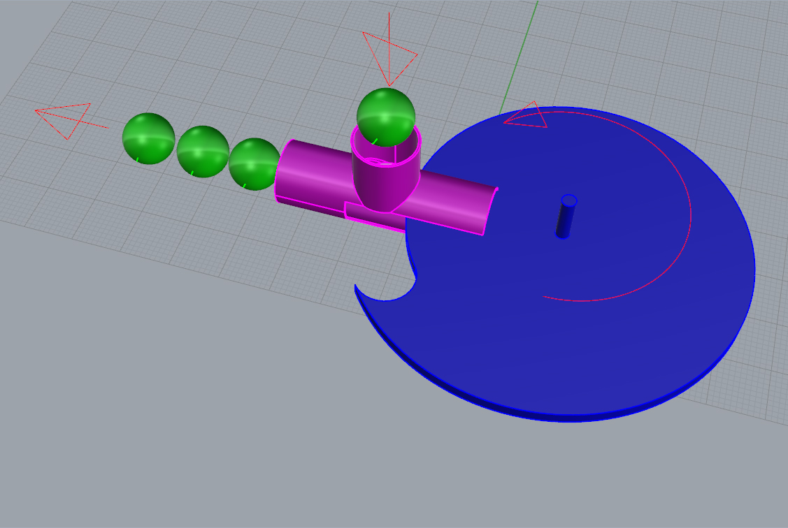

Solved a similar problem with a table tennis trainig machine. Its a planar scroll , which runs in a slot of a radially oriented t- tube. Now the side branch of the t- tube which shows against gravity has a funnel where the balls were placed in. The scroll runns under the funnel so at the minimum diameter positionned under the funnel a ball is falling into the tube/ scroll and when turning, the increasing diameter of the scroll forces it into the tube until it is once around and the next ball is falling into the scroll… so the system stacks one ball per revolution on the previous ones
Works fine…
Don’t think I know what a “Planer Scroll” is but inquiring minds want to know :)!
Ok for its difficult to describe this via text I made a quick sketch and hope this clarifies
Nice, I will be using that idea !!!
Glad I asked :)!
You can use an accu drill for testing. My training machine is up to 4 balls / second @ 12V with a geared brushed 24V Motor. And you eventually should think about a stirrer which prevents the balls from blocking each other in the funnel.
