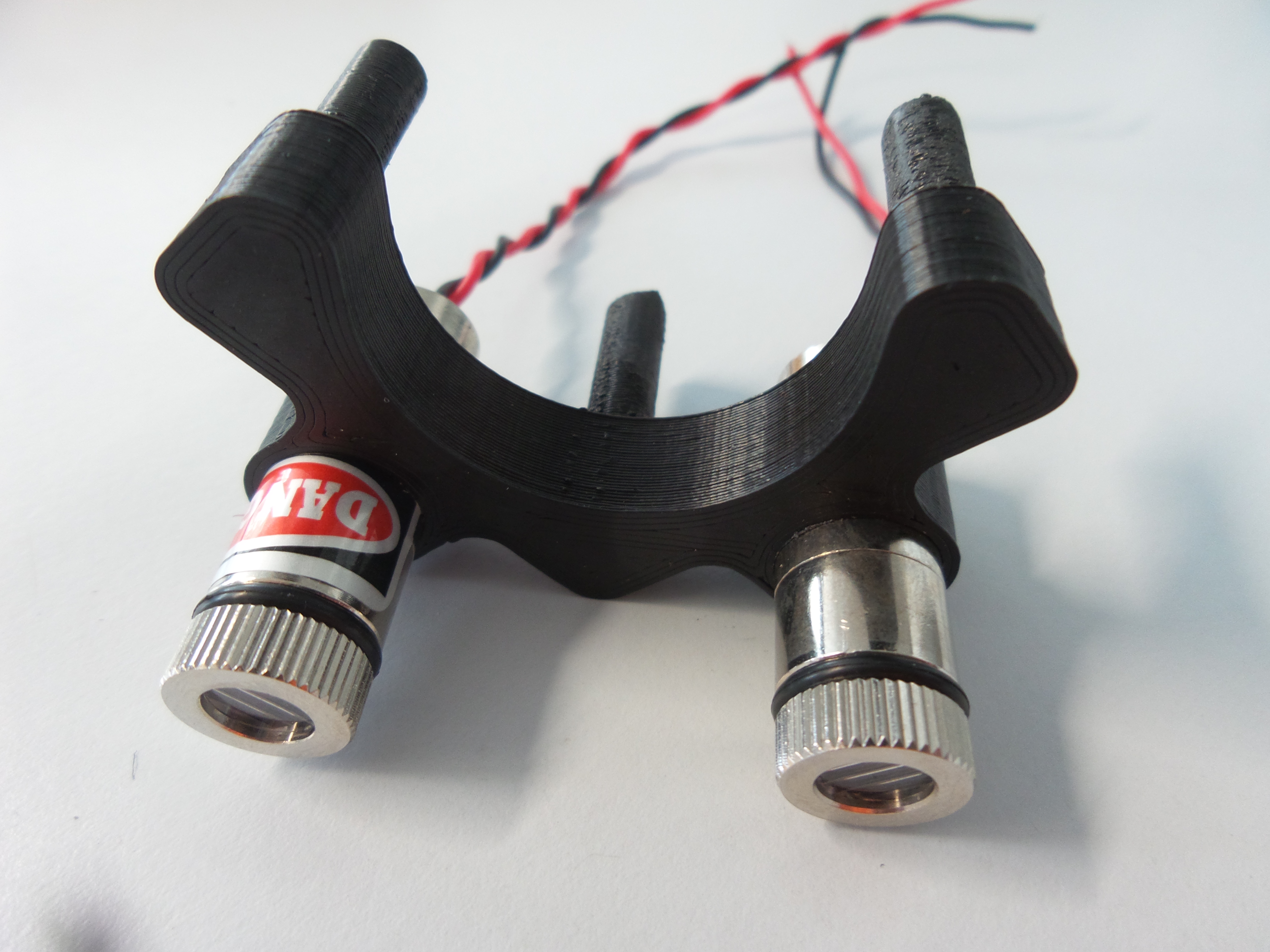

I’ve made this piece for our Lasersaur 5 years ago:
It’s two linelasers that are turned so that the line goes through the center. This way the cross is always at the center, no matter how far away the head is from the bed.
Aha, I am not the only person to have had this idea! That was indeed what I was thinking about. Thank you! :slight_smile:
Keep in mind that just cause the line lasers are aligned to the head does not mean they are aligned to the beam coming out of the objective lense. Most setups [unless perfectly aligned] are not perfectly parallel to the surface. Depends on how accurate you want the line lasers to be. :).
That’s why there are three rund bolts, to adjust the angle.
By the way, the black rings on the linelasers are rubber seal rings to stop the lenses from shifting/turning.
