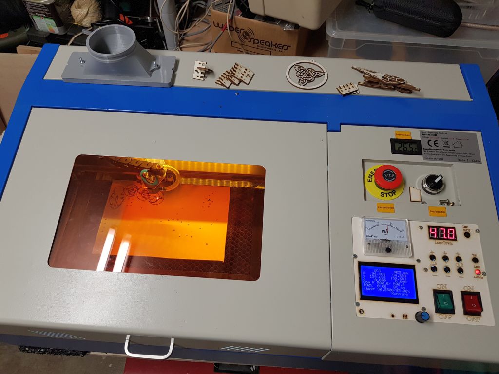

I installed a small digital voltmeter across the power pot (center pin, wiper, to ground). It gives a reading of the power setting before the laser is enabled. That, along with the analog ammeter makes the power setting easy and accurate.
Yes, been using that approach for some time :slight_smile:
An analog 30mA is fine for K40.
Percentage power indicator is nothing more that an indicator. mA is the way to judge how the laser is used.
