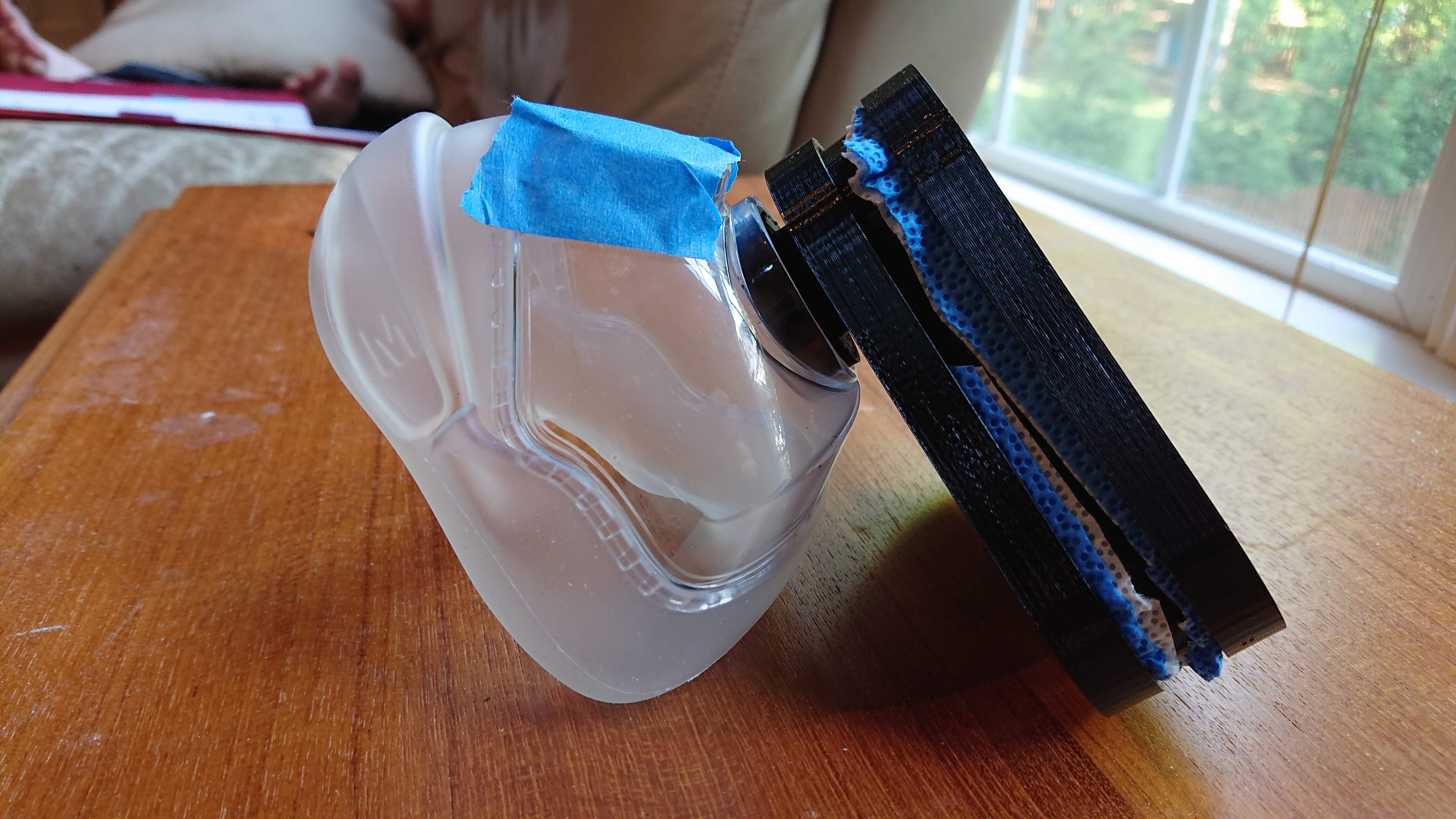

Here are pictures of it attached to a CPAP mask, with tape over the holes in the CPAP mask for a test seal.
The frames are meant to hold mechanically, but can and probably should also be taped together, front to back. Belt and suspenders.

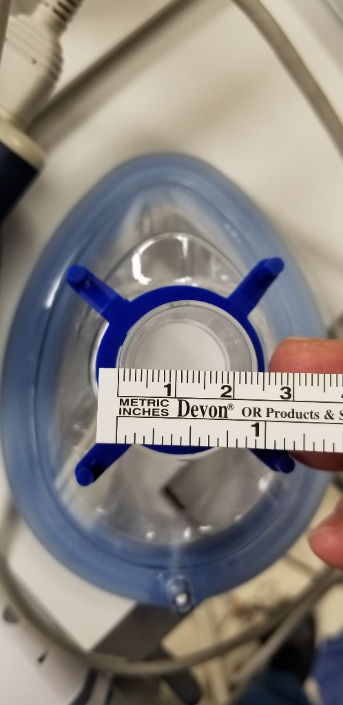

@HalfNormal do the anesthesiology masks, at least the ones you work with, have a 22mm outlet fitting, or inlet fitting? I’ve been working from other masks so far, waiting on arrival of an order of anesthesiology masks for testing, and hoping to get test article ready for N95 fitment tests at a hospital about an hour away this week…
Here is a measurement of a mask. if you adjust for the millimeter off it does look like it’s 22 mm

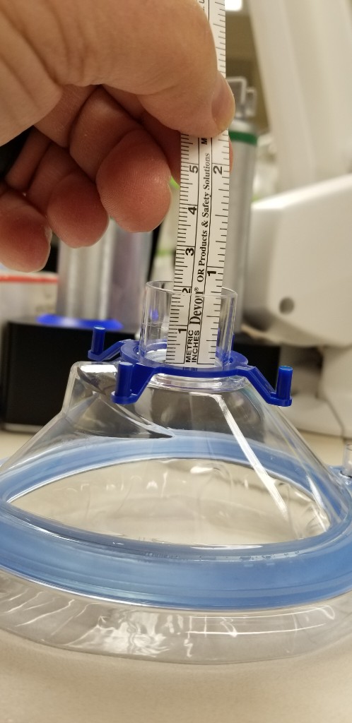

THANK YOU! Can you take a picture for me from the side, too! That would be very awesome!
Ask and you receive!:blush:
Thanks again! Is that dark ring for attaching straps fixed to it, or is it a removable part that I can replace with something optimized for different straps?
Yes they are for straps but pop right off.

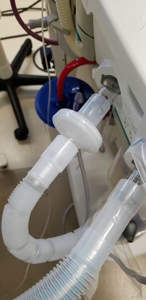

Here is where the filter is used on the anesthesia machine. On the air intake side.
We are now using this filter in addition up stream of the other one. It is being used only once then being disposed.
