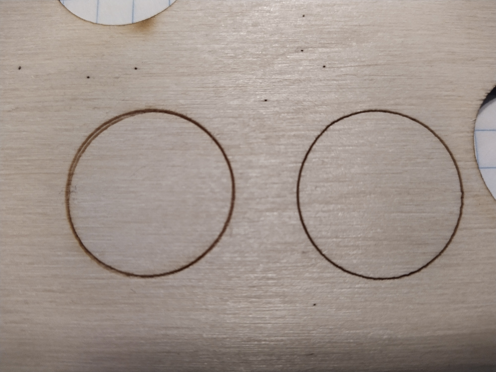

Alright folks, I’m back.
This issue is sort of similar to my previous one of a double image, but not exactly.
In the image below, the circle on the left is raster, the circle on the right is vector.
As you can see, the raster has a double line, but only in the upper left. The vector looks mostly fine (although I can see some very small jitters). But my main issue is the double line.

Does it go away when you raster in only one direction instead of on both forward and backward movements?

But, if it does only do it in one direction, what would that indicate?
I don’t run K40 Whisperer any longer so not sure where that switch is located. On Lightburn it is a setting within the dialog for the speed and power of the layer.
if it only does a single line when going in one direction then I would say to look at your belt tensioning or a loose motor or motor drive gear grub screw.

But, I went ahead and tried your suggestions since everything else didn’t effect it.
And lo and behold there was actually a screw loose that holds the x-axis stepper motor in place.
I have no idea how, unless just the constant raster engraving slowly shook it loose?

1st, check for any wiggle in the carriage. Grab it and twist it. Any wiggle means you need to adjust the wheels. Just snug! Wiggle will cause more grief than belt issues.

Grab the carriage and wiggle. It should not be any more than snug and smooth to slide along. No wiggle or wobble. Period. A loose carriage will cause more issues than belt tension!
