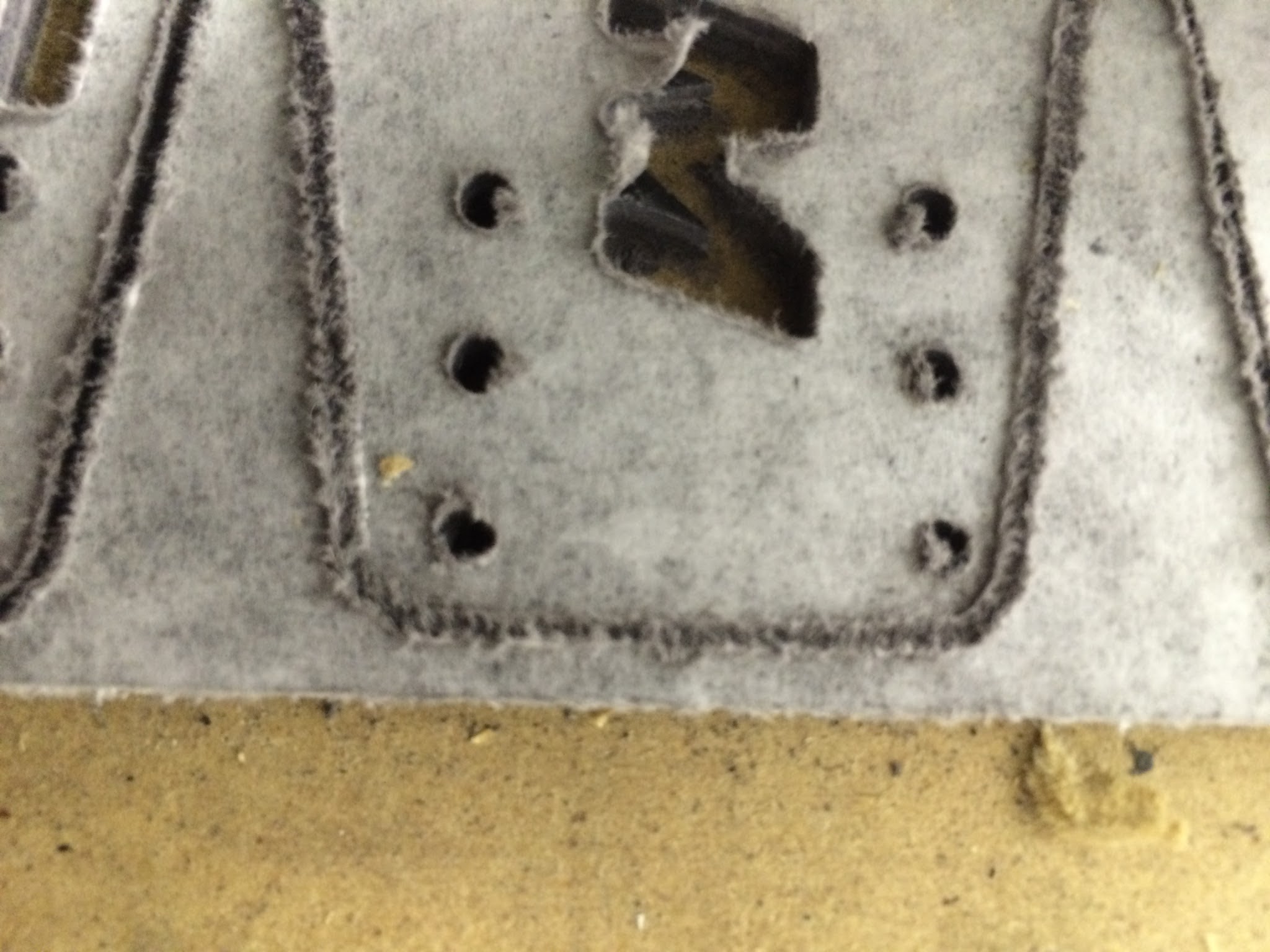

Any idea why I’m losing registration between operations. Sometimes, sometimes not. super drag though, can’t get anything done wasting material and time. Cuts all the first operations cuts and then scoots over a few mils and ruins everything. Please help!!

It is not obvious to me staring at your pics what you are calling “loosing registration” , likely because A. you know exactly what you expect and B. it is somewhat hard to tell with the surface paper still attached.

Actually, now that I look at this more, I don’t think you’re losing steps. I think you’re on a belt-based machine and you are seeing the slop in timing belts. Those little circles not being real looking circles are telltale signs of timing belt mushiness.

I’m cutting 1.5mm G10 fiberglass sheet double up with the paper comes to 3.5mm I’m cutting 4.2mm with 6 passes of .7 each at 150mm a minute. Seems pretty slow to me. My machine is a belt driven OX from Open Builds. you can see how the outer cut is shifted over a few mm. I think its my PC dropping steps or something like that.
Ah yes, now I see it. I agree, that is very conservative speed and depth. One Gcode file for all parts? Do complete parts get cut one at a time, or do all holes get cut, then go back and cut the outlines?

Well I was trying to cut a field of parts at first. All the holes first then the outlines. It would make through the holes fine and even through one outine but when it went to these parts it would shift over and ruin the whole run but two parts (double stacked) Now I’m cutting one part at a time and getting the same thing, I wish I could choose the order of cutting and make it all one operation seeming how it’s between operations that it shifts over.

I’m using the Quiet cut spindle from Open Builds and it’s not very heavy compared to some of the Bosch routers I see attached to these things. Turned out a Y belt was loose so I tightened it and I slowed the rapid to 500 and I’m on my third cut, first two were successful!!!
