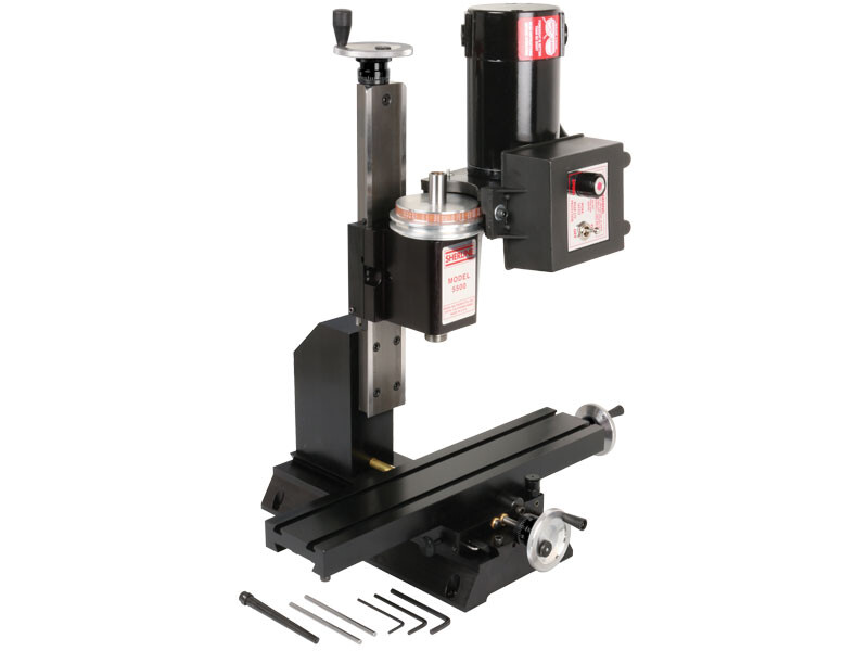

This is for a Sherline, which has a pretty easy to swap head/spindle unit. Motor is not tightly integrated. I could replace it with a different motor and have thought about buying a small spindle unit and replacing the spindle with a pulley to drive my current spindle. It’s frustrating having the motor hanging off to one side of the spindle. It’d be really nice to have an integrated unit so the weight is in line with the spindle. On a mill this light, that matters!
Oh, I had no idea the sherline did that. For others like me, here’s a picture:
I don’t see how you do a drawbar spindle with the motor’s axis aligned with the spindle axis, unless, I guess, you give enough space to work the drawbar and use an idler pulley set to the side?
