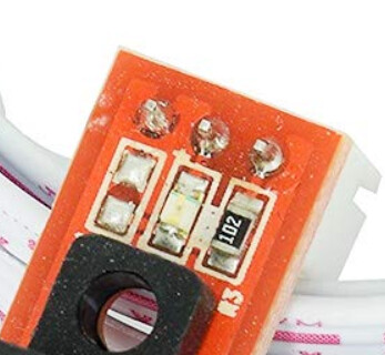

Hello all,
I’m looking to build a sensor for my 3D printer to check the filament is moving.
I’ve bought some optical end stops, and printed an encoder wheel and housing.
I’ve wired the endstop signal to D3 of a NANO, but my code constantly reports the digitalRead == LOW. The red light of the endstop is behaving correctly.
Pin 3 is set to input on the code - and my job is a programmer - so my code is reliable.
I’m wondering if I need a resistor in the circuit ? I’m no particularly proficient with circuit design.
I have tried to use the internal pull ups but no joy.
Anyone have any advice please?

It looks like it has a resistor and an indicator LED on it. Start simple: does the indicator LED turn on when you interrupt the path?

Without a schematic I’d guess it to be an open collector interrupter. Used a home brew version of this on my little CNC machine. Changed to hall effect after junk from the spindle flew it’s way through the interrupter and triggered an error.
I would simply pull the pin to ground, configured as normal. It should detect that and probably fault if it’s trying to home.
Some of these were not a ‘wired or’ configuration, although from the photo, it could be… I read the link, which didn’t say much. There were a couple of comments, translated from German, and indicated he had a problem because the output signal went the wrong way.
It’s an open collector, but I’d guess the resistor and led are on the b+ side with the emitter to ground. So if the output is off the collector and no interruption of the IR beam the photo transistor conducts pulling the output low. This would be the normal state (similar to ‘NC’ on a mechanical switch,) the opposite of what most limit switch inputs are looking for. You can switch what most controllers are looking for but you lose the ‘wired or’ configuration benefit.

I checked this morning with a test meter, signal is outputting 2.2v when triggered.

2.2 V is marginal for an input to a Nano if there is no pullup. [is this measured when connected to the arduino?]
I looks to me like the Optocoupler has an open collector that is not pulled up.
No idea why the Ardu internal pullup is not committing the output.

Without it connected to the ardu. you can add a pullup (1K) and read the voltage at the output when interrupted if that give you a full swing of the voltage you know the sensor is good and you problem is on the ardu side.

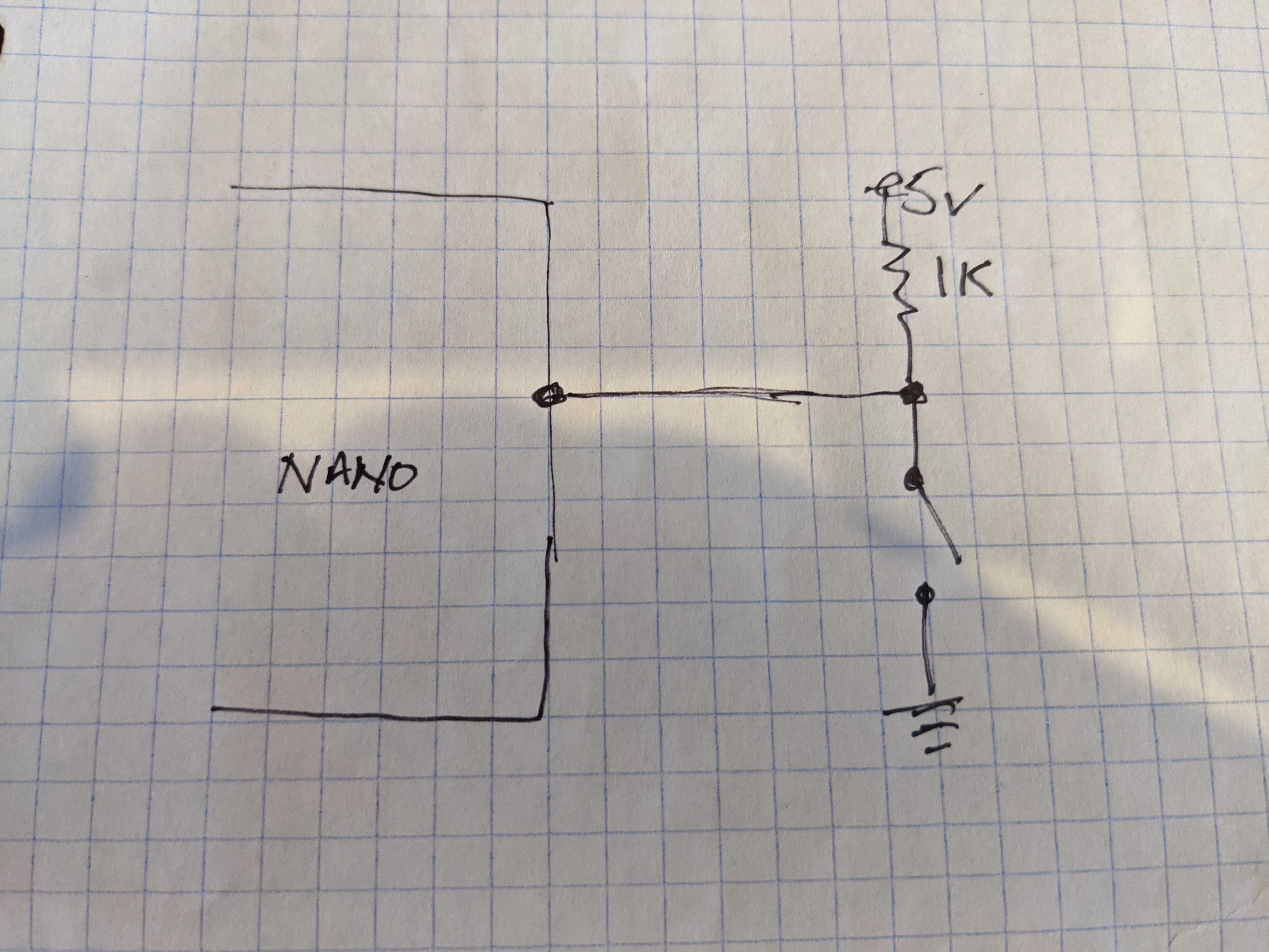

You could,
Add a switch in place of the optical sensor using the same port and code.
If it works its a sensor problem,
If not it’s a code problem.
You could do this with and without [internal] the pullup
