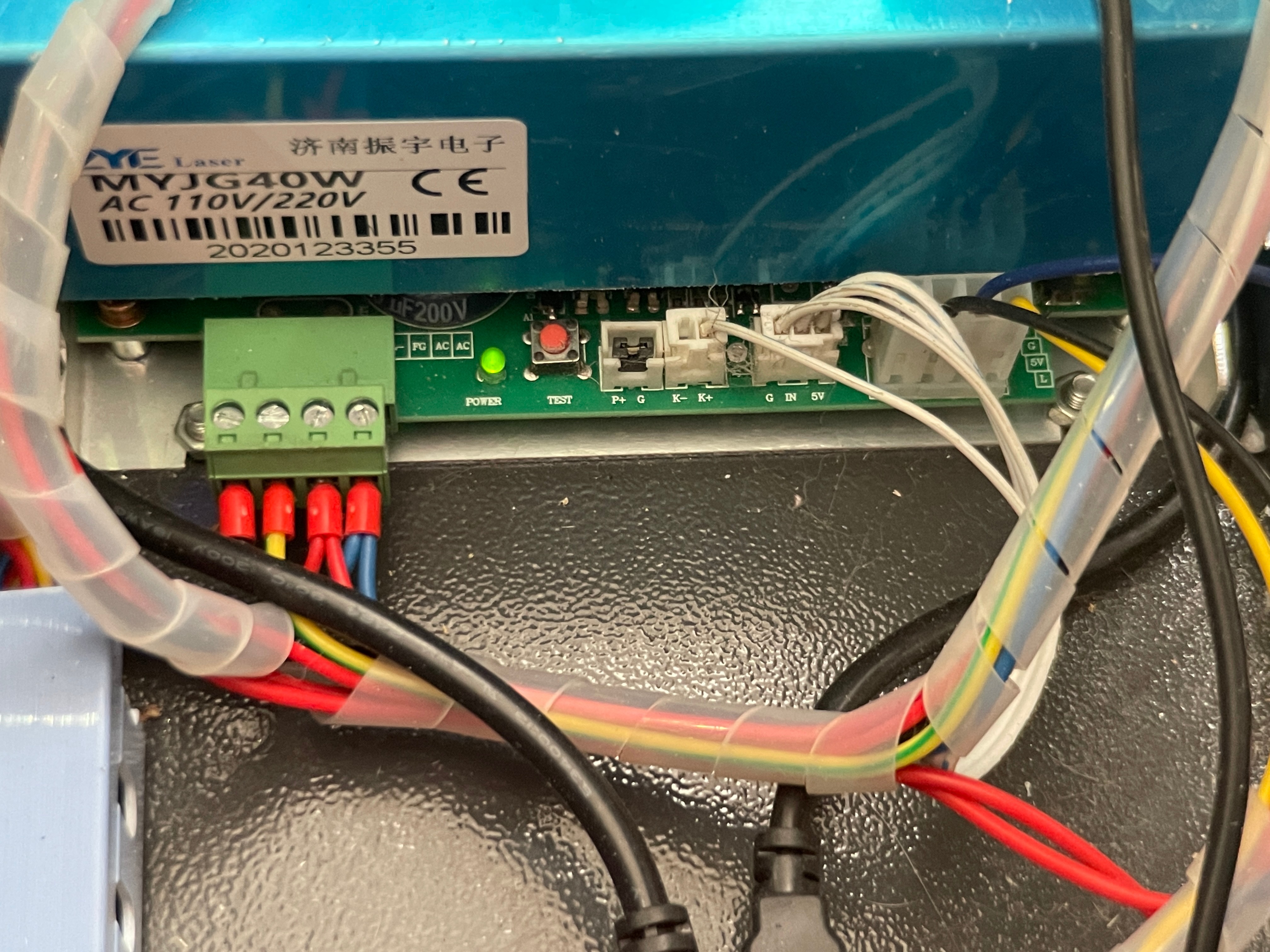

Heres what i think so far. On my current one i have k+ and L which connects to switch laser control high and low on new board but Im not sure what goes where.
G on original to the Input control signla 0-5v on new one
IN, and 5V will connect to the blue wire on original and all to the output power 5V.
On the left side the ac/ac/ L N is pretty easy but the far left on new shows FG in letters and diagram shows ground on the new one. One the old one theres two different sets of wires on left showing FG and signal to neg so not sure exactly what goes to what there. If its the yellow and black together or yellow stays and black is somewhere else.

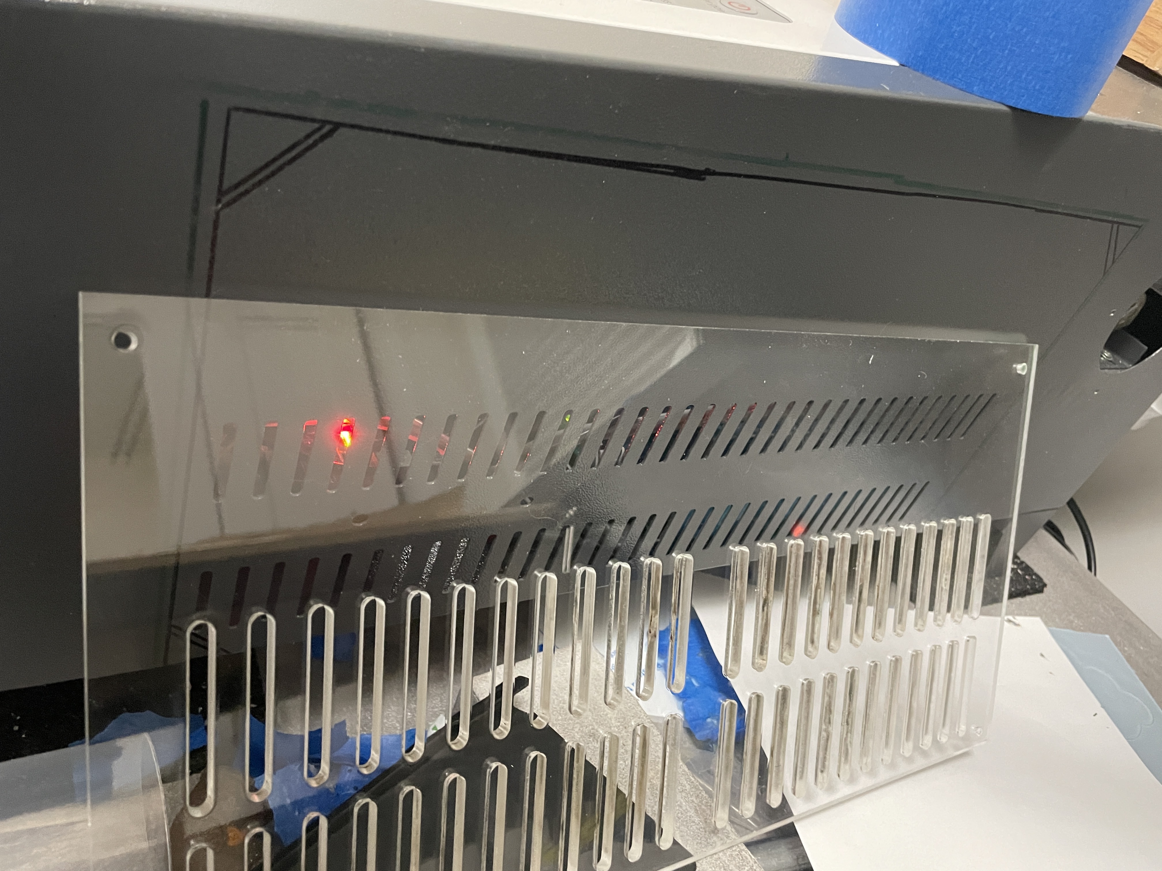

Im shooting thru 6-8mm clear acrylic. Colored is fine but not clear. Takes way to long and too many passes at times for things. Other materials the same. Im doing double passes to get things done how I need them. Air assist is fine. Some items burning until I added a different fan and much better. I had help setting the bed height for proper adjustment. I need to cut with a single pass tho not double. And wood doesnt cut easily without burning. Someone else my wife knows uses and 80w for same thing with zero issues and much faster.

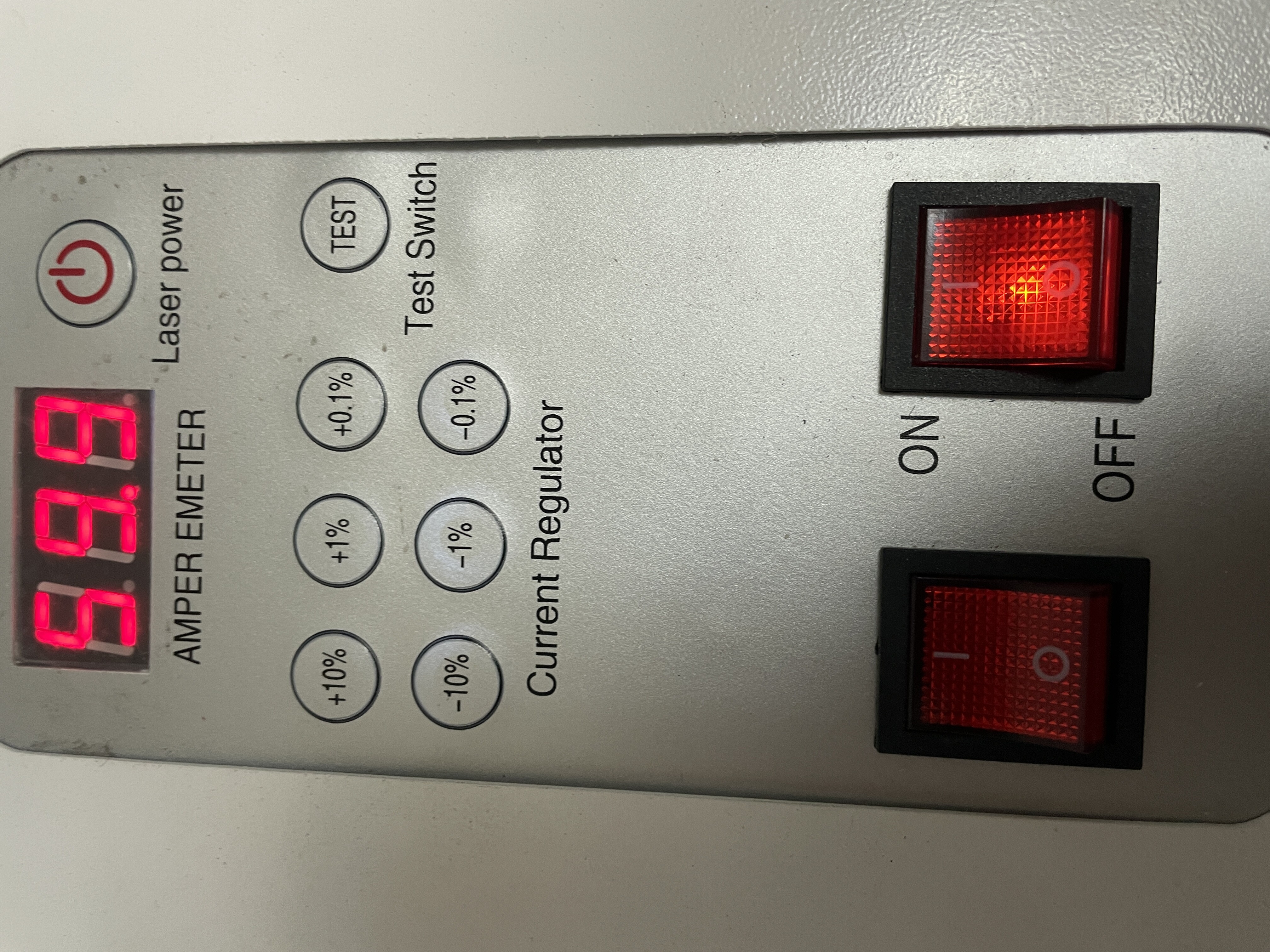

Please post a picture of the control panel you plan to use.

#1 & 2: where are the current wires on the current LPS connected to? These are the Yel, Blue, and Black wires on the rightmost connector.
#3 exactly where on the C3D board is this wire connected. How is that output configured in the smoothie configuration? Attach config file.
#4 this is not a from-to wire. This wire must be added and this is where you would wire in your interlocks… which you need for safety!
#5 This connection may be a challenge. The digital panel provides a ground on the K+ connection when the Test Switch is pushed.
If we wire the L signal to the new supplies TL then the only fire pin that is left is the TH pin which requires a high (5V) to fire. In other words, the K+ is not the right level to connect to TH.

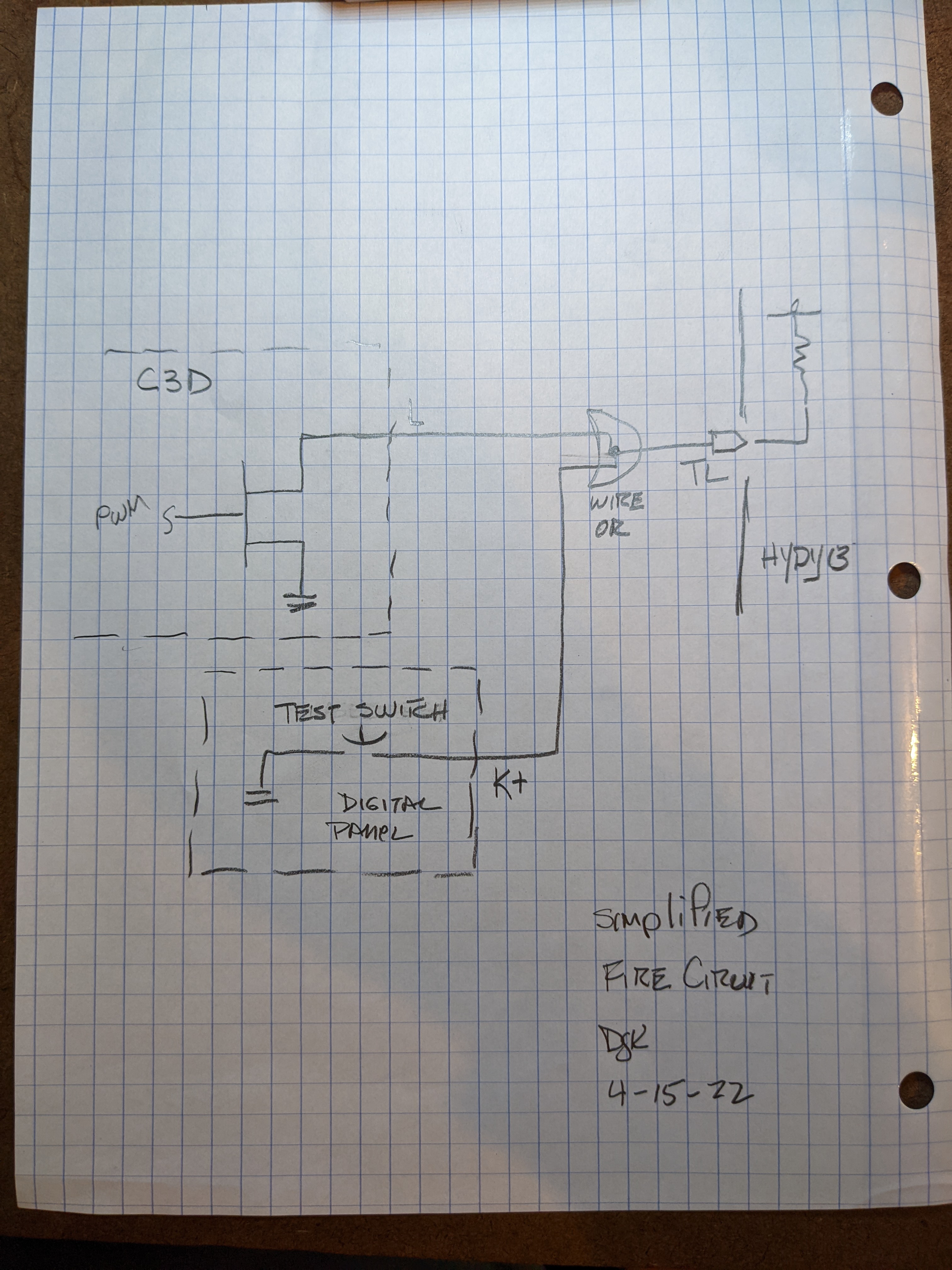

b. connect the old K+ and the L signal to the TL pin. If the L signal is connected to an open drain MOSFET on the C3D then connecting L and K+ (wire OR) both to TL should work. See the simplified drawing below.
I have never wired a machine this way so I do not know if there is something at the TL input or K+, L outputs that would create a problem. For instance, when L and K+ are not asserted will the TL input pull up the signal or will it float [does that matter to the LPS]. Or is there some condition that I do not see where L and K+ will interact?
To test when implementing this schema we can first connect K+ and verify that the TL pin will pull up properly and then connect the L pin.
c. convert to an analog panel. An analog panel provides better visibility & control of the machine’s power when a ma meter is included. In this schema, we can wire the discrete switches in a way that we can use TH.
From-to diagram
Simplified fire circuit

  1. many many K40 users over drive the cheap tube by using the digital display and not knowing they are over driving since they have no Amp meter installed. So tube wear is accelerated and performance is greatly reduced.

bty, if using a Cohesion3D, like in my case, for the questions “1 & 2: where are …” 5v: NC, and wire connected to G goes to G at DY13.
and for K+, it in fact goes to TL
