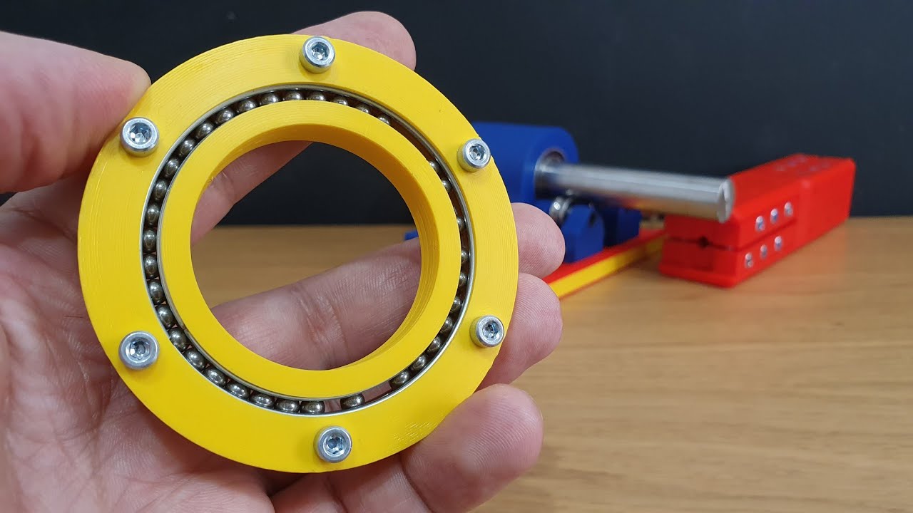

H-A-D featured this video recently, where carefully rolled wires were formed for the bearing races, and a bearing cage helped.
BBs aren’t made from the same kind of steel as bearing balls. I would expect spalling and/or fretting if the BBs are allowed to rub against eah other. A bearing cage (as shown near the end of that video) would be critical for even minimal bearing life if I’m right.
