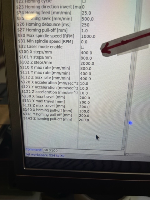

i set $100 X400, G0 X100
This is what got. But it ran rough, not smooth. Pictures
what do you mean you set $100 to X400? it should be set to 400
Can you do what is mentioned above?
$100=400 in command line., because it was at X100=2000
Given the pictures you are showing I don’t think you are understanding what it means to send the command “G0 X100” to the controller otherwise there would have been some proof you did this in the pictures.
Do you see the little text box at the bottom left of your Bcnc windows where it says “Command:” next to it? There is where you type in “G0 X100”. note: do use capital letters and don’t seen the quotation marks.
I don’t know why you keep putting and “X” in front of things which are not supposed to have it but please take your time and post correct responses. $100 is not the same as X100 and since we’re not playing horseshoes, ‘close enough’ does not count and yes it does matter if we are to understand what you are doing and why things are not working as you expect them to be working.
sorry type O., my mistake
changing $100,$101,$102 like he siad do, than G0 X100, in the command line

The DM542 stepper driver dip-switches set steps/rev for 1.8° motors (which you use), so your calculation would just be: 2000 steps/rev / 5 mm/rev = 400 steps/mm
So set $100…$102 to 400 and check if a 100mm move (G0 X100) realy moves 100mm

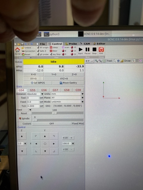

OK, so you have $100 set to 400.0 and $100 is the setting for X axis steps/mm. Great
I see you have “G0 X100” in the command window…
Have you placed a mark or something do indicate where your CNC mill head is relative to the work area?
Can you measure from that mark to where the CNC mill head stops after you hit the Enter key to send the command to your controller?
Can you tell us how many millimeters the CNC mill head moves?
100mm
but moving lettle hard
Great, so now you know what setting for Steps/mm to use for all of your axis which use those same screws and stepper motor settings. Like maybe your Y axis?
See if increasing your X max rate helps improve movement using:
$110=2500.000

$110=2500.000
it to mush it jump
ok
$110=1600 mush better
ok
$100=350.0
$110=1600
$120=10

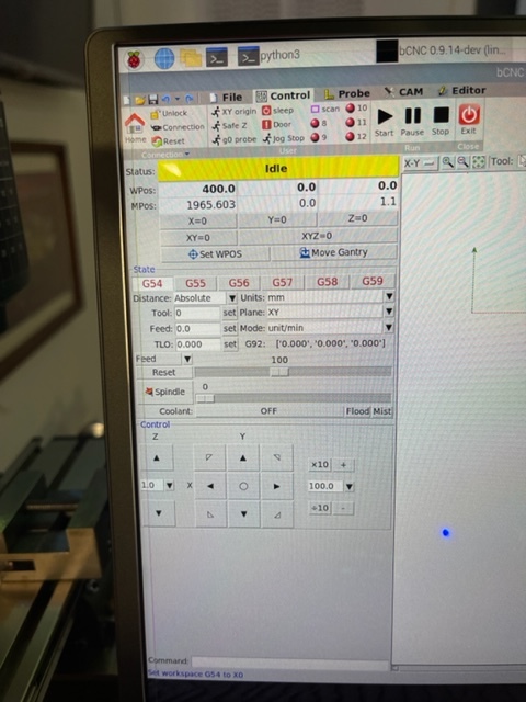

Measure exacly 400mm
$100=350.0
$110=1600
$120=41.8125
sound mush better, still need little bit more calibration. almost there :grin:
WHY are you changing the steps/mm( $100 ) when you said it moved 100mm after giving it the command to move 100mm( G0 X100 ) with a setting of 400 steps/mm? WHY NOW 350? This makes no sense.
the reason why i change it, it because X Axis is 400mm. not 300mm
So if change back to 400, when jog X from one end to another end i get 300mm
So when change to 350, i get Exaclty 400mm. from 0mm to 400mm

You can not have it both ways… If you set $100 to 400 steps/mm and it moves 100mm when you command it to move 100mm( G0 X100 ) then the setting is correct. If you set your X origin to the farthest to left it can go( X0 ) and then command it to go 400( G0 X400 ) and it hits the other end before reaching 400mm then your working space is not 400mm and you have to figure out why. You don’t get to change $100 to something smaller than 400 steps/mm just so you think it moved 400mm because the display says it has moved 400mm.
Correct, i understand now.
these’re setting i hive now.
$100 400.000
$101 400.000
$102 400.000
$110 1600.0
$111 1600.0
$112 800.0
$120 41.8125
$121 41.8125
$122 10.000
