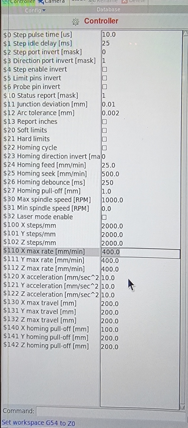

It looks like your controller is an Arduino Uno with a CNC Shield running GRBL Firmware. This firmware get configured with $ commands, as shown in your first picture.
With $100, $101 and $102 you can configure the steps/mm for the axes X, Y, Z.
1605 ballscrews make 5mm/revolution. Now you need to know how many steps per revolution your motors make and how many microsteps per step the drives make. Then you ca calculate the needed setting.
The Proxxon MF70 usually have 1mm/rev., so if the $100 value of 1600 on the screenshot was from the proxxon and the steppers are 200 steps/rev, then your drivers are set to 8 microsteps/step.
For the 1605 ballscrew this would result in 200 * 8 / 5 = 320

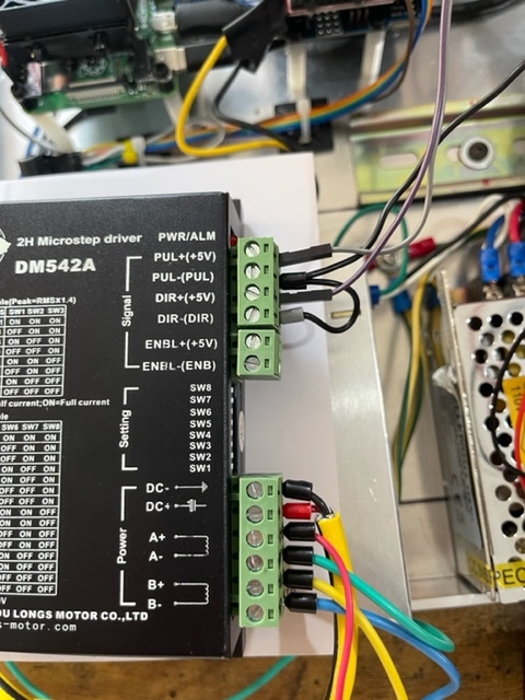

hi, cprezzi
I remove Stepper Drive DM542A, And replace it with DM542A Stepper drive.
from Driver DIR + to cnc shield X-Step
from Driver PUL+ to cnc shield DIR
DIR - GND
PUL - GND
ENBL + (+5V) To cnc shield ENBL
ENBL - (ENB) to cnc shield GND
When i try to jog Z, But the stepper motor just humm.,
help? what im doing wrong?

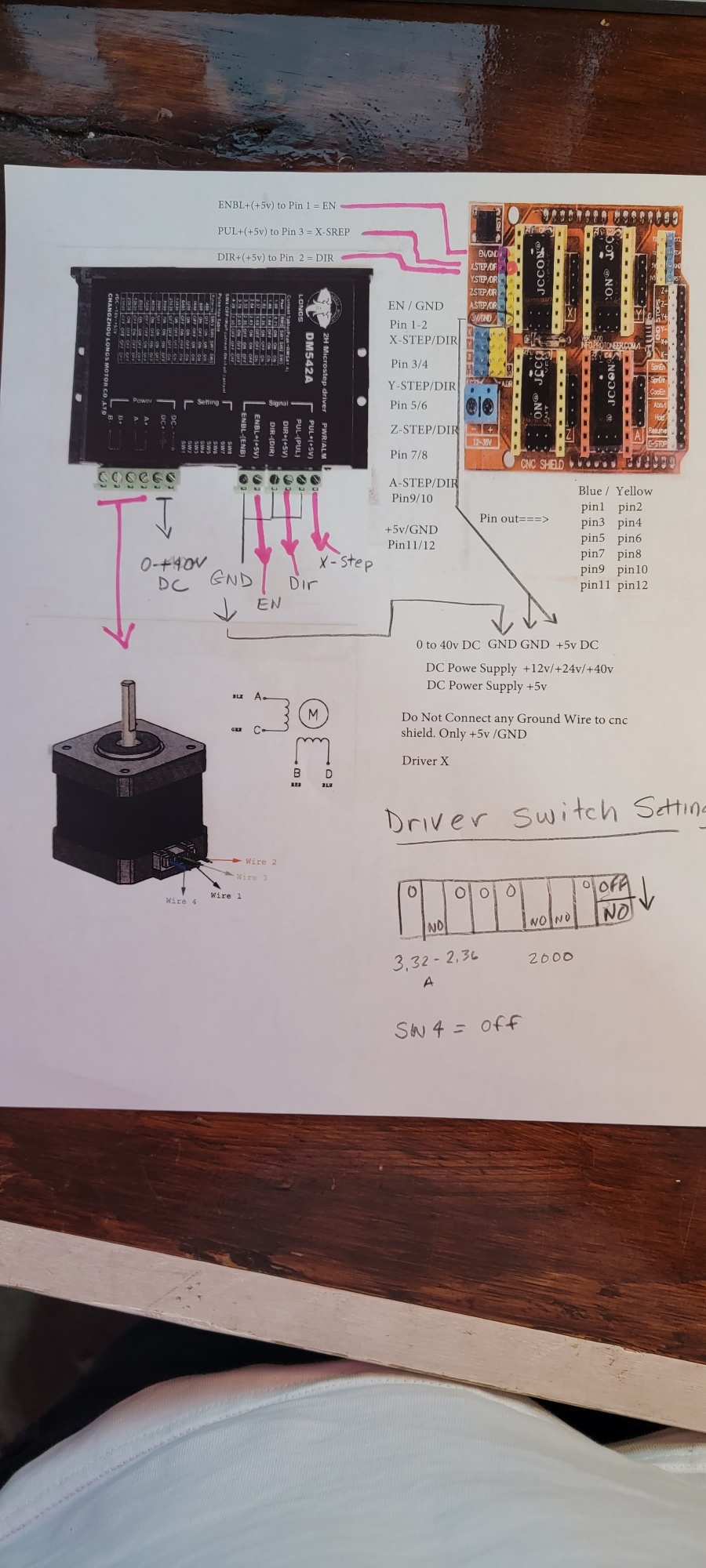

hello.
Got it, working. here is the proper wiring diagram.
Stepper drivers GND’s go to power supply. And ENBL to CNC shield. The EBNL- (EBN) also power supply. Not to the cnc shield GND.
Your signal ground should be the same ground that the signal generator is using… I would not go to the power supply with THAT ground.
Your controller should have the same ground as the power supply unless you are powering it with a different power supply. Again, then the signal ground should be the controller ground.
Also, Isn’t the power to the stepper motor driver, the high power connections using also using the Power supply ground?

I when with Stepper Drivers LongMotors DM542A, They’re mush better then TB6600 drivers. I got everything working.

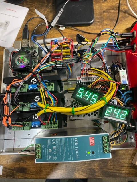

Some photos.
You probably notice on the photos, The power supply Im using 24v@5A to drive Stepper Driver. I order a 24v@10A 350W.
If you don’t mind me asking some questions.
Do I need configure bCNC software for the Stepper Motor in configuration setup.
My stepper motor=> Longsmotor Model: 23HS9430B 3.0A(u) 1.8deg/step. On Dip switchs are set to Pulse/rev 2000 & 2.89A @24v

did you understand what I said about the ground wires?

So it’s a nice looking build but you really should stop and start reading about what is going on both electrically and on the control side.

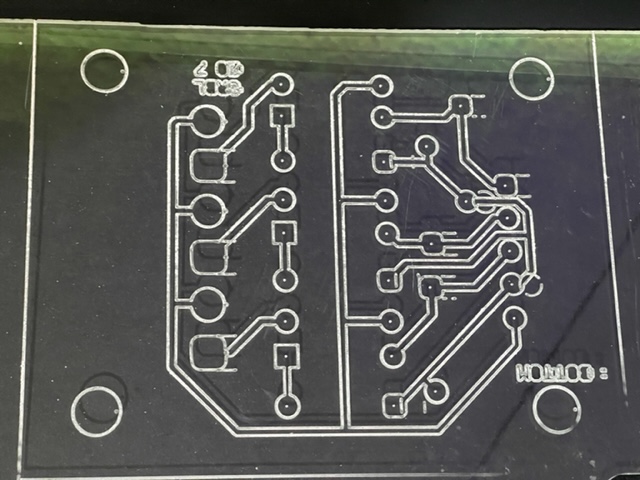

So here is a sample of a run.
IMG_1008
thanks for the help.
So i change $100=2000,$101=2000,$102=2000 in the controller setting.
$,? the value to change 200*8 / 5=320 ?
thanks
You can calculate the needed steps/mm like this:
  • {axis steps/mm} = {motor steps/rev} * {driver microsteps/step} / {ballscrew mm/rev)
The DM542 stepper driver dip-switches set steps/rev for 1.8° motors (which you use), so your calculation would just be: 2000 steps/rev / 5 mm/rev = 400 steps/mm
So set $100…$102 to 400 and check if a 100mm move (G0 X100) realy moves 100mm

what i have set now below, moving very slow
G0 X100 Yes it did 100mm, but slow. after changing from 2000 to 400
$100 X 400 when from 2000 down to 400
$101 Y 400 when from 2000 down to 400
$102 Z 400 when from 2000 down to 400
$110=X 400
$111=Y 400
$112=Z 400
$120 =X 10
$121 =Y 10
$122 =Z 10
The values for feed and accelleration are dependant on your machine.
I would suggest to start with 2000 for $110…$112 and 1000 for $120…$122.

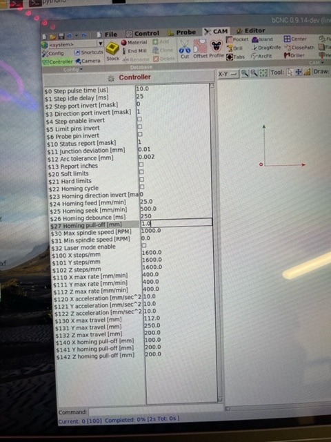

I didn’t make any changes to the controller settings it was the original setting for Nema 17 motors Stephen motors.
$100=1600
$110=400
$120=10
So like he said, change from 1600 to 400.

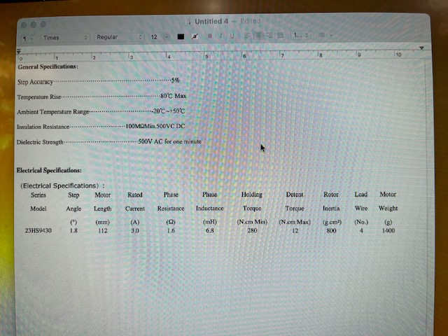

So my stepper motors are 23 Nema 1.8/4.5A 425oz. On the stepper driver dip switches are set to 2.8A @ 2000 Pulse/rev
The ballscrew are 1605/0.5
Stepper motor specification: look pics.

I did a couple of changes to controller setting.
Try this numbers,
$100=400
$110=800
$120=10
And this time, Z moved from Z- to Z+, got a reading of 300mm
Theses settings came from my old cnc 6030 Mach3 setting.

If you do what the people who are trying to help you ask you to do we can move you forward. If you keep changing other things and talk about other problems it will be a very long road to finding solutions and you might lose some help here.
If you set your controller settings to what they were when you took the picture of your screen (here-Bcnc 0.9.14-der linux PY 3.92/ configuation cnc machine - #14 by lloxley016 ) and then change only $100, $101, $102 to 400 then restart your machine/controller.
Next jog the machine to a spot where you can measure 100mm distance in the X axis.
Now send the command, G0 X100 and physically measure who far the head moved and report back what happened.
