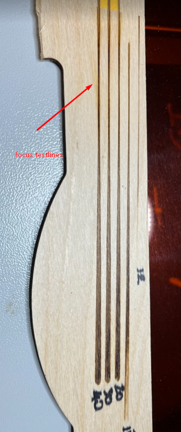

new tube focus test lines: at 12 nice and fine line. anything above that, very wide lines (20mm/s speed)
never used to have charing on the surface of the part before.

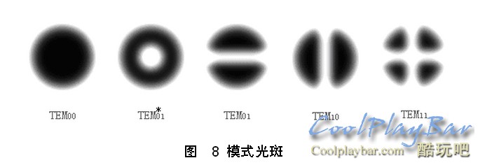

Hard to tell from the photo but it looks like you have a doughnut shape beam out of the tube…
The tube should resonate in a TEM0 state…
If that’s the case, I think your tube is dying…
18 months is relatively short, I would think… IMHO you need to set the maximum current at the lps.

Seems like the output from the end of the tube is pretty much a confirmation that the tube isn’t resonating properly… All of these ‘burns’ have a low power area in the center… assuming this is the replacement…
dots before mirror 1
What else could you attribute to that transverse state…? lps?
I’ve always been told and found that without TEM0 transverse state, the tube is history…
As always your thoughts are appreciated in this area … :grin:
:smiley_cat:
OK, I see your point, the replacement tube might have come resonating in TEM01* (donut mode). Just bad luck. But the seller should replace it if that is indeed the case.
@Tom_Geerts are those examples from your original tube or the replacement?
The examples are from the replacement tube
Sorry I missed the red inscription before. I agree with @jkwilborn — your new tube does look like it is resonating in TEM01* mode. :frowning:
