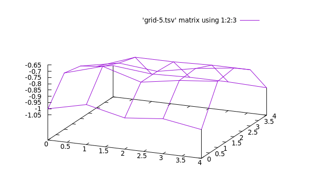

This is the state of low-price consumer 3D printing, and is why measuring flatness of the bed with a sensor like a bltouch and then compensating for its lack of flatness is so common. What you got might actually be better than average for low-end equipment. Also, the rolled aluminum used for heat beds has internal stresses that cause it to warp when heated. This means that what you measure cold will not be the same when it heats up. That’s why we heat up the bed before measuring how flat it is.
You can choose to put up with a slightly unflat bed one way or another, or spend significantly more to get a flatter bed. You won’t get a flatter bed without going to cast aluminum, generally speaking.
Options, listed in order from least to most expensive:
  • If you printer didn’t include any form of height probe, you can, by rebuilding your firmware to use G29 Mesh Bed Leveling [sic], also probe manually and store a height map in a grid across your bed and use that to compensate. How fine a grid depends on how accurate you want; you can do up to 9 X and 9 Y stations, if you really want to do 81 measurements at least once.
  • If your printer came with a bed height sensor (like a bltouch), you can use it to probe the bed for bilinear automatic bed leveling [sic]. This is easier than doing it manually!
  • You can augment your bed with a cast aluminum “bunk bed.” An intermediate step I took before I started over was to buy a piece of 1/4" cast aluminum which I clipped directly to the wrought aluminum hot bed of my first printer, and turned down acceleration in Y a lot; I traded off some speed for a flatter bed.
  • You can replace your bed entirely with the same cast aluminum, in which case you also need a heater. You can use either DC or AC heaters. These are usually heater wire embedded in silicone. It is best to protect both, but especially AC, with a TCO (thermal cut-off fuse) thermally bonded to the silicone that will permanently open if the temperature gets too hot. Note that TCOs by their nature should have their terminals crimped, not soldered, to the wire… :smiling_face: I eventually went this route on both of my printers. But it took a few years.

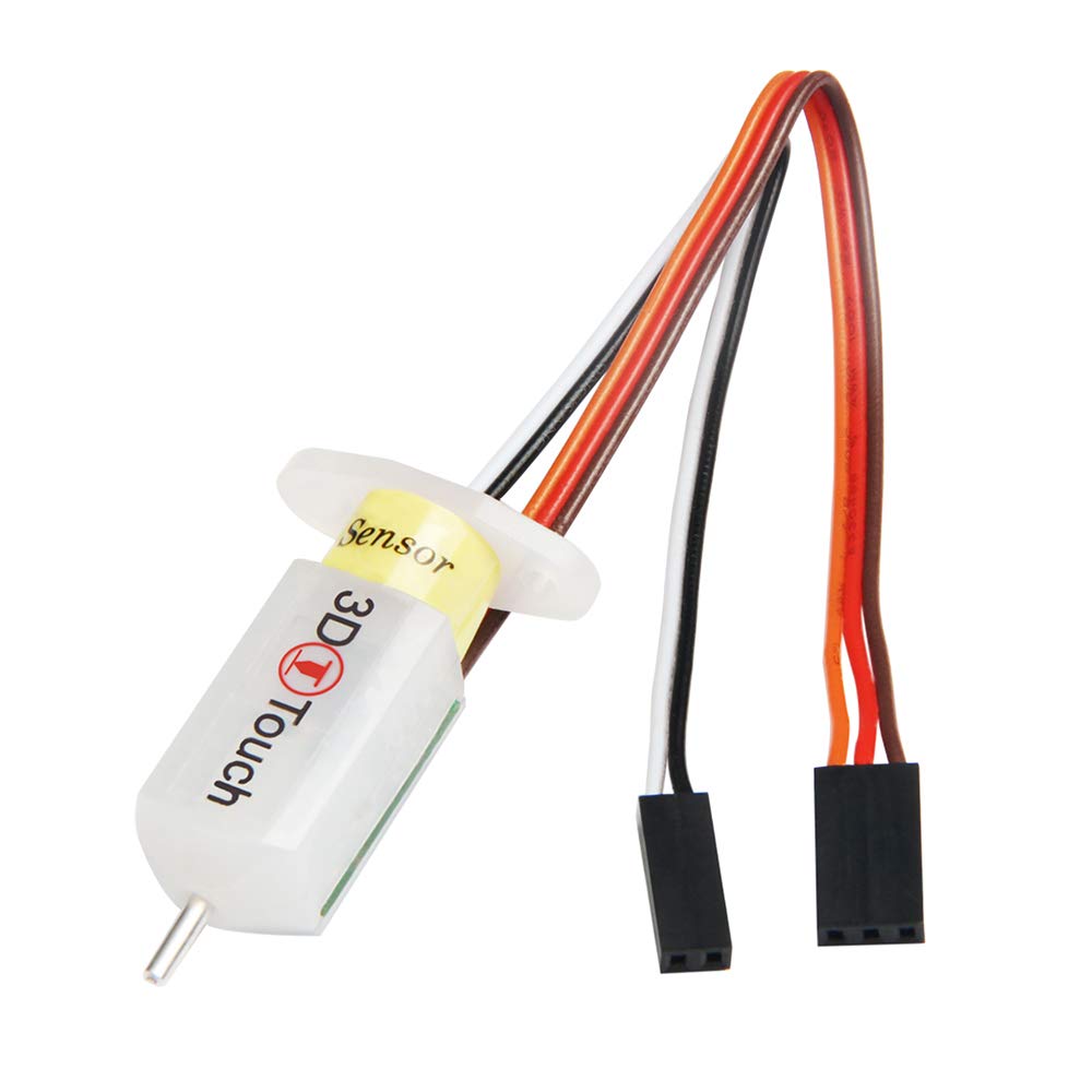

Thanks for the info. My machine didn’t come with a level sensor but it’s prewired for adding a bLtouch. Looks I can get a Geeetech bltouch touch from Amazon for $21 with a 30% off coupon.
