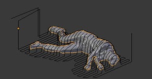

For bas relief pattern designs there is also Blender 3d. A free 3d modeling program suite and one of the programs I use. It is honestly overkill (could be called beginner software since its free) and the learning curve is a straight wall compared to some other programs, but if you master the basics it really opens up an entirely new level of models. Digital sculpting along with classic polygonal model.
It can generate STL, OBJ, FBX files which then have to be converted to gcode.
There is a blender build (BlenderCAM) for generating gcode but I have never used it.
