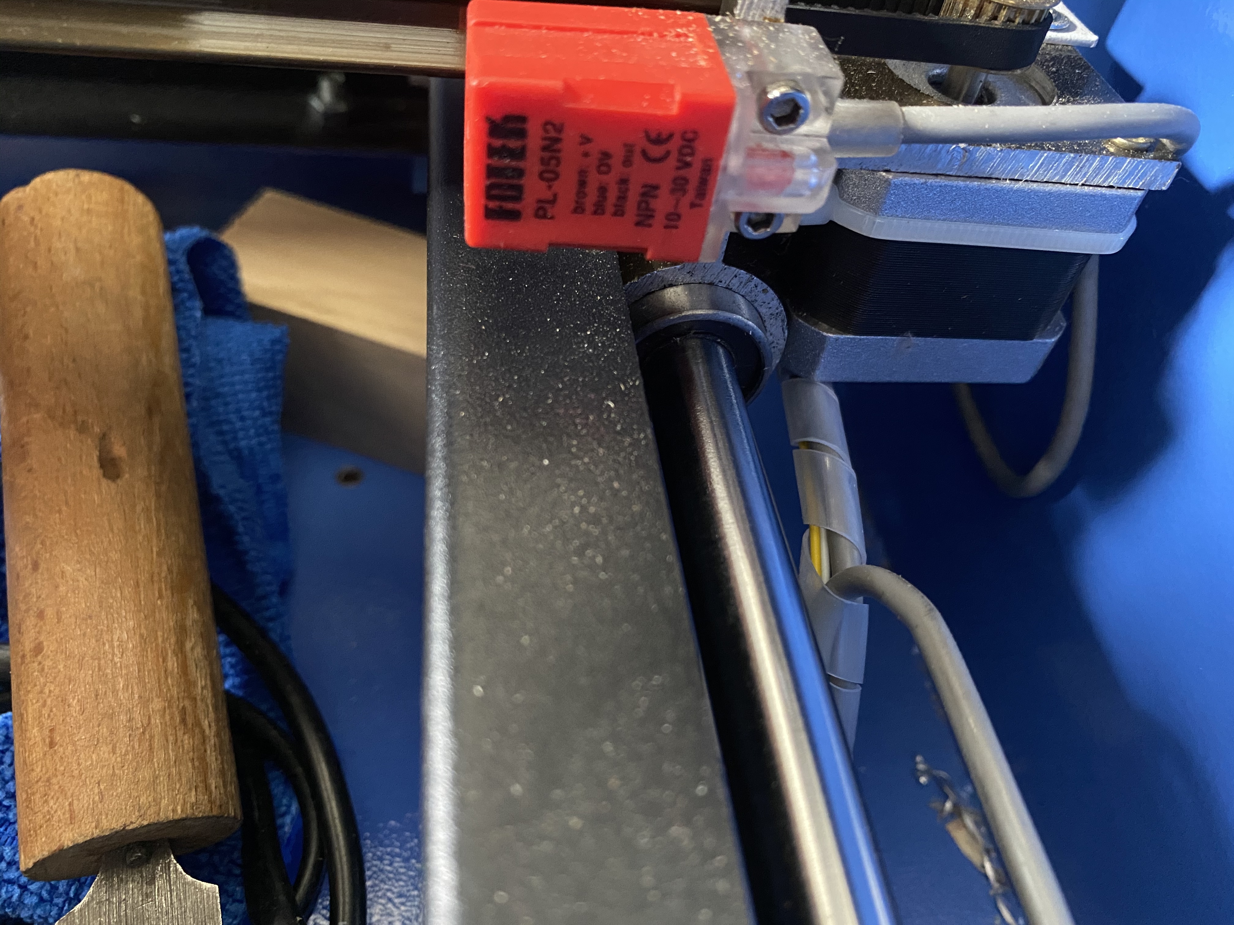

Looks like the part number for the sensors is as follows: PL-05N2

The PL-05N2 requires 10-30V which I do not think is available on that white high density connector?? You will need to get the correct voltage from somewhere on the board.
I can not make out the manufacturer name but I can make out the 3 wires:
Brown = +V
Blue = 0V
Black = output
10-30VDC

FYI, that sensor is a Normally Closed(NC) device which means it will be biasing the NPN transistor inside the device pulling what’s connected to the black wire to ground. That way the endstop circuit is triggered on a positve endstop signal so if a wire breaks the endstop gets triggered AND when the sensor is triggered with metal nearby the endstop circuit is triggered.
I had not seen/noticed the C3D board had that high density socket which you had jammed incompatible end stop pins into. As you can read on the sensor it requires 10VDC through 36VDC to work so I hope you verified you have 12V or 24V on that connector where you put the brown and black wires/pins.

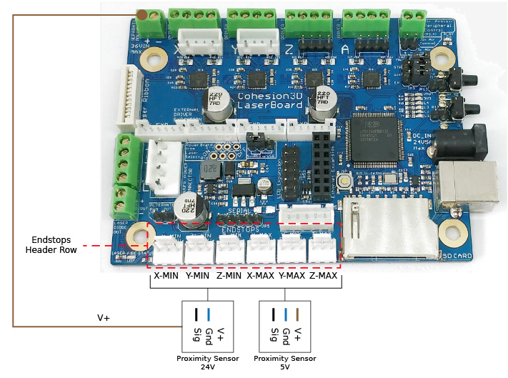

But it appears there’s no problem using the 10-36V inductive endstops with the C3D but they just need 24V which they can get off the wire terminal since it seems to be wired to the same 24V input of the C3D power supply.

The versions we have seen of these types of proximity sensors have been connected to the 24V on the LPSU. Disconnect from the power supply / stock board and connect +V (Brown) to Separate Power IN + in the upper left corner of the board, then 0V (Blue) to Gnd, and Out / Output / Load (Black) to Sig for each respective axis. See Proximity Sensor 24V in the left example of the Endstops Header Row image above. Note that there is no connection for the V+ pin on the right.

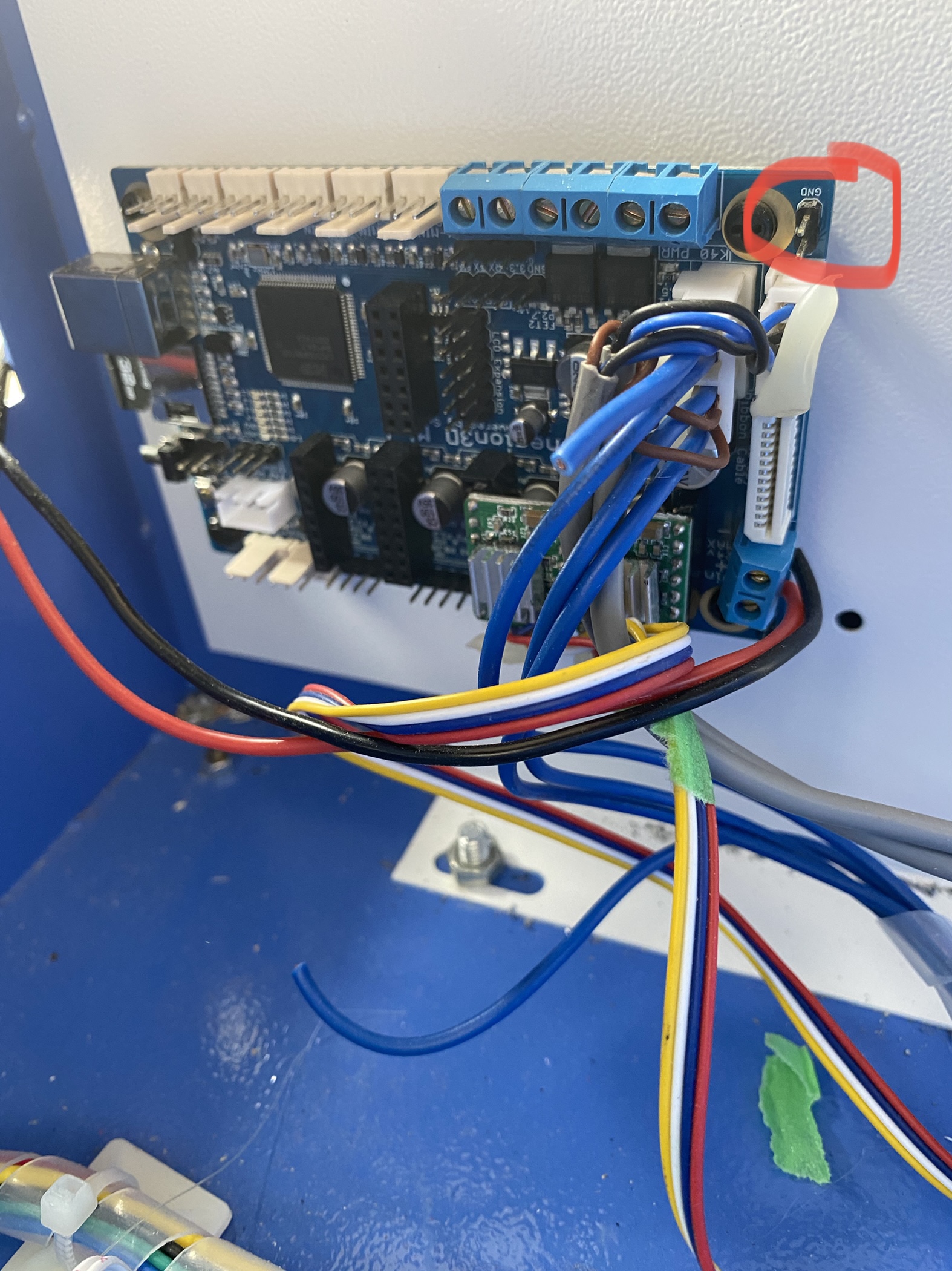

Where is power in? How do I know what the upper left corner is? The board in the photo on that link is not a mini, so it is a bit different and therefore confuses me.
For the ground, am I attaching to this red circled pin?

that section shows a picture and if you look at where the wire drawn in and labeled V+ goes you can see VIN on the board and the connection indicated to the + side of the connector instead of - side.

So I got 0v no matter what when I used the DMM. I even used paper clips to make sure I was touch metal with my probes
so there you have it and as suspected, how-ever the endstop connector is jammed into that socket, it is not working.

Regardless, that was not the way to connect these end stops so you should wire it as the documentation states to wire it and go from there. I’ll spell it out:
connect BOTH sensors Brown(20-30VDC) wires to the 24V + wire terminal which it looks like you are supplying 24V to the C3D board from an external power supply. If you want, you can also connect both of the Blue(0V) to the 24V - wire terminal and then you just connect each of the Black wires to the proper X-Min Sig and Y-Max Sig pins on the C3D. I think that’s what the document says for the configuration file.
