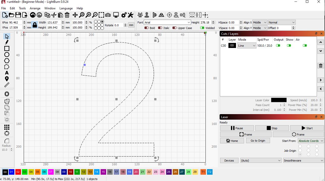

The problem comes when I draw a giant letter “2” 200mm height x 131mm wide. I place it in the center of the work screen. When I do this, the laser then goes off the rails and does this:
The laser doesn’t appear to make a 2 at all.

Where I am referring to the machine only framing “half of the work area” this is what I mean. In this image you can see that I have drawn up the # “2” in the middle of my work space. I am using absolute coordinates. As far as I am aware, it should print that #2 where I have placed it.
When I ask the machine to “frame” the area, it does this and only frames half of the machine. It should be framing the middle of the work area should it not?

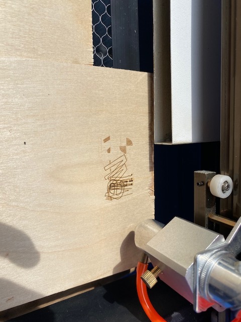

  1. When I start a job sometimes the machine randomly goes to a completely different location. For example, I wanted to do some test burns for a dog tag I would like to make my new puppy. I ran the word MILA in the middle of my work space. The K40 goes to the bottom right and writes MILA with all the letters on top of one another (See first photo below). Without adjusting anything, I hit the start button again. This time the K40 goes to the top right and spells MILA out properly. I made no adjustments, I didn’t touch the program or the work piece.
I have coordinates set to absolute. Why is it randomly going where ever it wants?
Same thing when I went to do a dog tag, I did it on the wood first in one spot to give me a reference point. Slid a dog tag over top of the wood in the same spot, the k40 decides it wants to go somewhere else entirely. I can’t reliably fire my laser in the same spot to do repeat jobs.

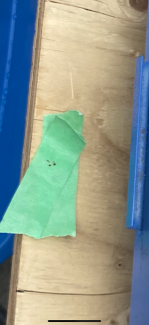

  2. I was doing my laser alignment. I think I have it setup pretty good for the most part but I want to tweak things a bit more after running a few more tests at the end of today. I am seeing 3 dots come from my laser tube to the first mirror at every push of the button. Am I in TEM-01? with a dying laser? I tried doing 3 passes at 10ma and 20mm/s and I am only scratching the surface of 5mm plywood. It burns in images, but nothing crazy and I can’t see this cutting anything. I also am not ruling out it being a focusing issue.
The guy I bought it from included a new laser tube, so I am thinking it may have been on its way out…
Without a picture of the dots it is hard to speculate exactly which mode, but unlikely to be in TEM00 any more. So yes, tubes don’t spontaneously return to TEM00; it’s on its way out.
This is what I am seeing off the first mirror directly from the laser.
