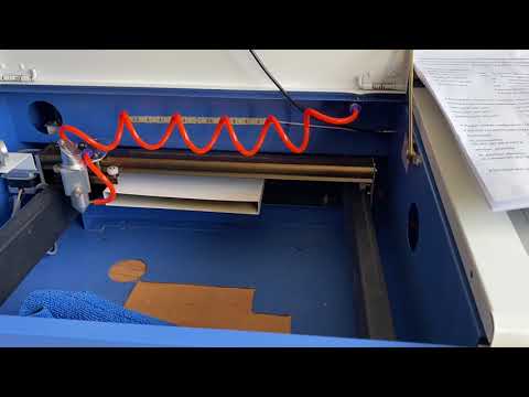

At first I was excited as it appeared it may be working. The first few points I told the machine to move with the laser point in lightburn the machine listened. After that it stopped responding where I told it to go. Here is a video of what it is doing here:
For the record you are seeing the video as I call the laser positions. Upper left is upper left of the screen. It starts out great, then goes haywire.
When I hit “home” the laser head moves only a few inches and stops.
