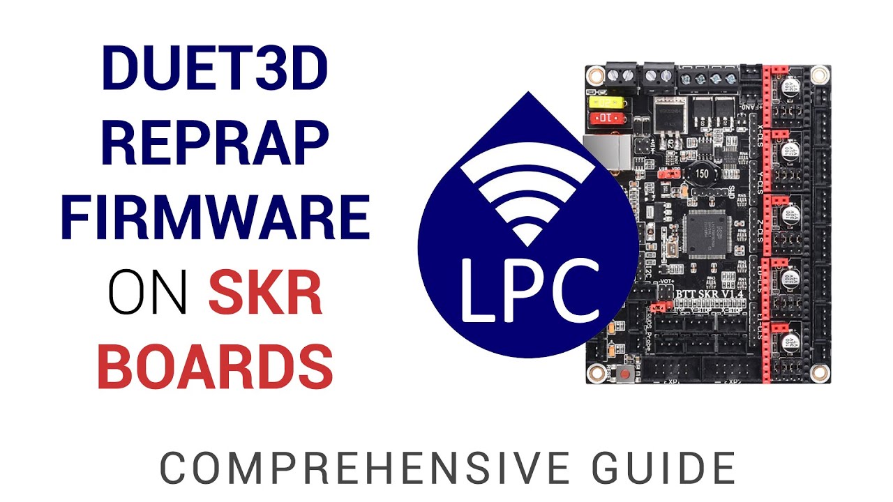

Hmm, I knew RRF was around but never gave it much thought since I’ve really not run into anyone saying much about it. Until now. It does indeed look interesting and I do have a bunch of LPC based boards like the SKR v1.4 turbo. My Ender3 needs some help so maybe I’ll give it a try:
I’m also looking to do a K40 upgrade to the X axis(400mm linear rail) and 2nd Y axis(300mm linear rail) and an acrylic version of his lightweight laser head. So maybe after that I should try RRF on the K40 and see what it can do with TMS2209 drivers and the stock motors.
