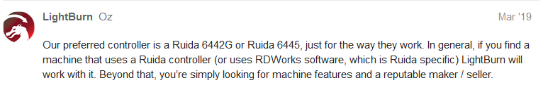

For approximately $300USD you get an industrial controller that runs either the free RDWorks software or the new industry standard LightBurn software which is inexpensive, feature rich, and under active development with fantastic support.
From the LightBurn forum and the owner of LightBurn:

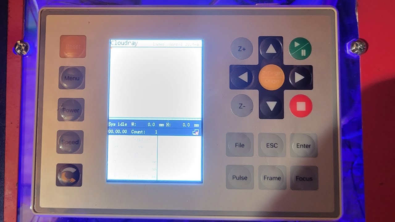

The 6432 has no indicators, whereas the 6442/5 have 13 of them with input status and other information that you can see…

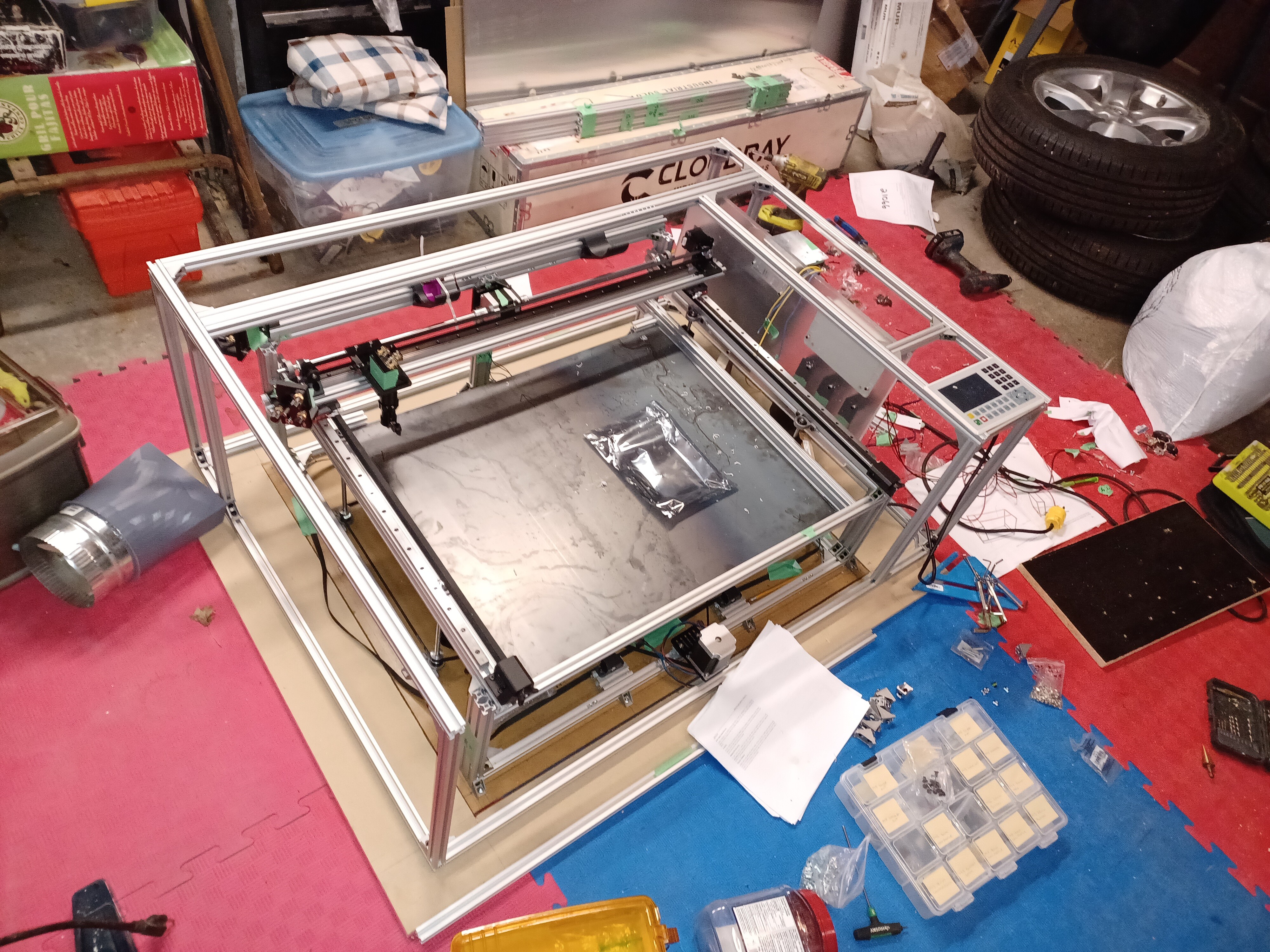

I’ve been using a 50k Chinese laser with a Ruida 6442 controller and currently finishing off my own Further Fabrication build, 700mm x 600mm, with a Reci W1 75w laser and Ruida 6445 controller.
