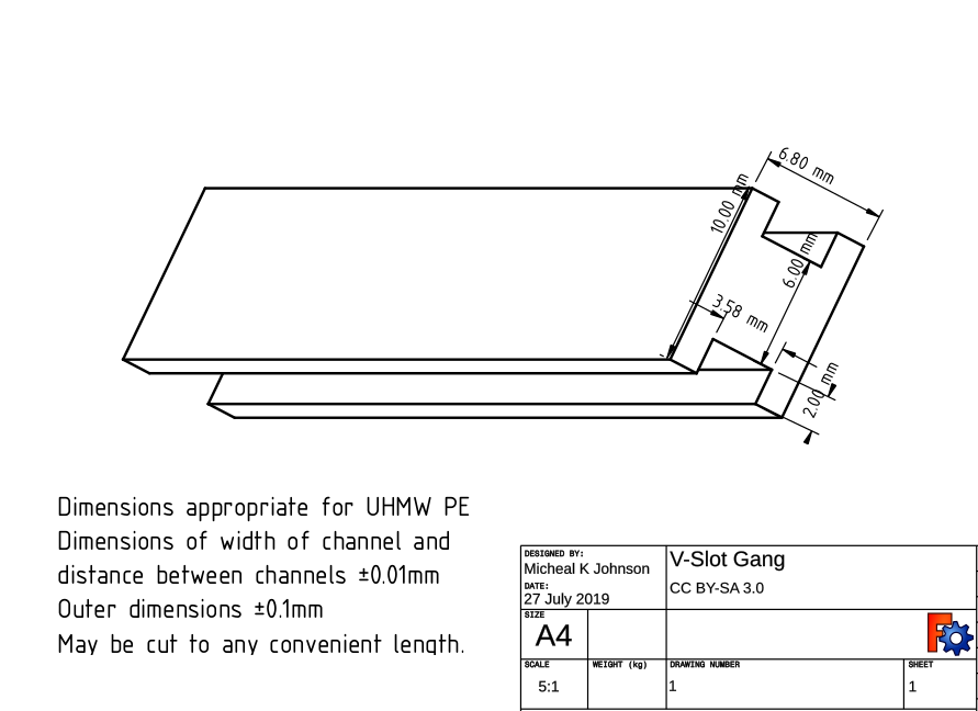

The face of v-slot is 1.8mm thick, and the slot is 6.25mm. The inside measurement inside the channel is 11mm.
I have some UHMW PE blocks. I could cut 6.8mm x 10mm blocks, and cut a slightly-less-than 3.6mm wide channel 1.875mm deep in the middle of the 6.8mm face on each side, to make precision-milled plastic i-beam-shaped aligning joiners. I would have to experiment with the width, but once I get it right, I could mill out a long section and slice it into pieces.

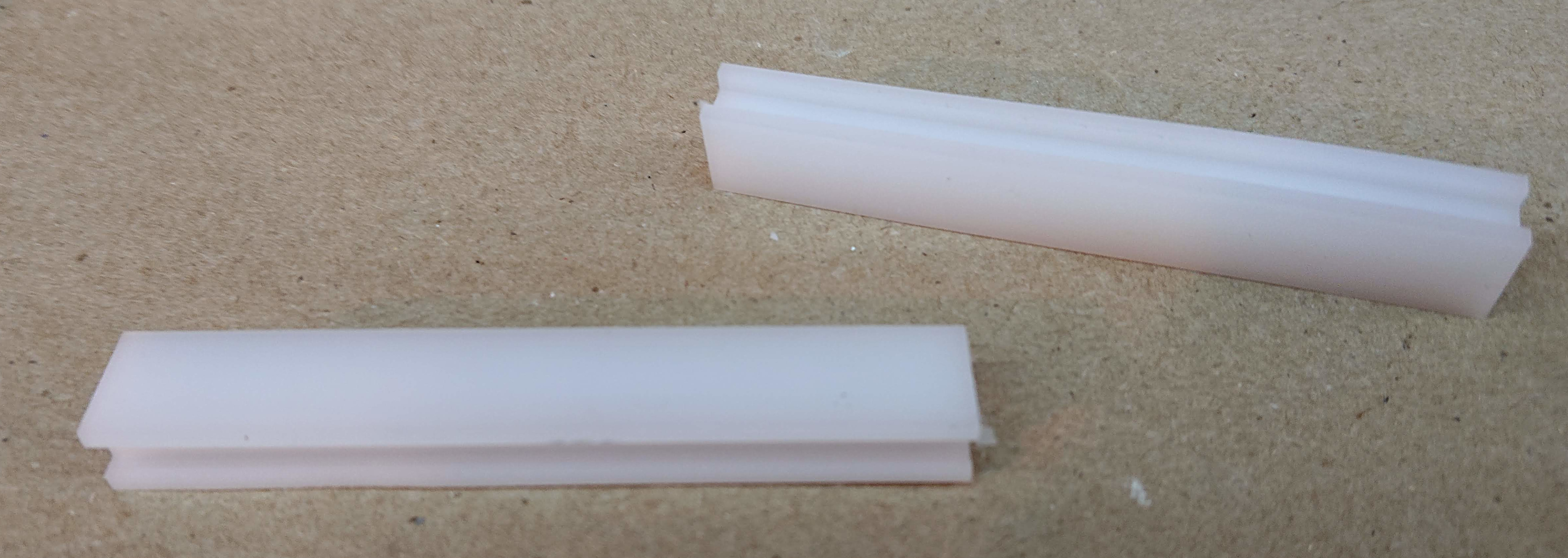

I made some of these and used them to join the two 20x60 beams for my OX. I forgot the “slightly-less-than” part and cut the slot to 3.6mm wide and 1.87mm deep, and I didn’t have enough preload. I think 3.55mm wide next time and 1.85mm deep to set some preload in both dimensions would make sense. The preload adjustment probably depends on what plastic I used.
I snipped them into small pieces about 1 cm long and slid them in.

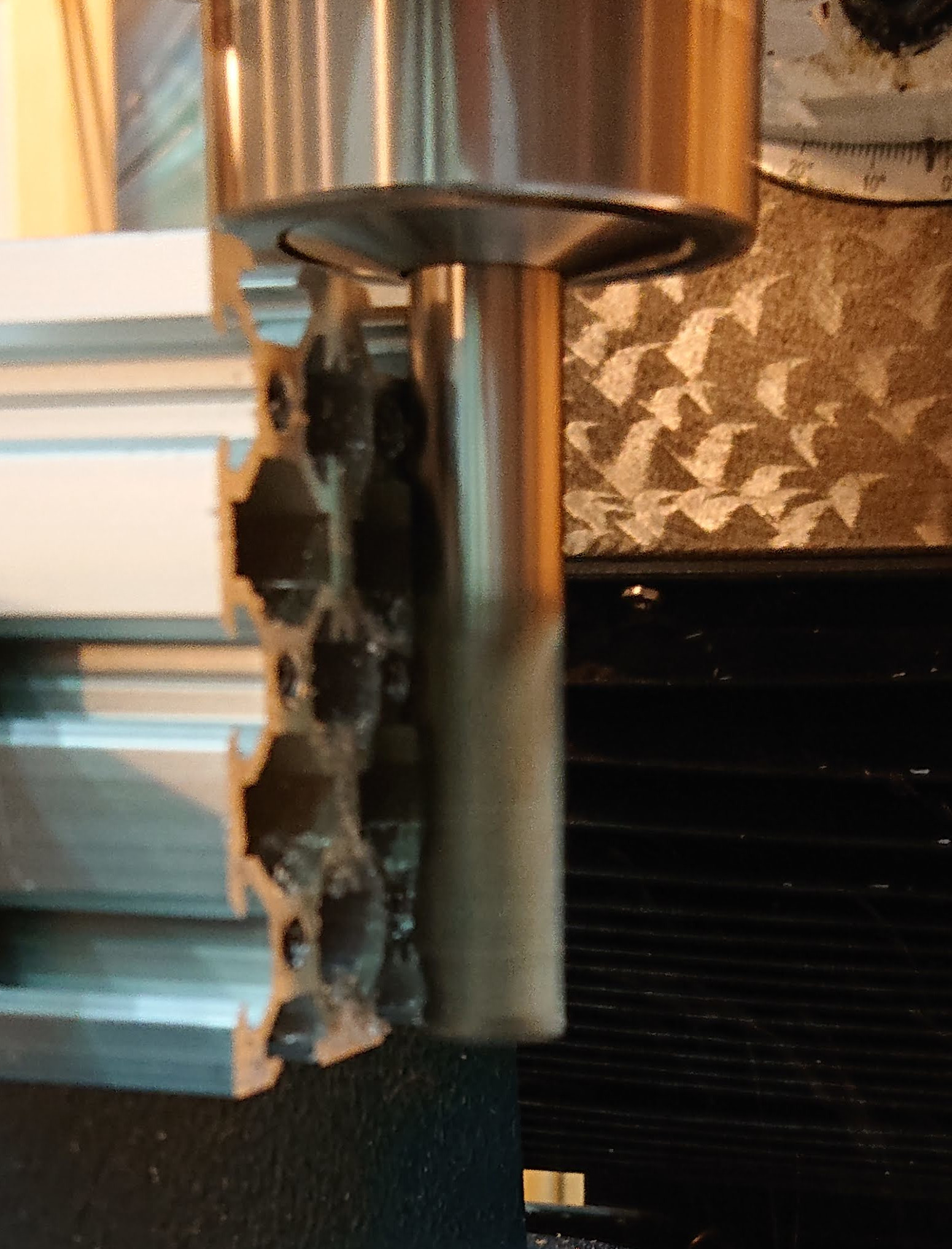

When it comes to milling long sections, I really can’t do sections much longer than what fit in my vice jaws. I roughed them off small blocks with a slitting saw, then faced them to outside dimensions with an insert face mill with ground inserts (same as I would use for aluminum), found the center, and then used a 3mm 4 flute end mill (it’s what I have, 2 flute would be better) in two passes to cut the slots.
It’s important to move reasonably fast in plastic or it will melt. Even with the sharp ground inserts, I got a little melting on the outside before I sped up the feed.
The outside dimensions aren’t super critical. They could probably be off by as much as half a millimeter. But the slot dimensions need to be fairly exact, and critical measurement for the depth of the slot is that the waist is 6.1mm wide, or maybe 6.2; that’s what I’ll really need to adjust to get preload right.
I redid the pieces because I had to take the gantry apart anyway. It wasn’t square because the v-slot wasn’t cut precisely square and were different in length by about 1.5mm. I ganged, squared, and matched all three. This is much better. Clearing 60mm was a little tricky, but clearance is clearance!
After experimenting, I made the waist exactly 6mm thick, and with a 3mm endmill I cut .29 off center twice for a total of 3.58mm wide slot. This fits firmly enough that it’s hard to move, but isn’t impossible to insert.
@Mark_Carew_OpenBuild If this looks interesting, please feel free to use it for an openbuilds part, including asking me for a different license. It’s hardly worth a license; it’s just the result of experimentation with different dimensions in UHMW PE and it feels so obvious to me that I expected it to already exist. I haven’t tried making it from acetal; probably the dimensions would be different there to get the right preload.
At the very least, it made assembling my OX gantry easier.
