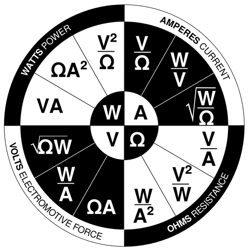

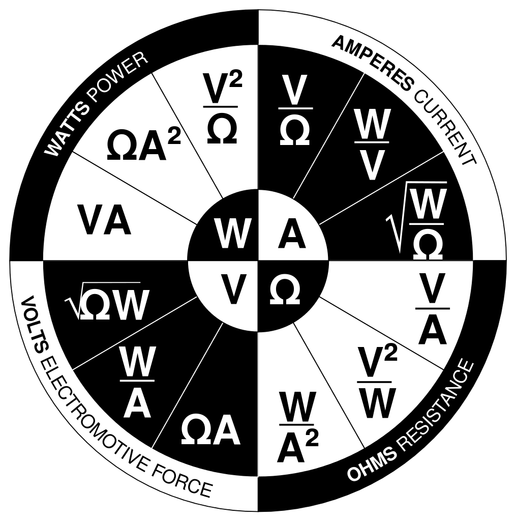

My element has a room temperature resistance of about 1 ohm, and a resistance of 1.15 Ohm at its maximum temperature (1600C) TCR is 5 PPM/C ± 2% from 25 to 1600 C.
At 1600C the head uses about 65 Watts of power, at 15 V, ~4.2 A. I believe this should be safe to use on the MOSFETS as designed?

OK, where am I going wrong?
15V/1.15Ω = 13A
15V² / 1.15Ω = 194W
I picked a hall effect sensor for ease of implementation, and the sparkfun item in particular, due to its current rating being high enough for what I need and its resolution being the minimum I can accept.
